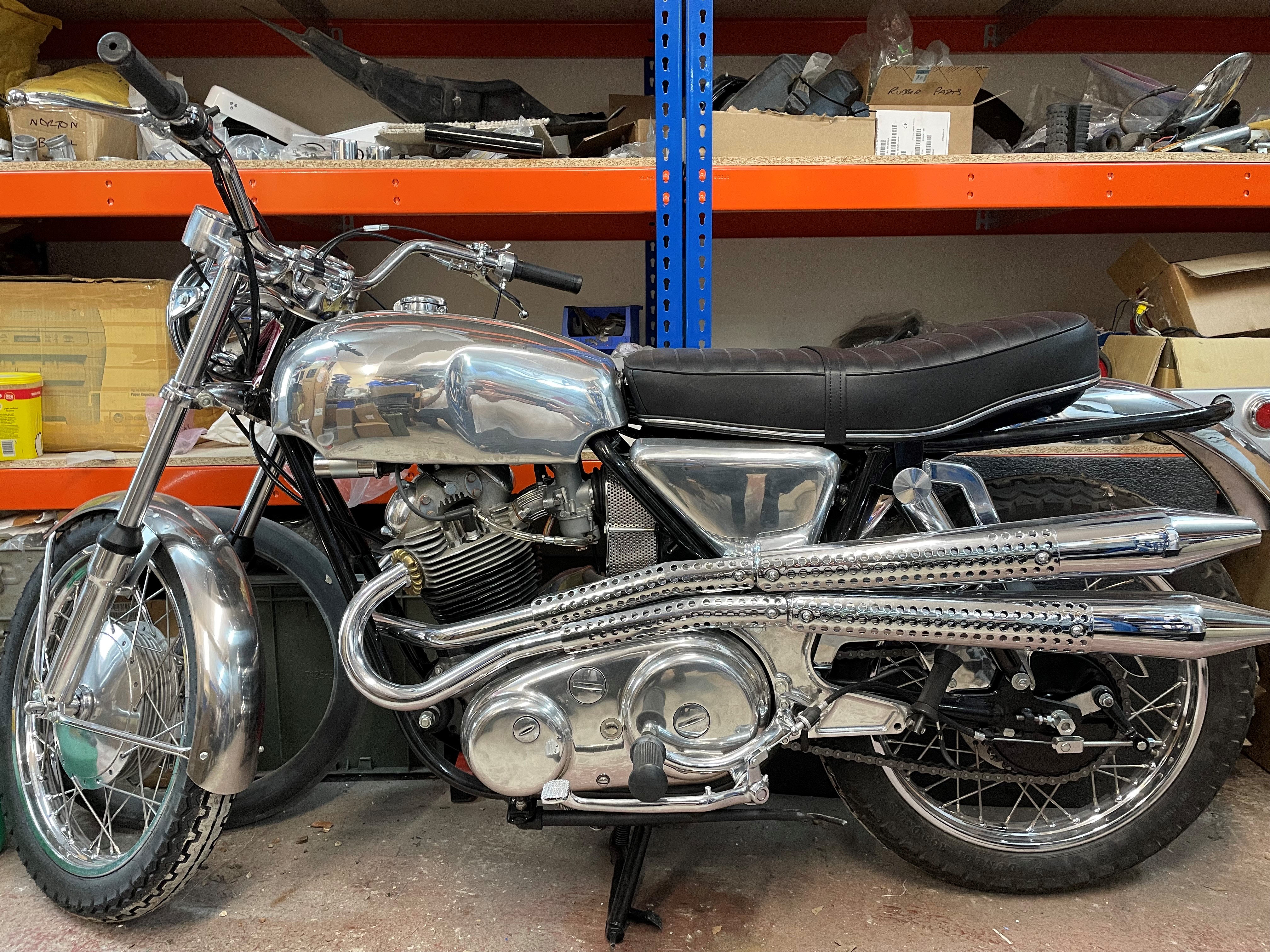

I've been doing too much reading and not enough actual work (i like to call it research) prior to embarking on 2 x commando projects (my current matching numbers 750 S is just about finished, picture attached)
