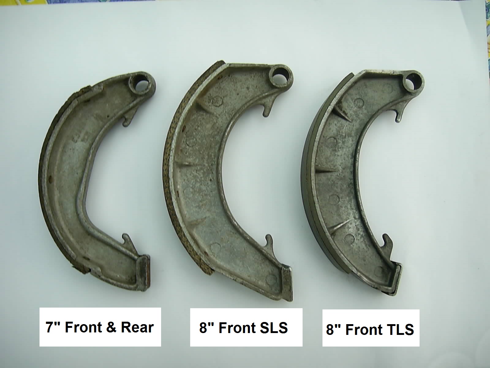

I have been keeping my eye out for some spare shoes to get relined and ready for a quick swop. Both types SLS and TLS . Have been concerned at the variety and lack of conformity in the pictures and descriptions of the items for sale . Is there any pictorial information availiable that shows the variety of shoes availiable ?.

I recently bought a pair of 7" from Russells, in a modern Ferodo box labelled Commando. They are as Phil shows here, and the same as prewar singles. The scooped out recess on the inside edge is to give clearance for the prewar speedo gear inside the drum. So it looks hard to go wrong with the 7" size, although some retailers web site pictures show shoes without the inner clearance.

Pre-war shoes
Pre-war, and early-war WD16H only had the speedo drive cutaway on the single shoe in the front hub where it was needed. The others were 'complete'....The change to just the cutaway type seems to have been a wartime economy. Some of the wartime shoes were a higher-zinc alloy and I've seen them cracked at the narrow point.
In terms of braking efficiency, it would probably be better not to have the cutaway at all.
Original equipment woven asbestos linings work tolerably well (at 16H performance anyway). Unfortunately, the the 1970s 'Classic Bike' / Alan Cathcart obsession with fitting hard / green / AM4 linings in order to 'make the brakes work' has led to most modern suppliers continuing to use media that are far too hard for normal, sensible road use.

Styles of the early rear type may vary. A version of this 7" was also used on the Model 7 front for a few years.
See attachment which covers post 1948 Norton Twins plus many singles.
