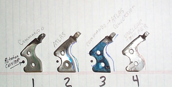

Hi George, I've found a drawing that may help to explain the difference between the levers.
Not that professional, just a basic view...
Best regards, Harry

As Robert said plus that some grease so that the nipple on the lever end of the wire can rotate easily in the lever. Also check so that a previous owner had not put a clutch operating lever from a Commando in the gearbox. They are different from the ones used in the 650SS. The Commando type clutch needs a longer stroke and less force to work as intended. The reduction in force needed with a shorter fulcrum to nipple distance of course also means lesser lift. So the things mentioned by Robert will reduce risk of a dragging clutch. And as usual, routing of the clutch cable can make a huge difference.

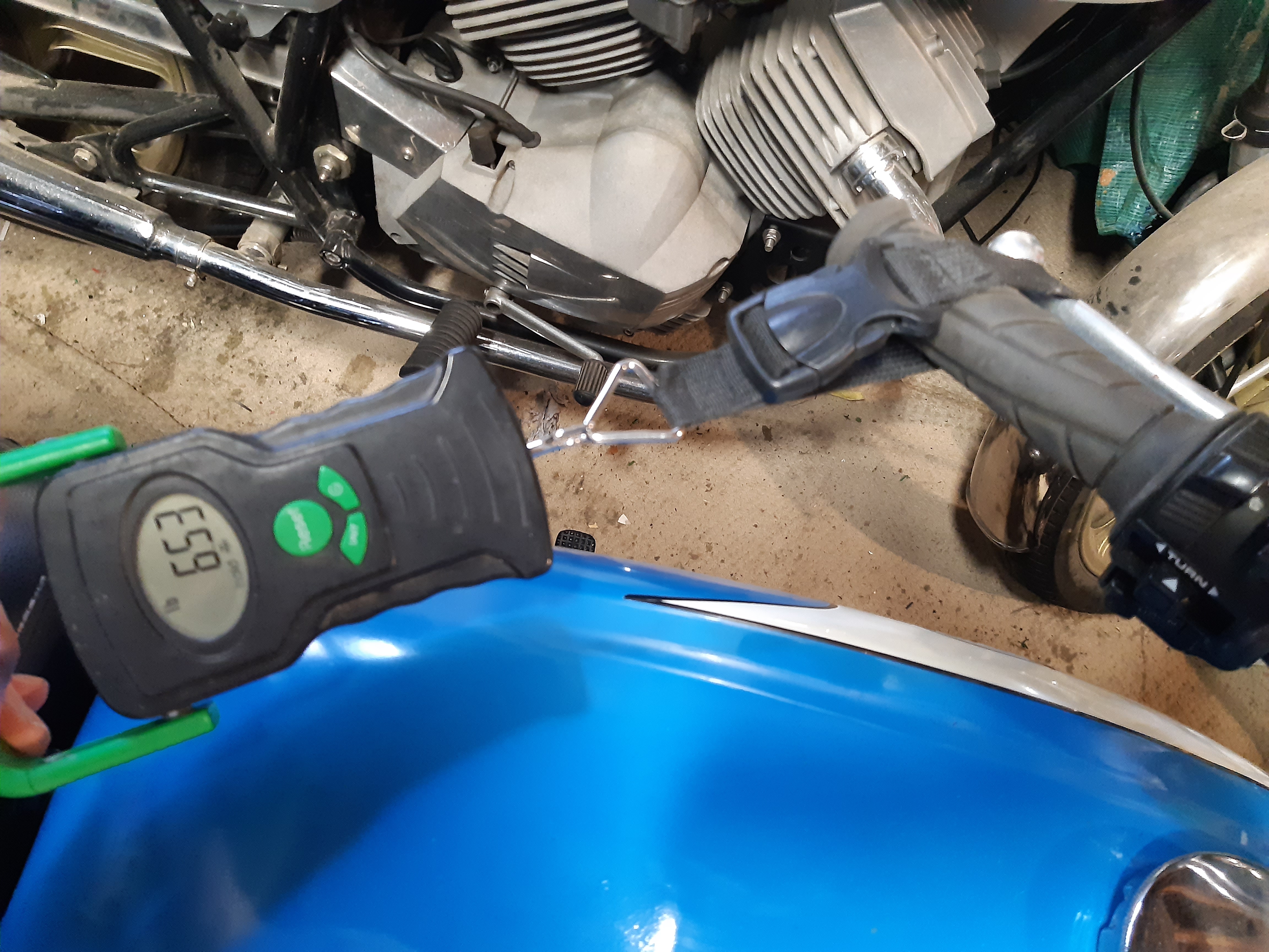

I just measured mine with a luggage scale on the clutch lever and it requires around 9-10 lbs to pull it in, and 6.5lbs to hold it there. My lever is a 7/8" one, 5.5" long to the ball end. Feels ok and normal when I ride it. Maybe I have a strong grip?

Have no idea how that compares with other Nortons, but as a contrast it is 50% greater than my Morini needs and over 100% greater than the modern 650 Enfield.
