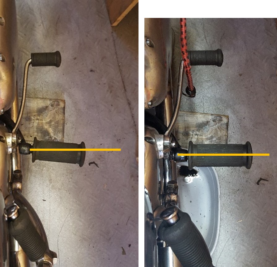

The r/h side footrest on my 650SS was bent when I got it (low-speed off I reckon) and I left it for ages before deciding to have a go at straightening it. You really do need to get the arm red-hot. I thought mine was hot enough, but when I tried to bend it out, the threaded part of the peg snapped off. Luckily I was able to get the stub out with an Eezi-out and then I drilled the peg and tapped it 10mm so that it would bolt back in place. £100 with VAT and P&P was too steep for originality.
Straightened footrest
Good luck!
Hi Kevin. That’s a really nice job. My footrest is bent down and back so it needs aligning in two planes. I’m going to take it to a local blacksmith so that it can be heated to the correct temperature. I really dontwant to risk doing it myself. I think that I might need to make a jig out of wood so that the blacksmith can check that it’s got to the right shape in relation to the serrated fixing boss.
