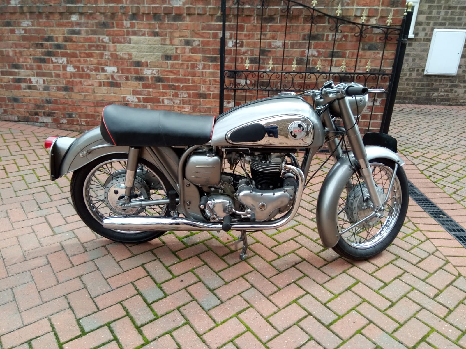

Took the bike out for its first ride today after 49 years and 354 days since the con rod came through the crankcase, only about 3/4 of a mile as a trier, but all the waiting was worth it in the end. My school reports always said "could do better".

Many thanks for the compliments, I bought it in 1962 and also thought it was the best looking bike of all time and still holds it’s own.
The clock on the handlebars is a Mungo oil pressure gauge, I looked everywhere for a small dial clock and when I found this one it comes complete as a kit with bracket pipe and adapter to fit into the blanking bolt just under the pressure relief valve. It was designed to fit through the rocker feed banjo on later models so I turned a small aluminium spacer to make up the gap. If anyone purchases the kit check the handlebar clamp screw length, I had to shorten mine as it would have cracked the glass on the gauge. I haven’t fitted an anti-dumping valve yet until I see how it goes but thought a pressure gauge better than a mechanical valve with my memory.

A very nice bike,if thats your first restoration ,I'm impressed. I looked hard to see anything I would alter (sad old nit picker!) ,  The short gear lever would be no use to my size 10's , I would make up some bar risers to use with those flat bars to ease the cable runs. I prefer the earlier silencers which have a bit more  of the old style.  And I would not be keen to show pictures for old gits to nit pick!!.
Hi Robert,
I never had any problems with the gear lever and mine are size 13’s, agree about the cable runs but that is how it was from 1962 when I got it. The original silencer rusted through in late 62 and on an apprentices wage I couldn’t afford a new one so just made a straight through megga with steel wool outside the perforated pipe, it worked well and still sounds great but the steel wool has rusted away, If you mean the teardrop silencer it was more stylish but 1957 was the start of the new shape along with tank panels etc. It was first registered on the 3rd January 1957 so must be one of the earliest of the new model. Similarly with the handlebars but at 6’-3” they are very comfortable.

Very nice indeed - well done ! I have a 1956 Model 99 in bits that I am about to begin . Your tank looks bigger -almost like an International tank . Is it just the camera angle ?

Very nice indeed and a lot cheaper than mine, I wrapped all the frame in foam central heating insulation and it saved a lot of the possible damage. Putting the engine in caught the inside of the frame just under the timing cover but touched it up fine. Only people I run over will ever see it.
