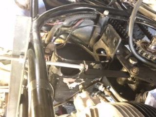

Featherbed centre stand spring fitting with no effort
Made a hook from flat plate slipped over spring stud and piece of studding through a plate over top rails and just wound a nut down, stud slipped straight through hole in engine plate simples! Filed two flats on stud to get a spanner on when doing up nut
