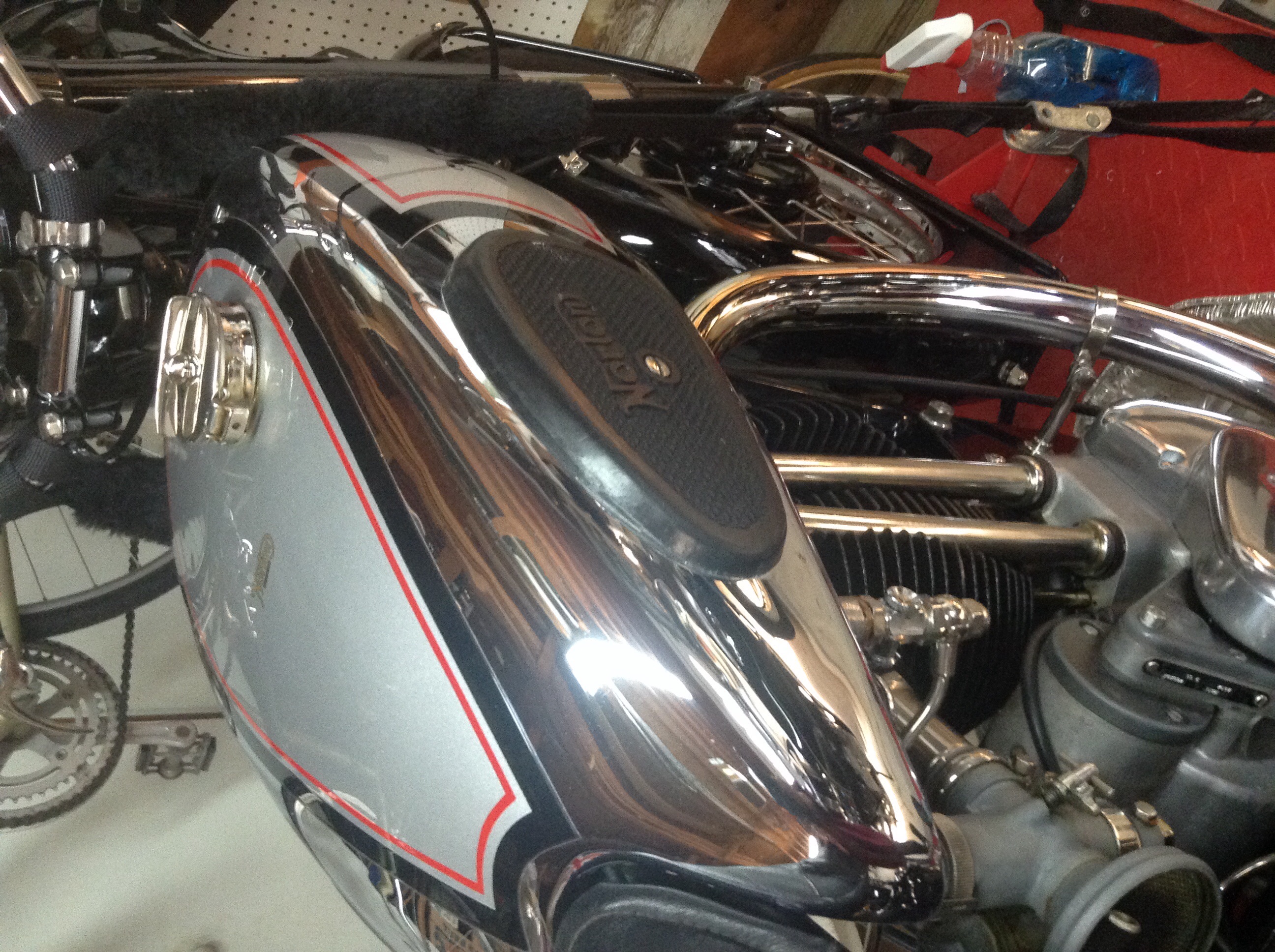

I have just ordered some new tank grips for my 1949 ES2, the originals had a metal plate inside making them keep their shape, the new ones are rubber and do not stay to the same shape of the tank when the single bolt is secured. Has anyone else fitted these and what have you used to secure them to the tank. Many thanks

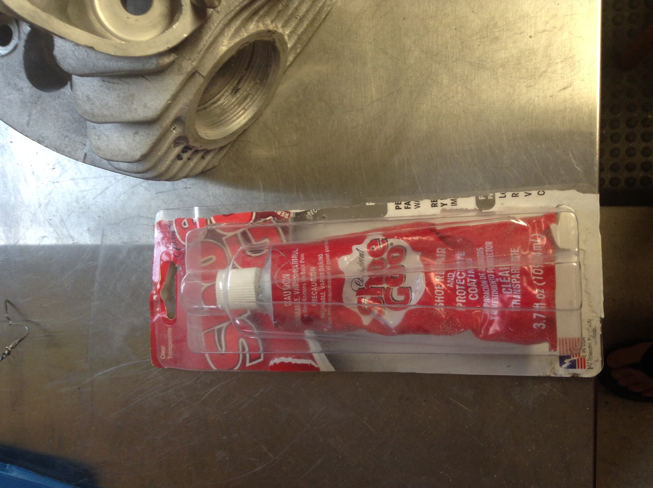

I had the same problem. You might try immersion in very hot water then fasten with the screw and tape the rest to shape overnight.
The only thing I found that worked for an adhesive is a product called " Shoe Goo " -  meant for refastening soles on shoes . You must be certain to clean the grips to remove any mold release agent and clean the corresponding surface of the tank to remove any wax and oil . Also scuff up the back of grips with coarse sandpaper.
Using this method mine have stayed put for many years now.
Hope this helps - Richard

My 1938 ES2 has plates. These were new old stock and fit really well just using the single screw. I tried the ones without but was not satisfied with the fit or security.
