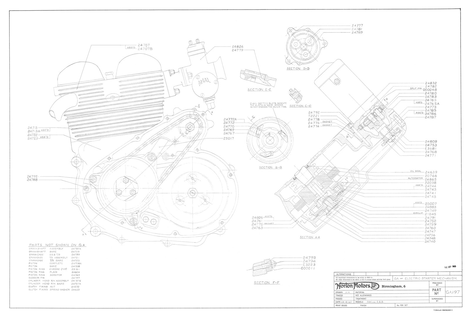

Electra starter mechanism drawing and parts list.
Does this help? pdf of pages 87-88 of the electra manual. Plus drawing.
Thanks Tony, that's exactly…
Thanks Tony, that's exactly what I needed.
Mike, the part numbers I need are 25017, 24772 x 3, 24770 x3, 24769 x3.
Cheers, Stew

I have an Electra almost in working order, almost as although the starter turns IF we have a decent battery, the engine/sprag doesn't always catch hey ho.
So If you get some bits I can advise on some of the units failings, and fixits. I don't know what you mean by the ratchet nor cover plate. The motor is bolted via a set of sun/planet gears to the primary case back plate. There is a chain and tensioner and the sprag is built in to an assembly that sits astride the crank shaft. it is the sprag that seems to cause most grief.
