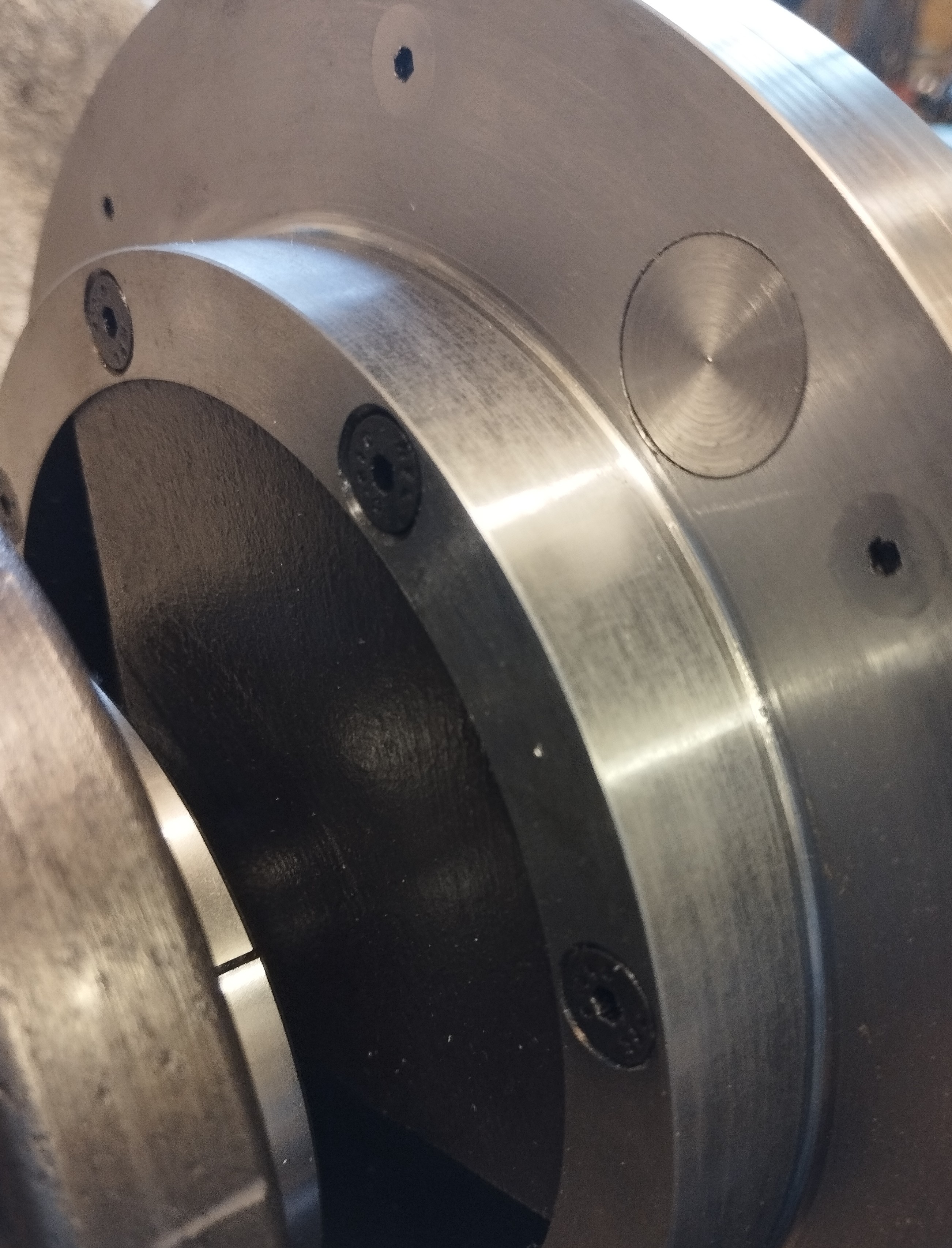

One more thing, I believe the Electra flywheel width was reduced to fit between the cylinders.  I wonder why this was done?   All that was need was locally cut away the cylinders to clear the flywheel.  The cylinders aren't doing anything that area.  I think that these bikes were a bit "light on flywheel", reducing the width is a backward step.  I would fit a Navigator crank shaft and cut away the cylinders to accommodate.  I managed to get a sizeable increase in flywheel inertia on my Navigator crank shaft, photo teaser attached.  I plan to write about this for "Roadholder" sometime.
