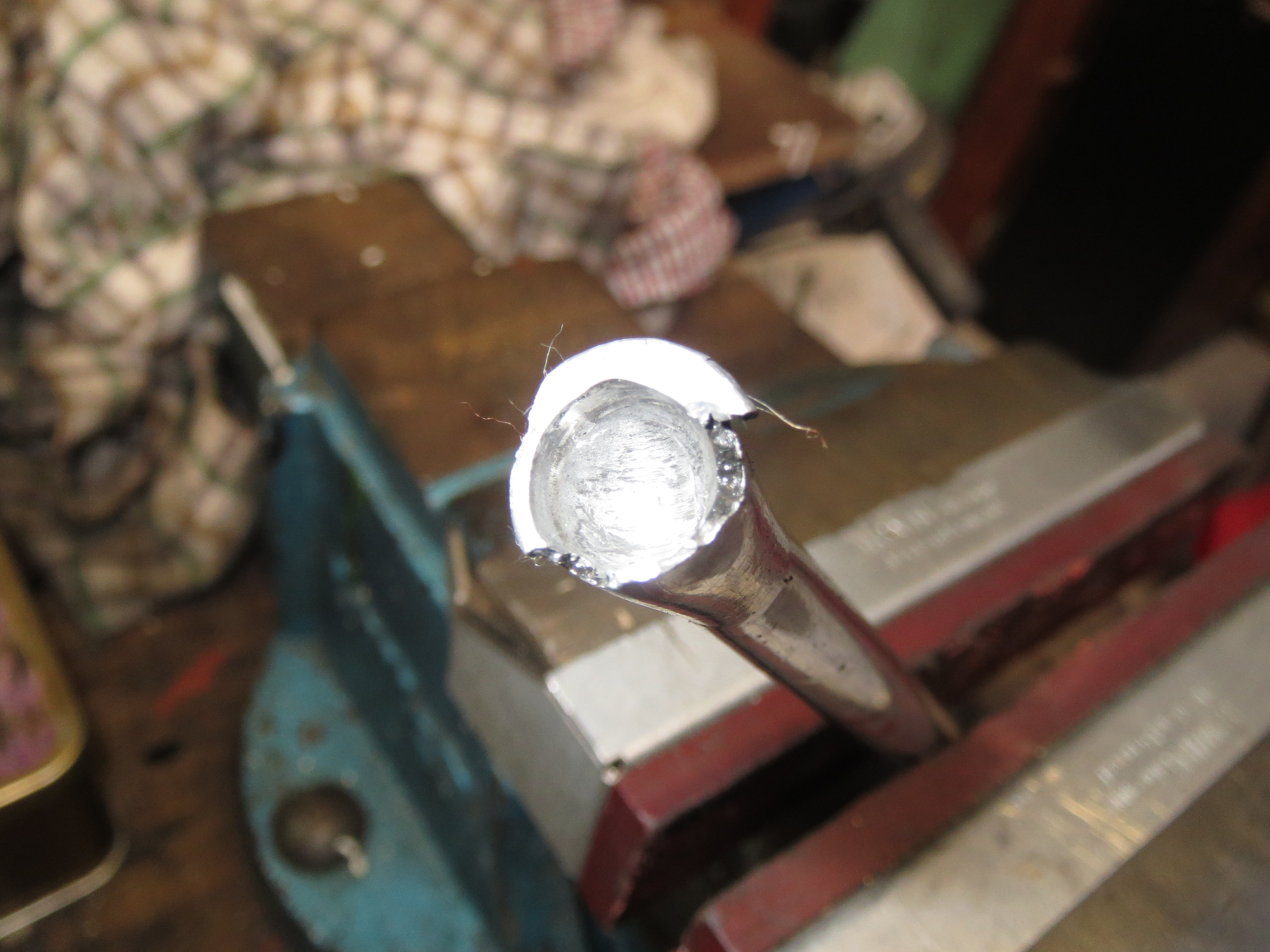

Bike is a 1959 Dommi '99'. I bought this in the summer as a fully rebuilt working machine. When attempting to adjust the tappets I couldn't get the valve clearances adjusted correctly so I bought a new set of tappets. In trying to fit these it became apparent that the locking nut on the tappet would not fit above the rocker arm as it should. The tappet had to be wound so far through the rocker arm that there was no thread left for the lock nut. So, I fitted the locknut on the underside of the rocker arm. This troubled me. Why should this be necessary ? I decided to investigate so I've removed the head and barrel. This is what I've found:
All four push rods knackered. The top end of each is mutilated with bits of torn aluminium all over the place.
All four cam follower cups damaged, two beyond re using, although it may be prudent to renew all four.

1. It would appear that wrong pushrods may be part of the problem. If they were too short (as would necessitate the adjusters being as you describe) the geometry would be out, resulting in loading of the pushrod ends at a greater angle to the vertical than designed. The initial failure mechanism here will have caused wear debris from here to have dropped to the cam followers and initiated damage there that then self perpetuated.

Yes, aluminium push rods…
Yes, aluminium push rods. They appear to be all alloy. The rocker ends are demolished so difficult to know if they had iron ends !

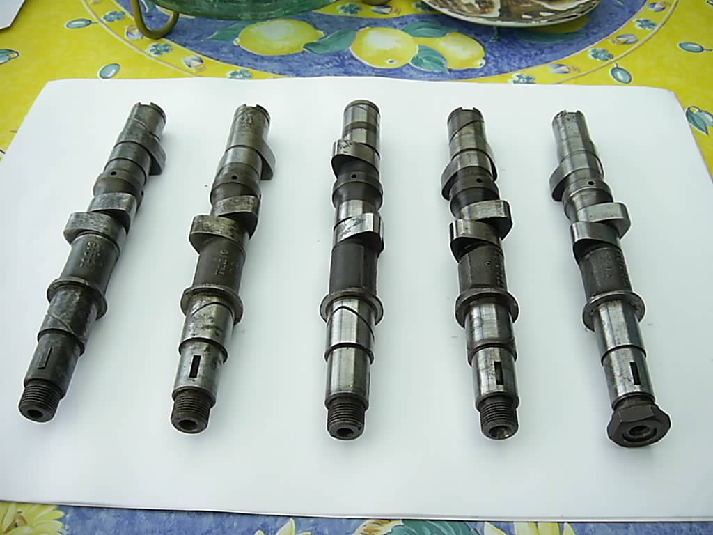

Dominator Camshafts
The following info is taken from the unreleased Dominator Service Notes...........
There were four main camshafts produced by the Norton Factory for their standard Dominator engined bikes. All have the casting number of T2219. Those for the Model 7 engine are best avoided if the plan is to rebuild a post 1956 engine and expect a decent road performance from it. The first camshaft was right for the early ‘Iron headed’ engine, in that it helped to produce enough power without the top half over-cooking.
The later ‘Aluminium cylinder heads were able to cope with more power; especially those with the extended finning. So when the 99 engine arrived, with the ‘Daytona’ camshaft in 1956, this had extended times for valve openings, increasing the power, but also the valve train noise. The addition of a 0.010' ramp to its lobes, around 1959, to help quieten down the engine rattles. Hence the title of Q.R. camshaft. These identification letters generally being stamped onto its sidewall.
The fourth variation of the camshaft arrived with the Downdraft SS cylinder heads. (But was also fitted to the non-downdraft head used on the 99SS).
Basically it was the QR camshaft but slightly altered in profile and renamed as the SS. Most have a casting number of T2219@3. From 1960, this camshaft was a standard fitting for all the Dominator SS engines, including Atlas and Mercury. It even survived, in a modified form, to become a standard Commando part until ousted, for a while, by the arrival of the Combat 2S disaster.
The earliest SS camshafts were stamped with X1 (Bracebridge) or X2 (mostly from Woolwich). The X2 camshafts were supposed to have deeper hardening to cope with the 650 engines power but the late John Hudson claimed that the X1 version was produced with greater accuracy. Later Mercury camshafts often just have the casting number.
The SS camshaft will fit into any of the pre-1960 engines and run quite happily as long as excessive revs are avoided. Otherwise valve float can occur, especially above 6000rpm. But who (track day lads excepted) hammers an engine that much nowadays?
The attachment shows the four Dominator camshafts used in production bikes from 1949 up to 1969. The camshaft on the far right came from a very early Dunstall tuned 99. His later versions having the option of a fitted needle-roller bearing and positive oil feed.

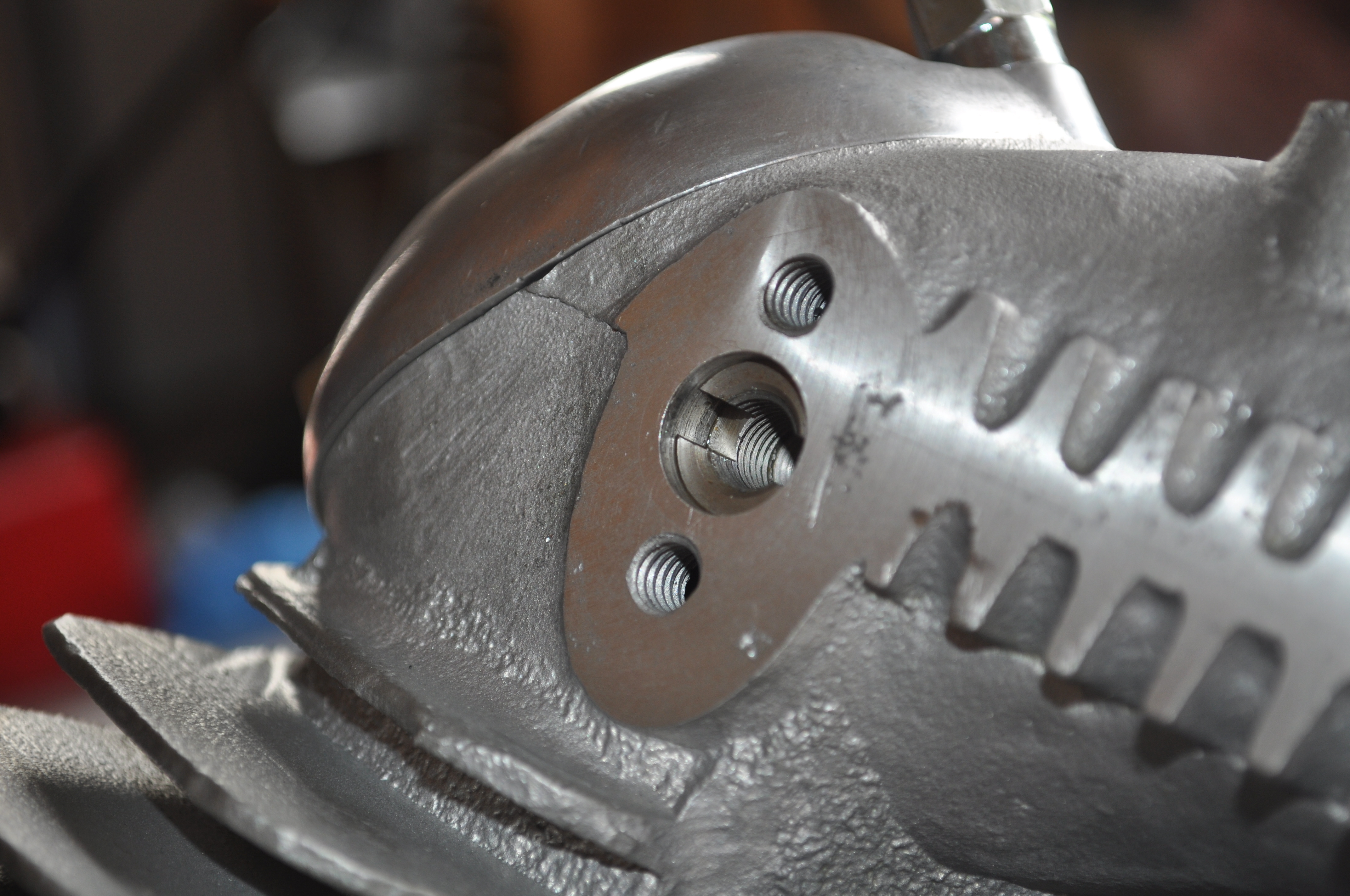

The followers rod seatings…
The followers rod seatings are indeed well hammered from careless assembly work.In the old days of no cash I would have buzzed off any crumbly bits and lapped the seating with some fine paste and a spare rod. They would most likely worked fine as long as the rods were properly seated on assembly. I'm a bit more fussy these days and would happily lightly stone some SH followers and use with the milder QR cam (also cleaned up if needed). The mild cam with oil bath on these 88/99 engines gives the parts an easier time than on many later engines.The Hemmings cam (which you don't need) is a Commando profile cam made to fit a Dommy .

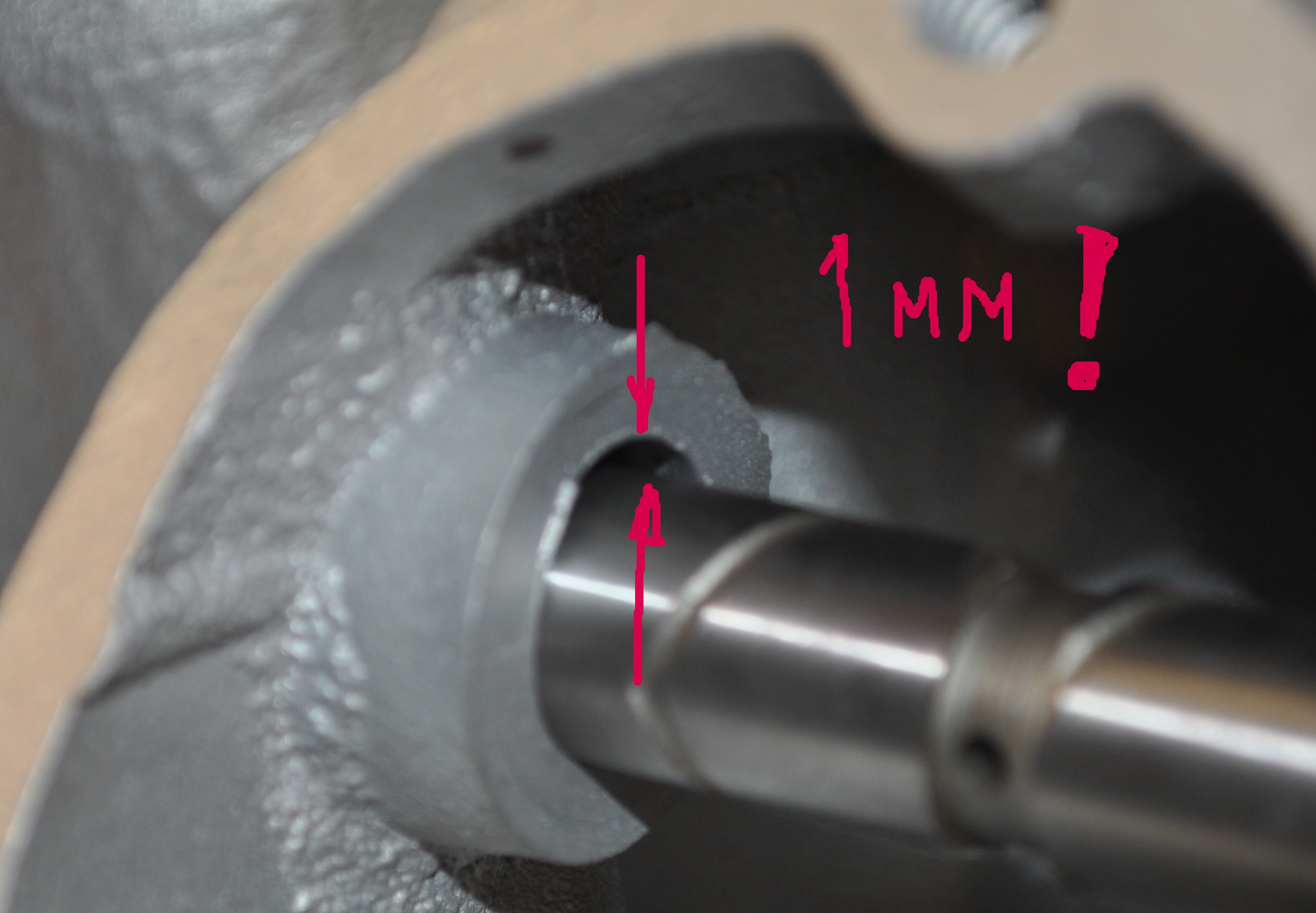

And the remaining thickness…
And the remaining thickness of the bottom barrel spigots outside the sleeves (which have already been fitted) is so small it can hardly do anything anyway. So I'd resleeve. I agree with Robert. What you do about damaged top edges of the followers is up to you. The edges don't carry much of the loads so are not all that important when running but they do retain oil and do help hold the rods in place on reassembly. New ones will look nice but will they really work better?
Can you see the condition of the cam shaft? And the important bottom faces of the followers? It does look like wrong push rod lengths. There are lots of lengths and I doubt if going by the book will help a lot. Maybe use the wrecked old ones to help measure? Did the tips of the rocker adjusters touch the rocker covers? If the adjusters were wound out as far as you say them they must have done so.

The shoulders round the…
The shoulders round the follower rod seats also help retain the rods in the advent of valve float,the odd missed gear can happen when you are chasing that Fireblade!.

I've read on this site about all-alloy pushrods, and now I've seen photos of damaged ones. Are these common? Mine are alloy tubes with steel end caps. Surely much superior? I assumed they are standard because when I bought one some years ago, it also had the steel caps.
Alloy with steel end caps ,…
Alloy with steel end caps , Normal.

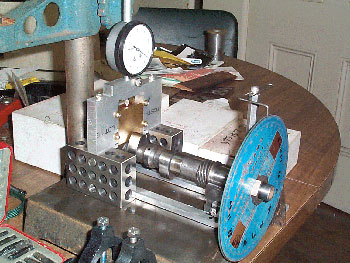

You could try a dial gauge…
You could try a dial gauge with the rod down the tappet holes. Check the lift against 'dyno dave's Atlantic green' web site says. You won't get an accurate profile but should get the lift. Don't despair. For push rods you could start with what you have and work out how much shorter you need.

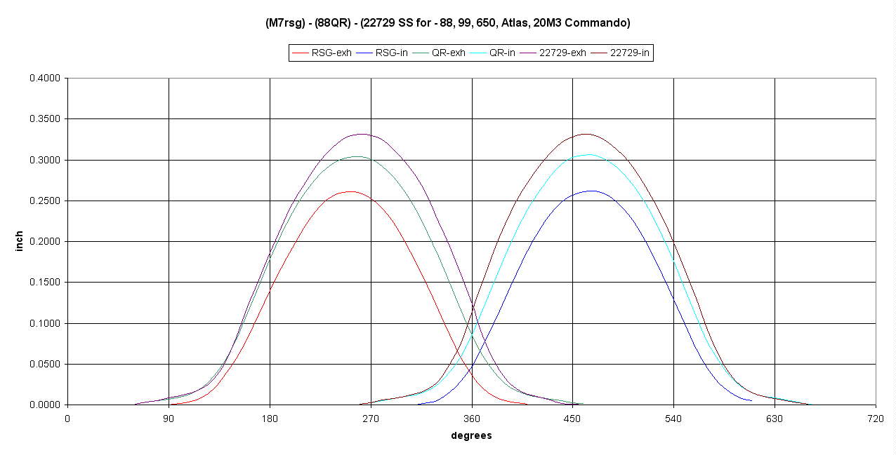

Nortons have two series of engines, twin chain ending with the 20M3, and single chain starting with 20M3S.
I show the primary series of production TC cams minus the "daytona". First two are 3" radius lifters and the 22729 is flat lifter.
This profile is better/more accurate than the one on my website. It will replace the one currently there.
Hello again Mike - If you…
Hello again Mike - If you look at the image of camshafts included in Phil Hannam's text you will see that along the camshaft just inside the bush in the timing chest there are raised up casting numbers (T2219 etc) and often as you rotate the shaft you will see extra stampings in that section that were stamped on before the hardening process. Most of the cams have the same casting numbers. A late Dommie 88 or 99 may have QR stamped on, indicating that it's a Daytona type profile with Quietening Ramps - hence the code. When the SS came out in 1961 the stamping changed to X1 and later on it became X2. So have a good butchers and look for QR, X1 or X2. If these are not present then there are other alternatives (pre-Daytona and post-SS) but please have a look first. Your Model will have had QR type from new. In the re-build all sorts could have been adopted but generally unless it was built for racing, sprinting or some such use an SS or Daytona is best. Cheers, Howard
