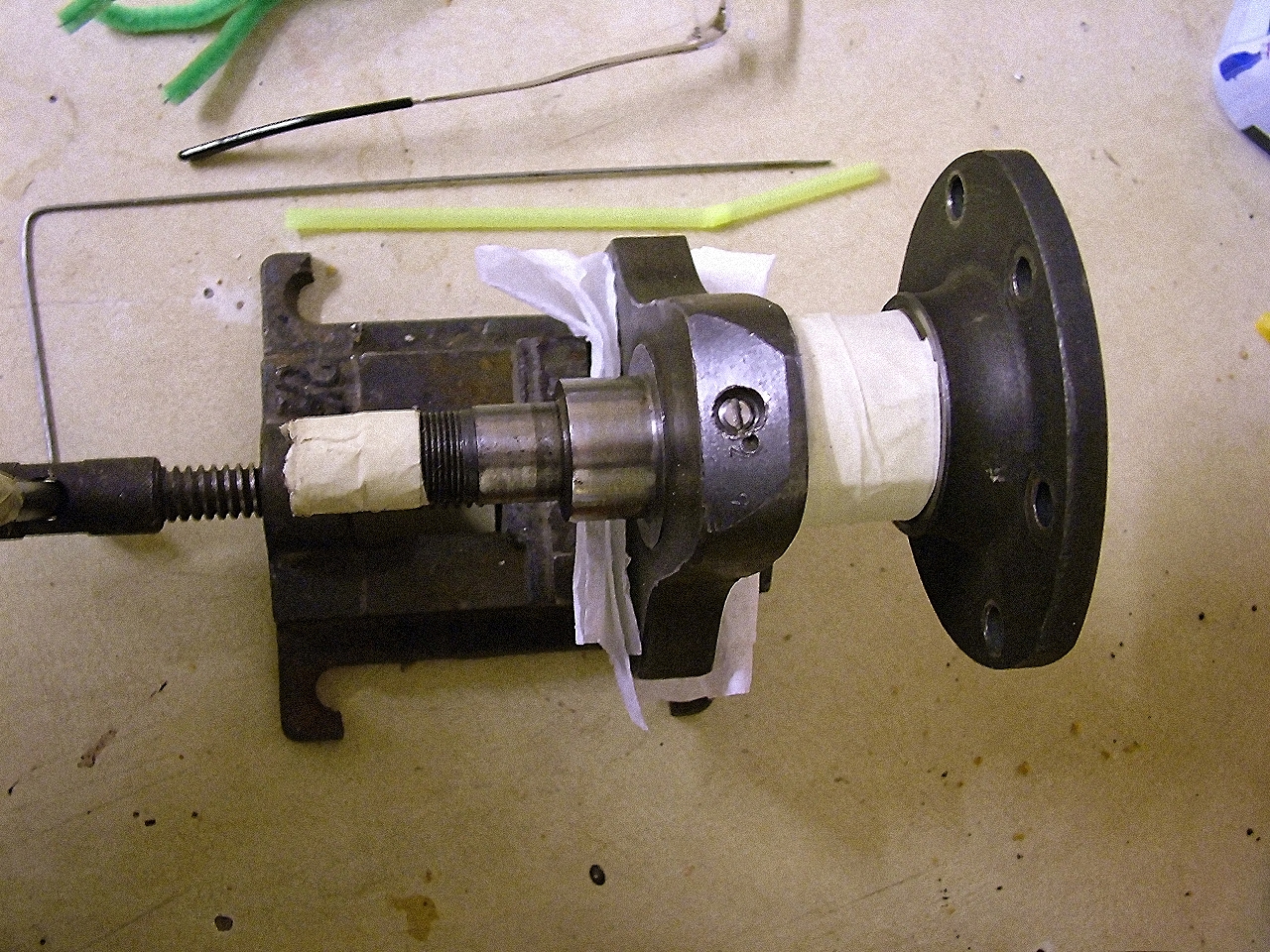

Need to know having read my Domnator service notes V1.2 manual ( Page 20) if the said `grub screw` talked about is the one shown (I think ) in the top photo ? If so the one on my crank doesn`t appear to have a screwdriver slot or an allen key head at all and it has been centre punched over. Is it essential that this comes out to properly clean the oilways ? Thanks, Wayne.
I have rebuilt several Dommy…
As the crank was taken apart…
As the crank was taken apart (by me ) to ensure the `sludge trap was clean (and it was) I can see no point in tampering . I`m guessing having flushed and blown the oilways through I`m ok ? Unless I`m looking at the wrong grub screw I can only presume there could be a small amount of `Muck ` in that small area ?

hello ,
i thought i would remove my crank grub screw .what a job i couldnt loosen it at all . it all got chewed up. so thought i would drill it out .but with it all being chewed up i couldnt make out which was the crank or which was the grub screw to drill a hole central. anyway just managed to get it right and removed what was left of it, then renewed it. personally i wouldnt bother removing it.

Grub Screw
The grub screw into the top of the crankshaft should not extend down enough to block the oilway. However it will probably have collected a small amount of debris between the bottom end of it and the Big-end oil way. The best advice is to leave it alone. Once the engine is running the centrifugal force will compact any rubbish in the drilling and stop it from wandering about the system
A torch light or Endoscope through the crankshaft flange should allow a good view of the oilway in that region.

Thanks everyone , always good to know you are there. I`m not going to temp fate by attempting to remove the said Grub screw.
I have rebuilt several Dommy engines and not removed the grub screw. If you can get it out after picking off any centerpunching and perhaps using a hammer driver it would give peace of mind to get the passage flushed through . Possibly more important if there has been mechanical breakup and loose metal fragments.
