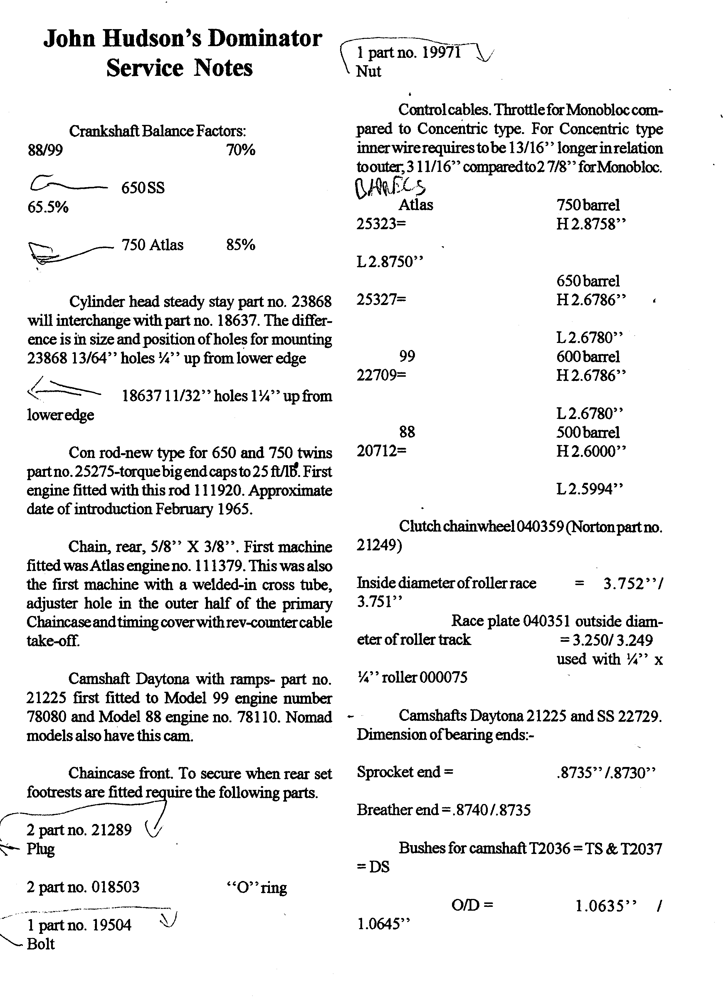

I was asked to update the fifty six odd pages of gibberish and convert them into something like the then recently published Commando Service Notes.  Please see attachments for sample pages.
After a couple of years of fiddling about, I passed them on to another member of the NOC. At that point in time there had been five other main contributors as well as myself. This included Al Osborn, John Hudson, Colin Newman, John Hudson and one other anonymous person.
I next encountered the DSNs in 2009. At an NOC Executive Committee meeting I was once again handed a bundle of sheets of paper headed DSNs and asked to something with them. This time a wiser head was able to make use of vastly superior computers and printers along with Hard Disc Drives then memory sticks, emails and world-wide contacts. A small team was assembled to help share the load but progress was still as slow. Mainly due to the original sixteen chapters expanding to 50+ and nobody knowing all the answers.
There is still the odd gap, goof and typo in the 2023 DSNs but hopefully these will be whittled  down in time and the final printed version become a worthy addition to the resources of all Norton Dominator owners.
