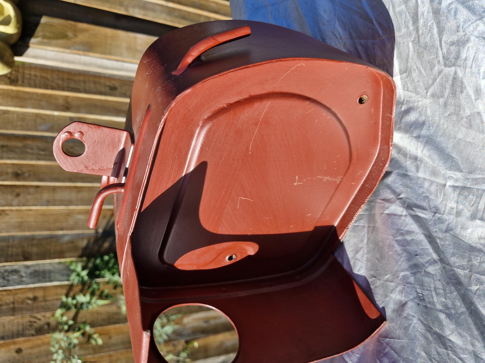

Could anybody tell me why my Dominator oil tank has got two breathers, and are they both necessary.
The top one is the input from the crankcases, via a flexible breather pipe and ....yes  - you've guessed already,  the one pointing downwards is the oil tank breather. This also connects to a flexible pipe that connects to the rear chain-case (on some Models)  or to the atmosphere (at a point which deflects the oil mist beyond the rear tyre).   Regards, Howard
