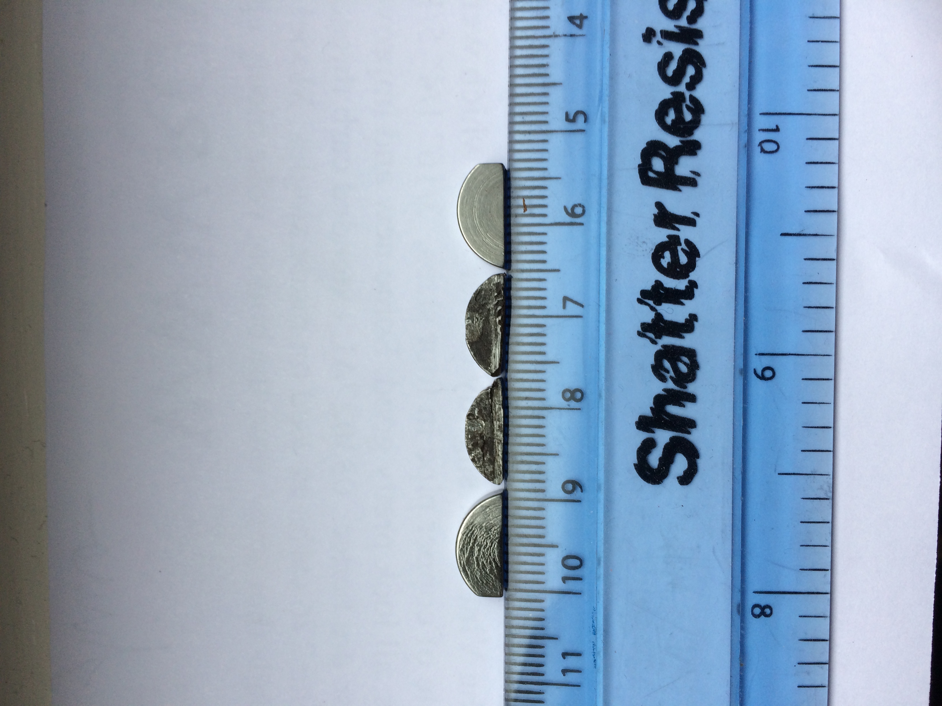

My 1960 Dominator 99 (as far as I can tell) engine is coming together and most of the parts purchased for it so far have fitted fine.
Having noted the state of some of the existing woodruff keys, I decided to treat the motor to some new ones; the shafts and key slots all being in excellent condition. However the new HT and Cam keys do not fit. The new ones are deeper than the existing items; both of which appear to have had the peak of the curved part ground flat. Thus the new ones sit too high in the cut out for the slot on the pinion to go over. A picture where the new flank the old is hopefully included below.

Hi Alan I too am building a…
Hi Alan I too am building a 1960 Dommie 99 and, like you, have fallen foul of the ‘oversize Woodruff key’ issue. I ended up grinding and filing 3 out of the 5 keys to make them fit into the slots in the various shafts. I even bought a complete set from one of the usual suspects but they too were oversize. I think that’s what we get for now living in a time where precision isn’t particularly popular with the mass parts retailers.

Thanks for the responses. I don't understand why RGM are so precise about the dimensions of the parts if they are wrong for the job.
I would understand if there are variations from model to model, but the suppliers only mention the difference for the Mk3, while the parts appear to be the same size.
Phil, that set of five is now £7 plus VAT and carriage.
Maybe they were match fitted…
Maybe they were match fitted in the works? They need to be snug, and how quickly did the cutting tool stay within a tight enough tolerance to allow keys to be interchangeable? Remember...in car factories, "standard" pistons often came in four graded sizes...a, b, c and d. As the boring cutters wore, the bores on successive motors got smaller and they fitted the next size down the sequence until they ran out of sizes and reset the machine. You can always make a big key fit a small slot...it's a good thing they don't sell them under sized.

I would not be too surprised to learn that the set of replacement keys for Dominators are now metric in size.
Woodruff keys
While there is no excuse as to why the keys supplied by the big suppliers don't fit, they don't have to be particularly precise in their size. They should only be there to act as a locator, and in many cases don't need to be there at all. That is why they are made from relatively soft mild steel.
If they are being relied on to provide the drive/power transmission, then something is wrong - there are things called drive keys for that job, a different animal as to shape and material. On our engines, that is what the tapers do/ should be doing.
Keyways for cam drives started to disappear in the car world from around 1985-86, instead relying on the shape of the bolt heads and proper torque to keep everything in place and that is the norm now in most engines made as cutting key slots and fitting keys costs time and money.
Once upon a time you could purchase these keys as a set. I believe there were 5 keys in the set which cost a massive £2.00. In recent years I have obtained those for my needs as single items and generally found some fettling was needed for a snug fit. Often, on the larger keys, the ends also had to be chopped off so they dropped deeper into the crankshaft slots.
