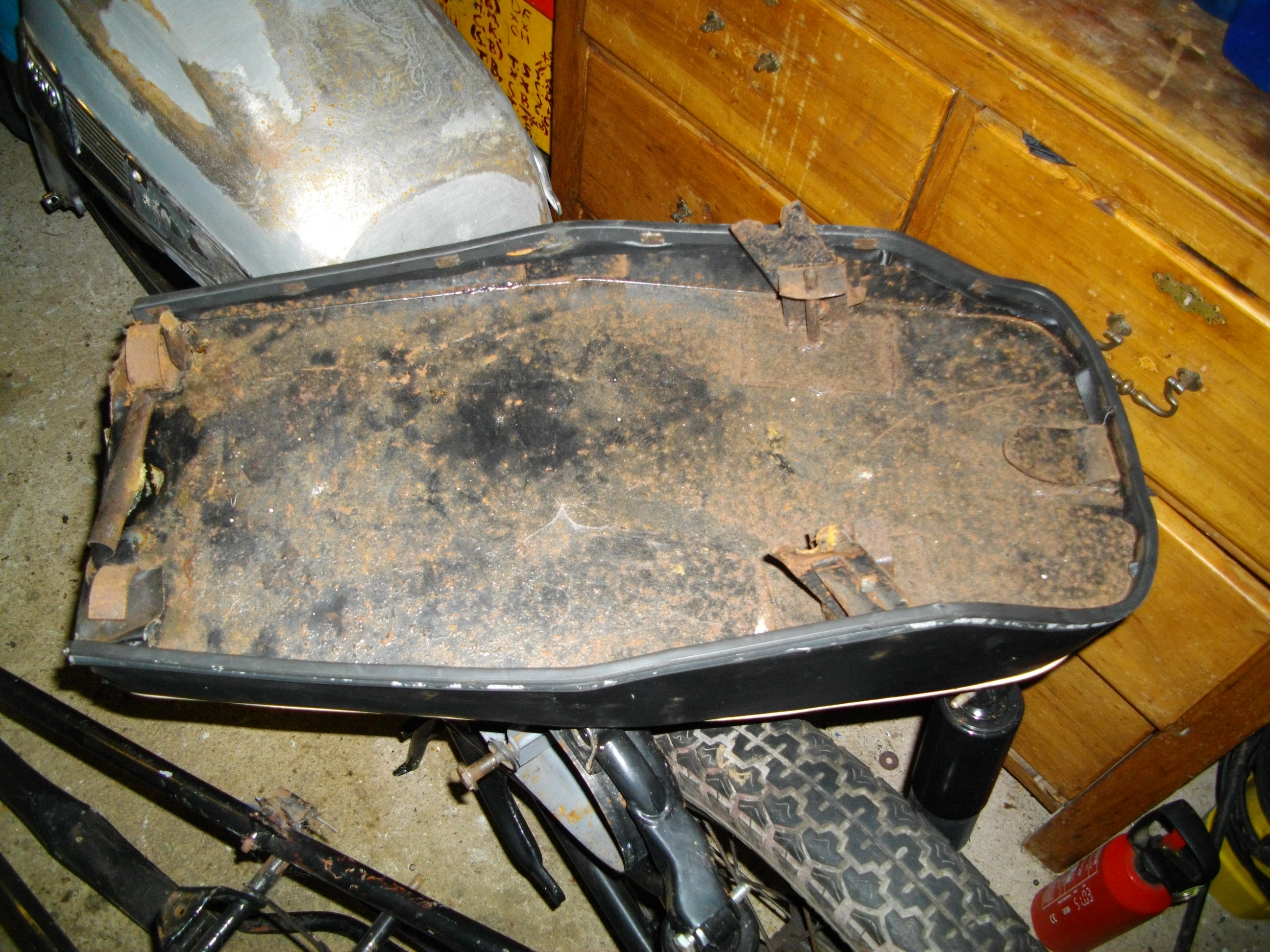

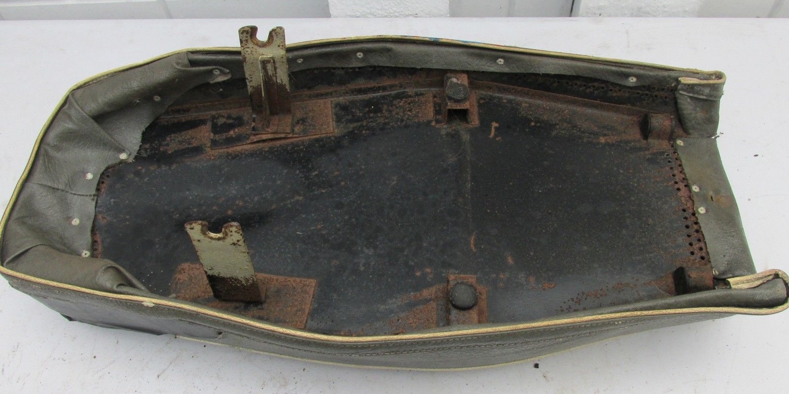

Hi Bruce - your seat has exactly the right fastening that Dan is looking for at the rear. Yours is actually a Slimline Featherbed seat off of an early Dommi De/Lux, as the two mounting rubbers at the front are closer together than on a Jubilee.
Later D/Lux seats (Dommi & Jubilee/Navigator) had 'L' shape brackets with a prong, that married an inverted 'L' shape bracket on the frame - that had a hole to accept the prong. At the same time, a tab with a Dzus fastener was added at the rear.
Thanks Andy - i had realised it wasn’t a jubilee/navigator seat, as you say the front mounting points are spaced narrower than what I need - but it’s good to know what it actually comes from! I’m sure I can modify it fully to fit properly, a bit of cutting & welding to suit the new foam & cover & frame - I do like a challenge!
Hi Bruce,
Thanks yes it is, very...... if only because it looks like my seat base! I’m not sure but it looks like your  rear brackets have been opened out to fit the terry clips for an early deluxe seat, or maybe they made them like that? Thanks to your pic I now have a plan, in my head at least! , how to fit my seat. I’ve pretty much finished the Jubilee as a rider rather than a show pony ( still looking for a 6 1/2 inch headlight shell tho) and am now trying to build a standard Navigator from a deluxe frame and all the other bits I’ve collected!

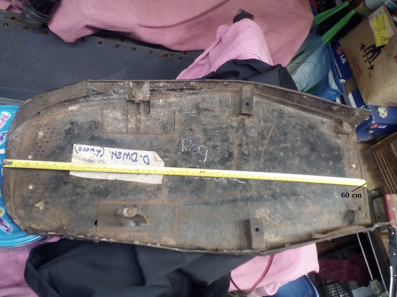

Dan, this is the underside of my original Navigator standard seat as I bought it. The rear mounts for the shock bolts look different to your mounts. I was also thinking fo a quick detachable seat. Maybe the shock bolts can be converted to accept the seat knobs of a Norton Commando or vice versa?
Navi seat underside
Hi Ulrich
Your Seat is for the Standard Navigator - and fits between two spacers and is then held in place by tightening up the Shock Absorber bolt, which also holds the mudguard. Dans De/Lux seat has a different arrangement that just clips down into place - like the Dommi De/Lux seat showed by Bruce Firth-Clark

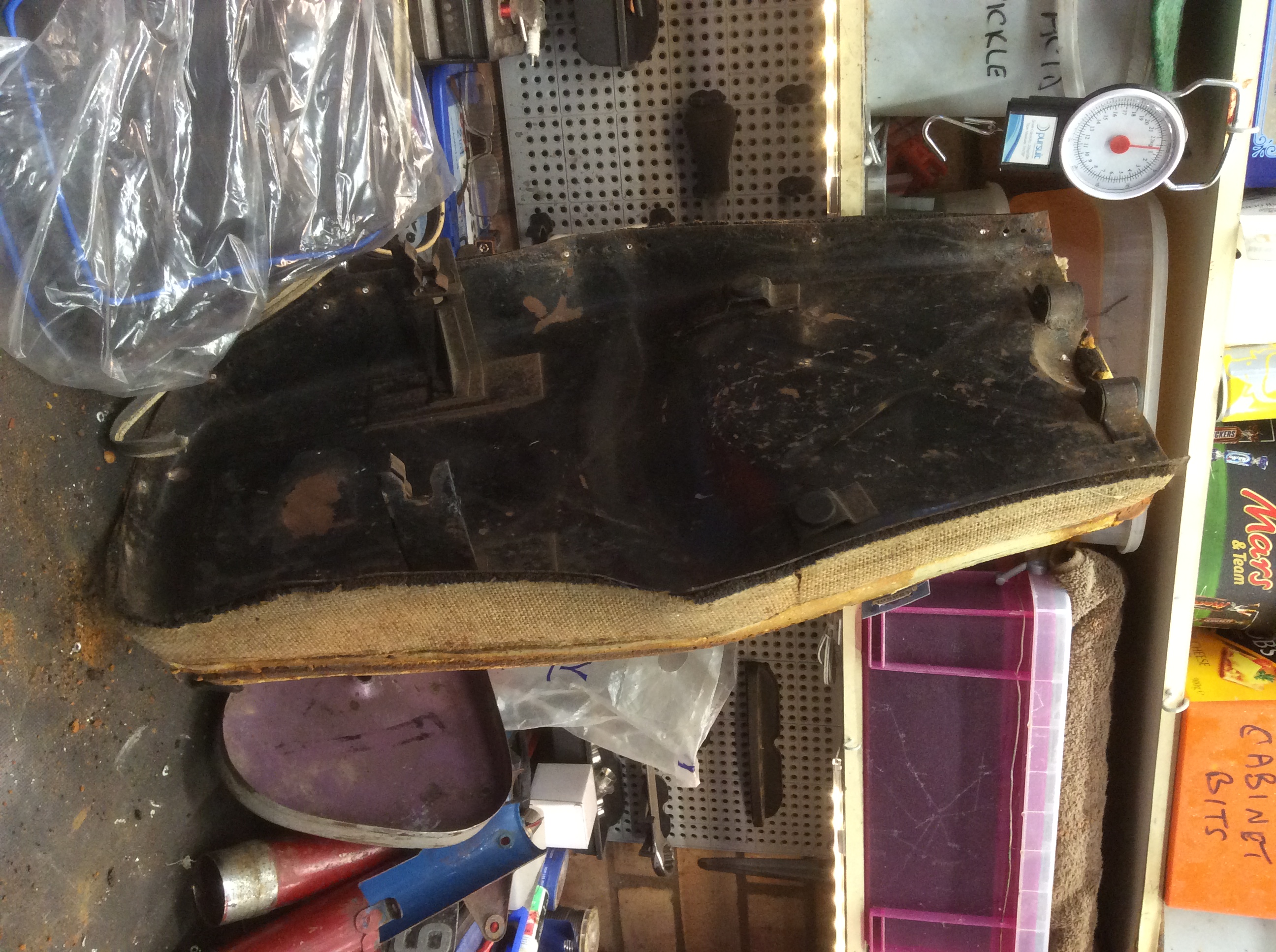

Hi Uli, I hope your engine problems are behind you!  My seat was for a deluxe, you can see the cut off bracket at the back that used to attach it to the rear mudguard, the 2pins held it in place, along with the front rubbers, My plan is go down the early deluxe route, I have the extended shock absorber bolts and will widen the slots in the rear brackets and weld a plate to accept the terry clips like this one, which Bruce posted :
