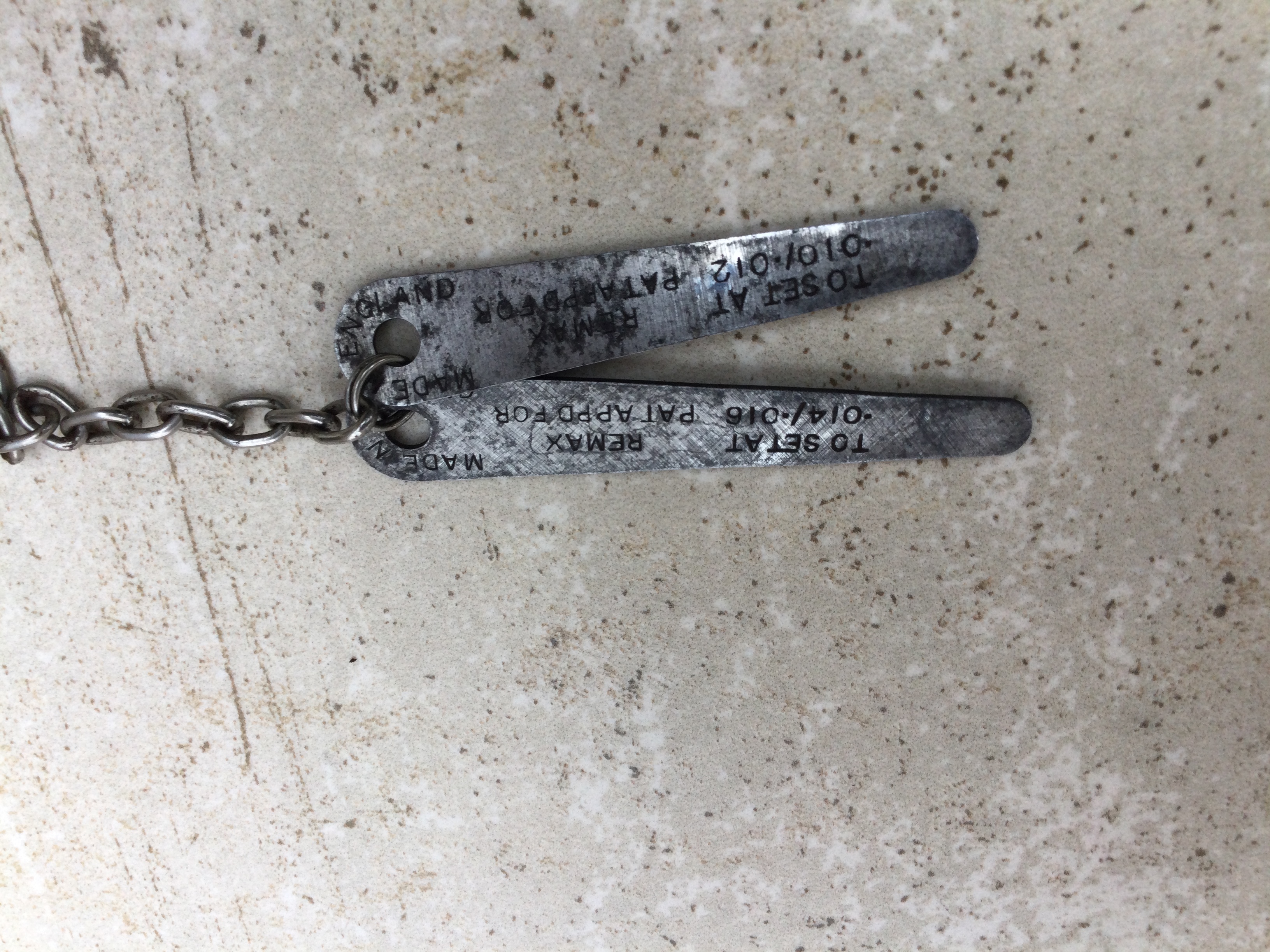

Here is a picture of a pair of gauges marked “To set at”. 0.010/0.012 and 0.014/0.016 thou.

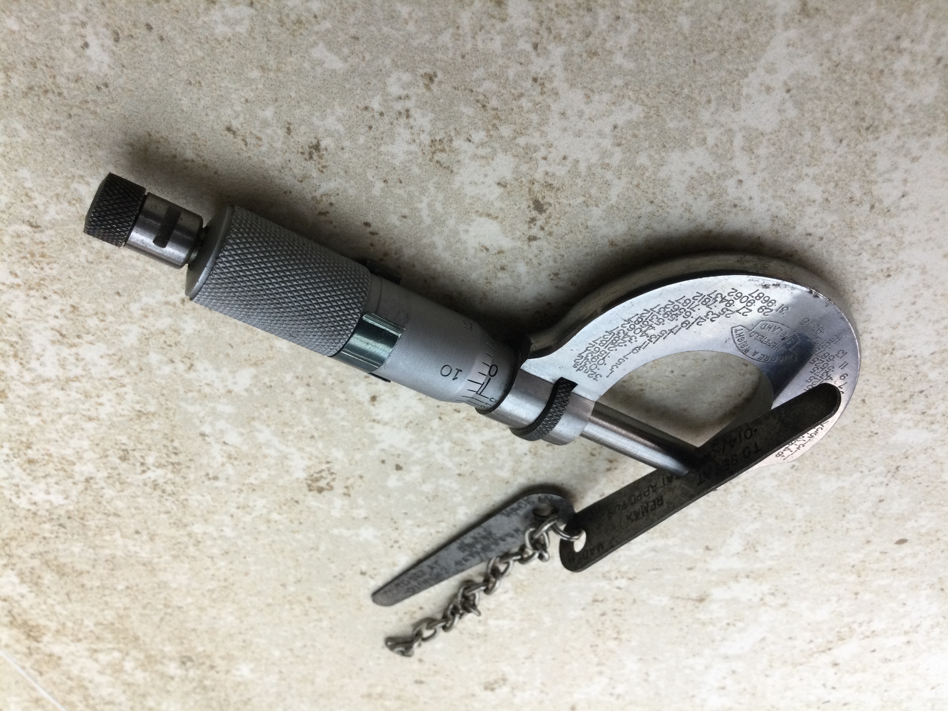

Manufactured by Remax, Pat Appd For Made in England. Ground steel finish, good quality item been in my tool set for years.  The curious bit is, they are almost twice the size marked on the face at 31 and 36 thou respectively? Anyone seen these before, ideas as to use ?

Short of a few bits, a Remax kit for setting points and testing the starter.
https://www.mmoc.org.uk/Messageboard/viewtopic.php?t=51515
A ring is missing which goes over the distributor cam and the thickness of this ring has been added to the thickness of the feeler. Hence the feeler is thicker than the numbers stamped on it.
