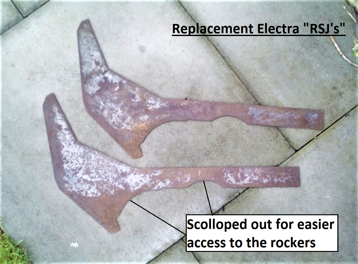

Wise words as always Alan, I've often wondered - does the Electra really need those obstructive stiffening plates?   It must make getting the rocker box covers off near impossible to do the tappets?
I think the stiffening plates were necessary on the Electra, because of the extra unladen weight placed on the headstock. Extra battery, and the extra weight of the starter motor gubbins.
At first it was impossible to remove the exhaust rocker caps on an Electra - as the stiffening plates got in the way. But very soon, in production, the factory added a scollop to the profile of the plate, allowing access.
Here are some blank plates we had made some time back (by a member who decamped to Oz)Electra RSJ with notes
Shows the state that AMC were in when a factory uses bodges like this instead of strengthening the frame properly.
