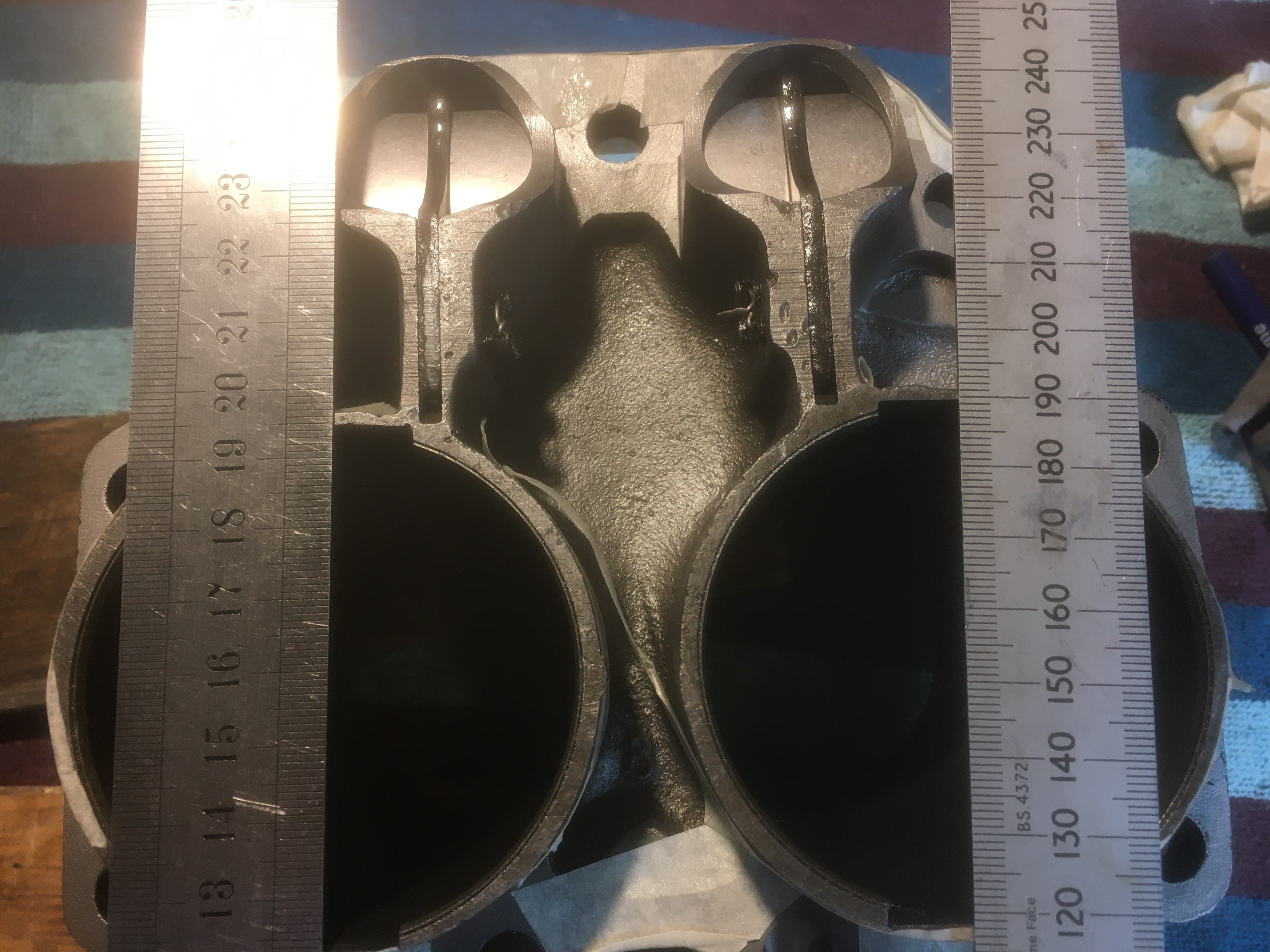

Hi. A while ago I bought a set of (apparently) new old stock Dommie 99 barrels for my Dommie project. I’ve also bought a set of Thunder Engineering conrods. When I put the barrels onto the engine today I can only rotate the crankshaft about two thirds of a rotation before the conrods come to a dead halt against ’something’. When I look at the underside of the barrels, I can see that the cutouts for conrod clearance in the barrels are in different places for the left-hand and right-hand bores (please see photos). This is mainly at the front cutouts - the rear ones are more similarly placed, but not exactly. This means that the two cutouts in one cylinder are perfectly ‘fore and aft’ whereas those for the other cylinder are angled away and not parallel to the other cylinder’s cutouts.
Does anyone know if these barrels are usable or is that why they were unused until I found them? Should I be looking for another set of barrels?
If they are usable, I guess that I’ll need to grind or cut away some of the liner and barrel material - is that achievable and/or wise? If that is possible, what’s the best tool to use - would an angle grinder be suitable?

As Robert says, these barrels appear to have liners which new and NOS would not have. Are you sure these are proper 99 barrels? Count the fins to confirm. An 88 barrel on a 99 bottom end would end up withe conrods fouling the sides of the barrels.
Attached photos show underside differences.

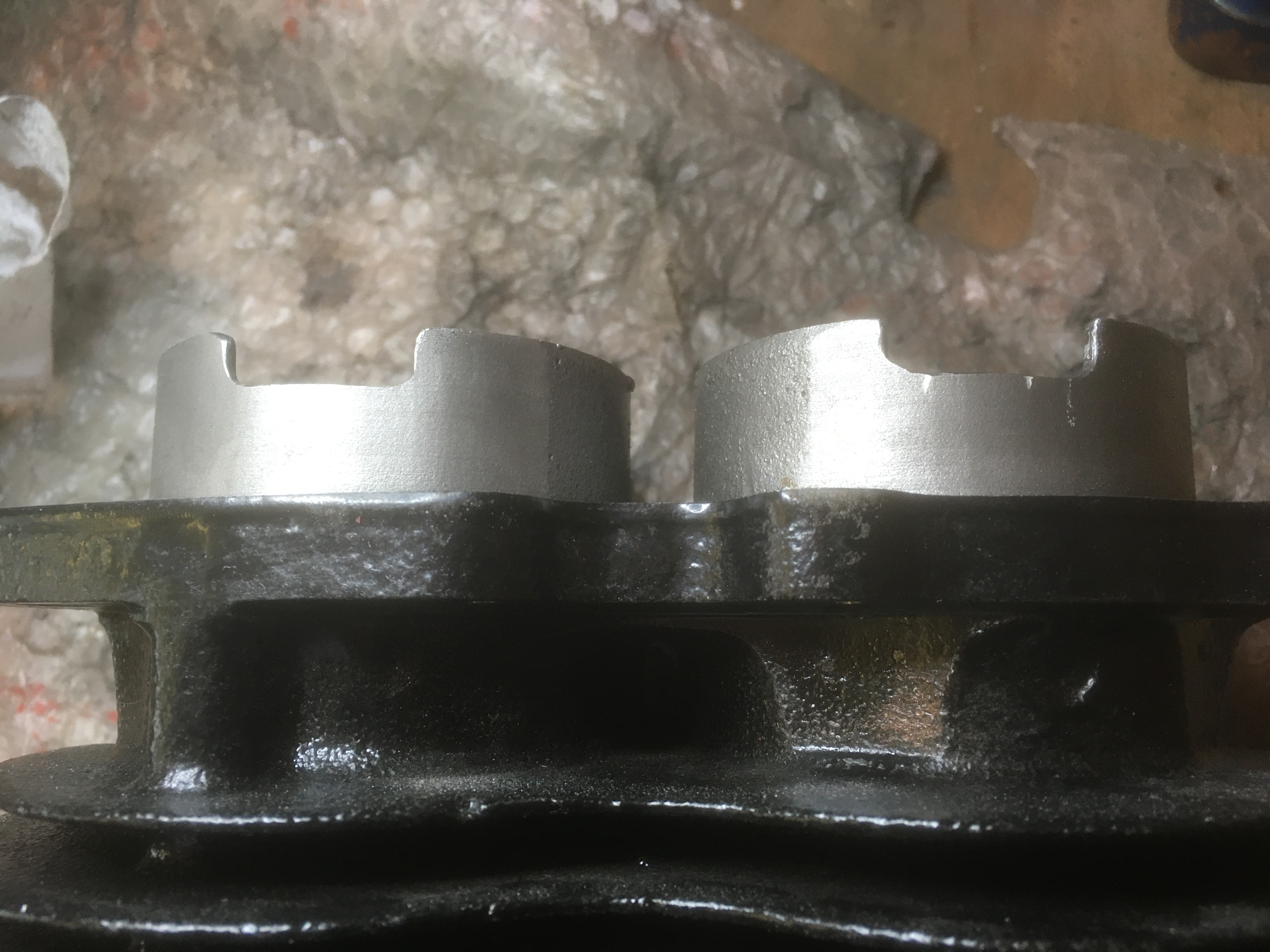

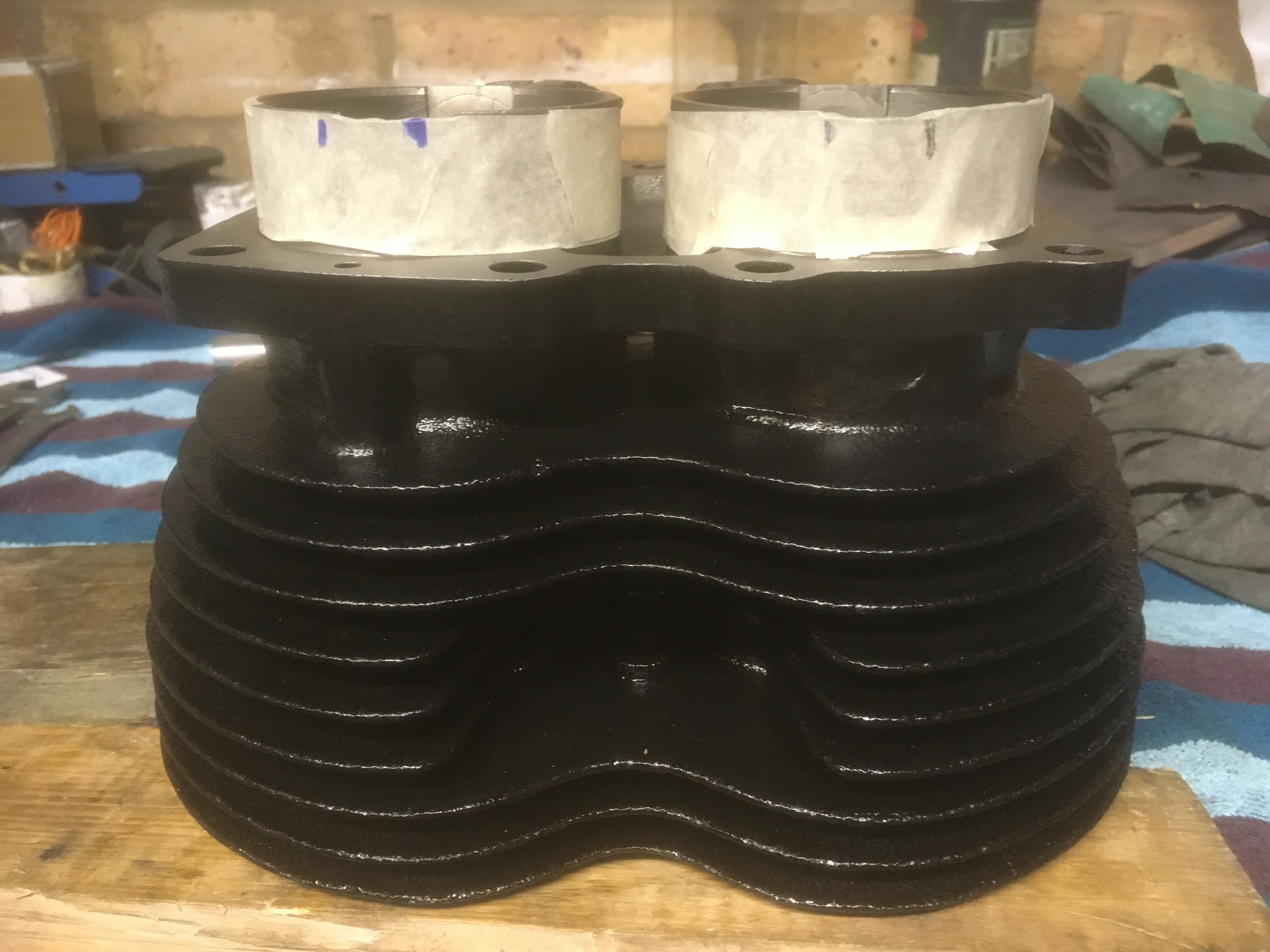

Philip, my barrel has 9 fins (photo below), which I thought meant they were for a 99, but they haven’t got the deep cutouts for the conrod clearance that your photo shows. Aren’t those cutouts just for a 650 (and possibly an Atlas)?
The barrel that was on the bike when I bought it was the same as my current one and the engine turned over fine with that barrel and standard Norton conrods. Unfortunately though that barrel is too damaged to use. Also, none of the barrels I have been offered in the past as Dommie 99 barrels had those cutouts - are the ones with cutouts for a later model - mine is a 1960 bike.
Hi Philip. I think that I…
Hi Philip. I think that I misunderstood the cation on your second photo - I think now that the second photo shows a 650 barrel at the top of the picture and a 99 barrel at the bottom of the photo. If that’s the case, then my barrel is correct but badly machined.
The reason I say that it’s badly machined is because the clearance ‘scoops’ at the bottom of your barrel are positioned close up to the lock plates of the cam followers. Those scoops on the left-hand and right-hand bores of my barrel are in two different positions and neither are the same as the ones in your photo.

650 - 99 Barrels
Attachment shows better labelled 99 & 650 barrels undersides. All of the factory 99 (& other twins) barrels were machined to bore size from a single casting (number 22709). So no liners were squeezed inside the cylinder bores. A good engineering company should be able to sort out the cutaway chamfer for you. On the 99 engine the piston rings do not reach to the very bottom of the cylinder. 650 barrels needs more care to detail otherwise the skirts can crack and chunks fall off.

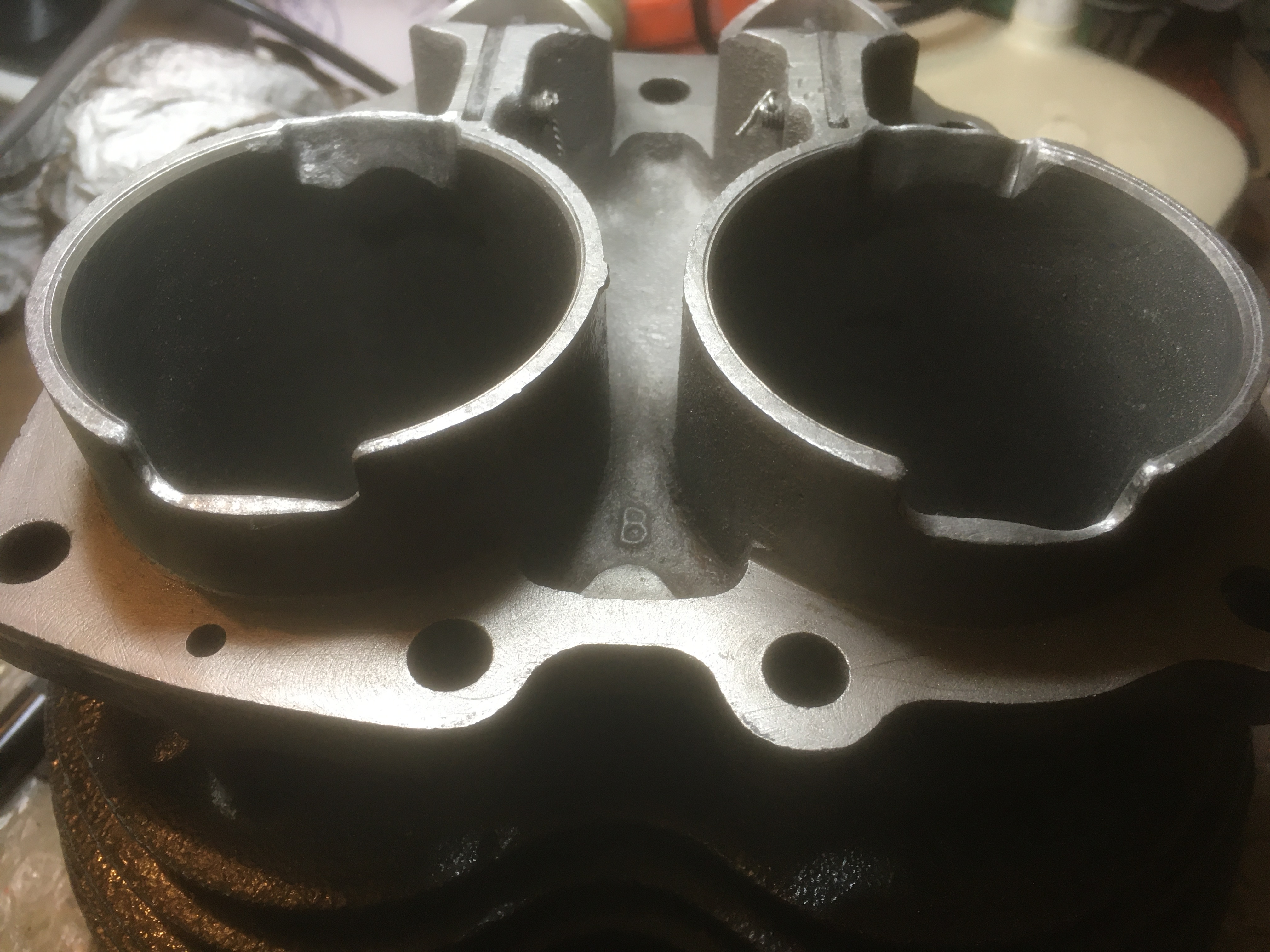

Hi guys. Well I ‘be sorted…
Hi guys. Well I ‘be sorted my conrod issue. It was in fact two separate problems.

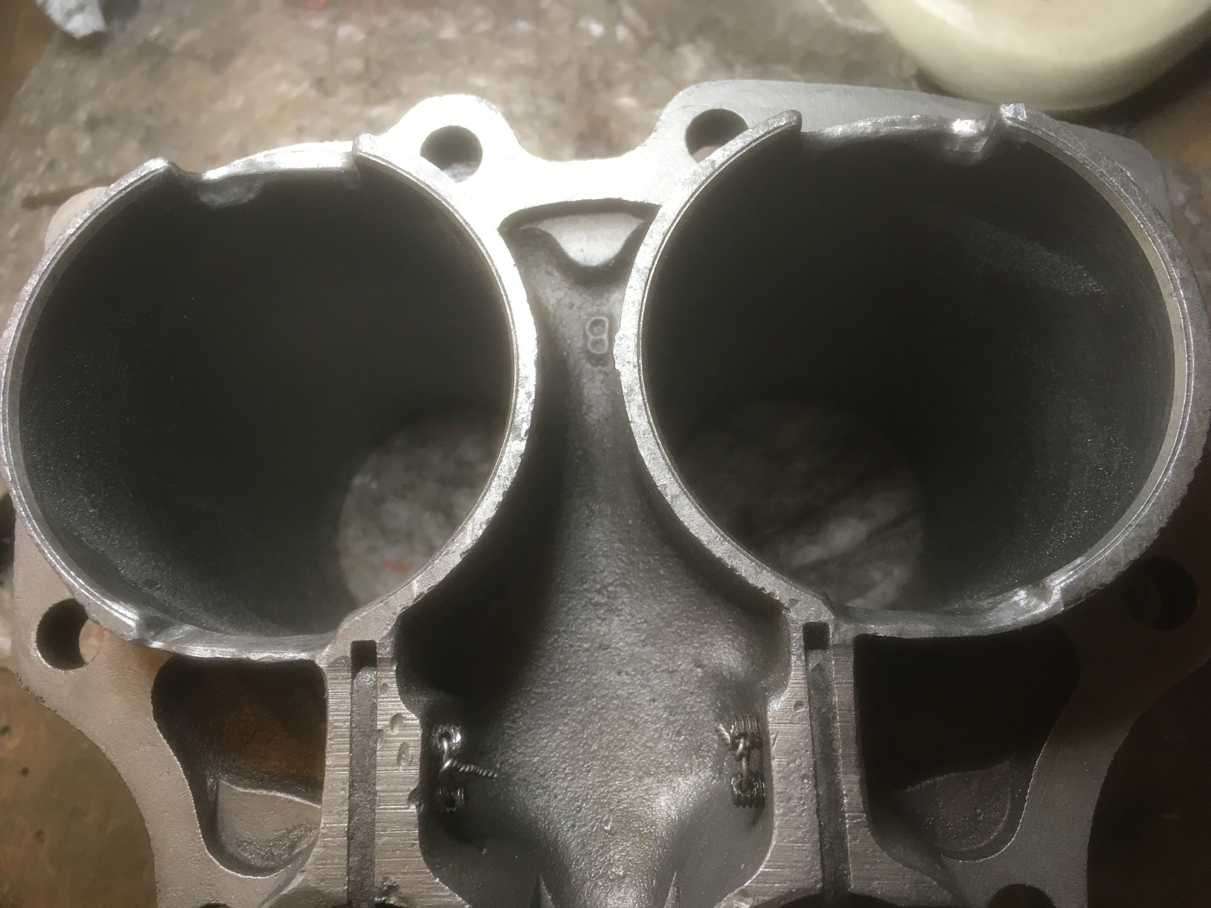

I checked the alignment of the conrod clearance scoops and those of one cylinder was massively out of alignment so I set to with my Dremel and ground out a bit of barrel skirt to get things straight. That didn’t fix the conrod collision issue. So I ground down the clearance scoops at the rear of both cylinders (see photos). That got really close to fixing the problem but there was still just a very small contact - the crankshaft went full revolution but there was a slight tight spot somewhere. I did lots of measuring and couldn’t understand how the conrods could still be hitting the barrels. It was then that I noticed a small line of shiny casting flash on bottom edge of one barrel skirt socket in the crankcase. It was only about 2mm long by 1mm deep. I managed to remove it with a pair of pliers (crankcase packed with rags first) and now everything is fine - crankshaft rotates no problem.

Don't forget to factor into your gap grinding, enough room for the conrods to move along the big end pins and still not bounce off the sides of the cylinder slots. Plus at a risk of teaching you to suck eggs, the corners of each slot need a small radius to prevent stress cracking.
Thanks Neil. I hadn’t…
Thanks Neil. I hadn’t thought about checking the clearance with the conrods moved to both the left and right extremities. All corners (internal and external rounded) - I remembered that bit :-)
Looks a tidy job. The…
Looks a tidy job. The liners are thicker than they look as they have a decent chamfer on them.
Now polish the edges of the…
Now polish the edges of the conrods where they used to hit the bores....
Yes...and
Yes this is a fine answer to a problem, I also could not see why this would not work and as Tony says it looks like a badly made/machined barrel in the first place. Now every thing is 'not hitting' but by how much? I would give myself a smidgin of clearance as on the overrun at 6500 in third!! If something touched it could be expensive?? A rough suggestion is to fit the barrels without a base gasket, but with some plaster-scene in the appropriate places, see what happens when you pull them off again? And as DC says any nicks on the rods need polishing out, the slightest nick in the wrong place becomes a 'saw cut' and things come apart-some times in a 'rush'
Hi Al. When I was using the…
Hi Al. When I was using the Dremel to enlarge the clearance areas I allowed ‘2 smidgens’ not just one! :-) I probably left wider clearances than strictly necessary but I wanted to be really sure that nothing could touch. Luckily I had just one small nick on the corner of one rod so I just got some well worn fine wet and dry paper and polished it out.
