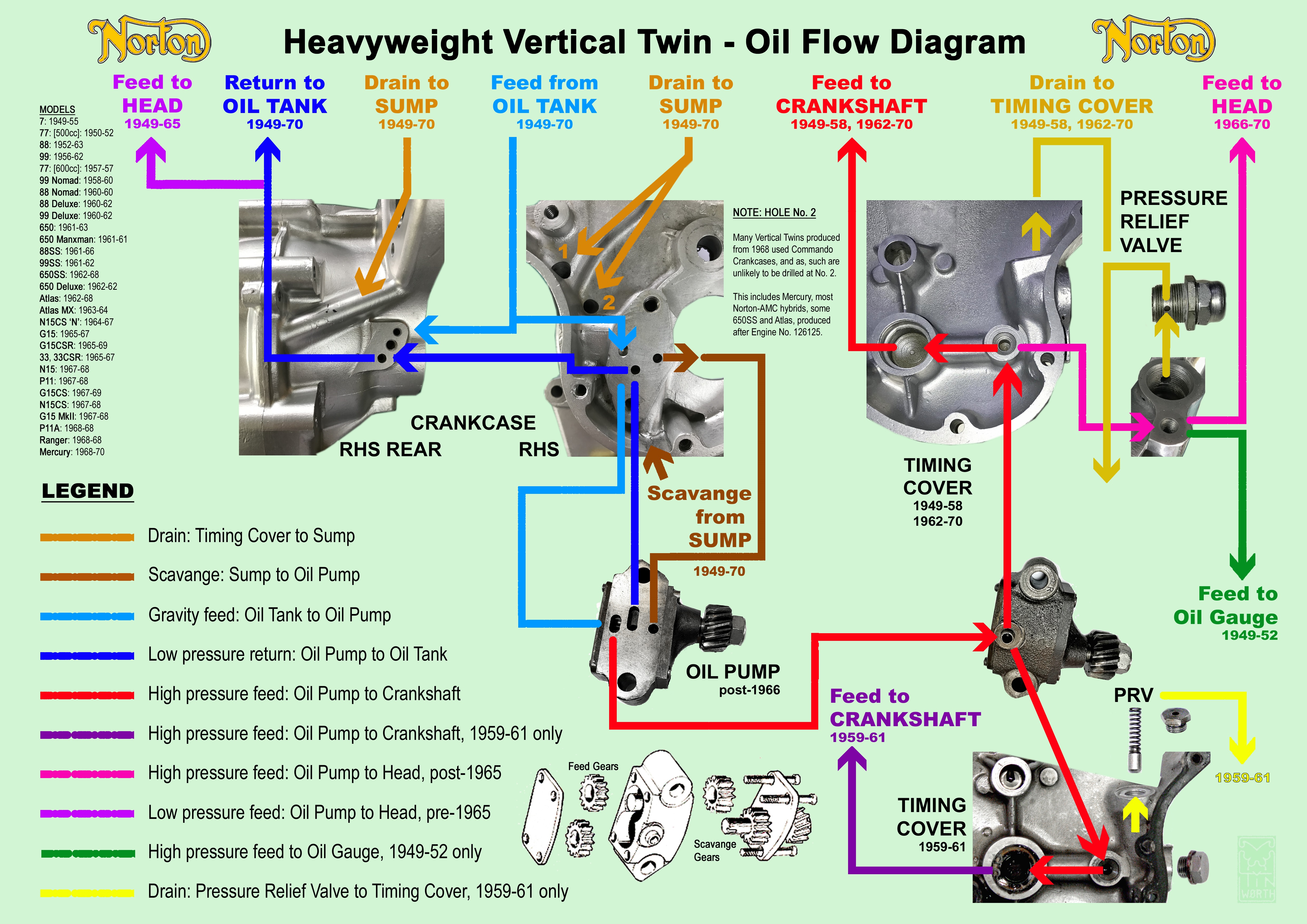

The attached drawing (with thanks to Bruce Tinworth) explains much but does not apply to Commando engines.
