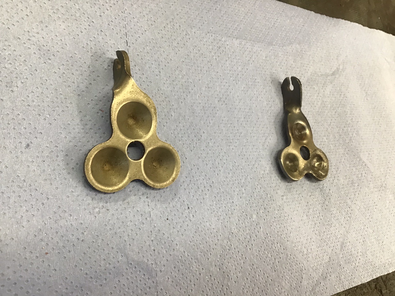

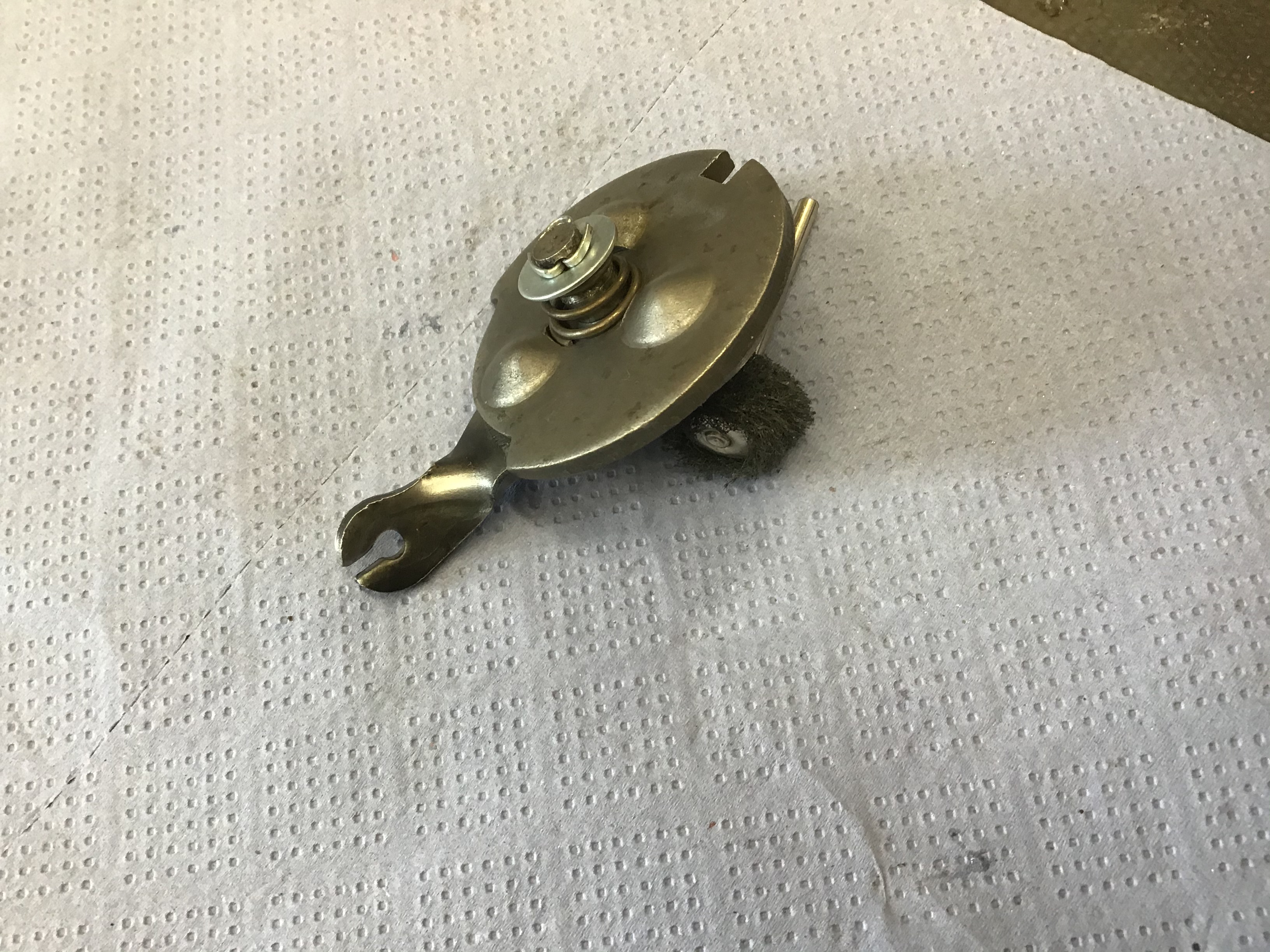

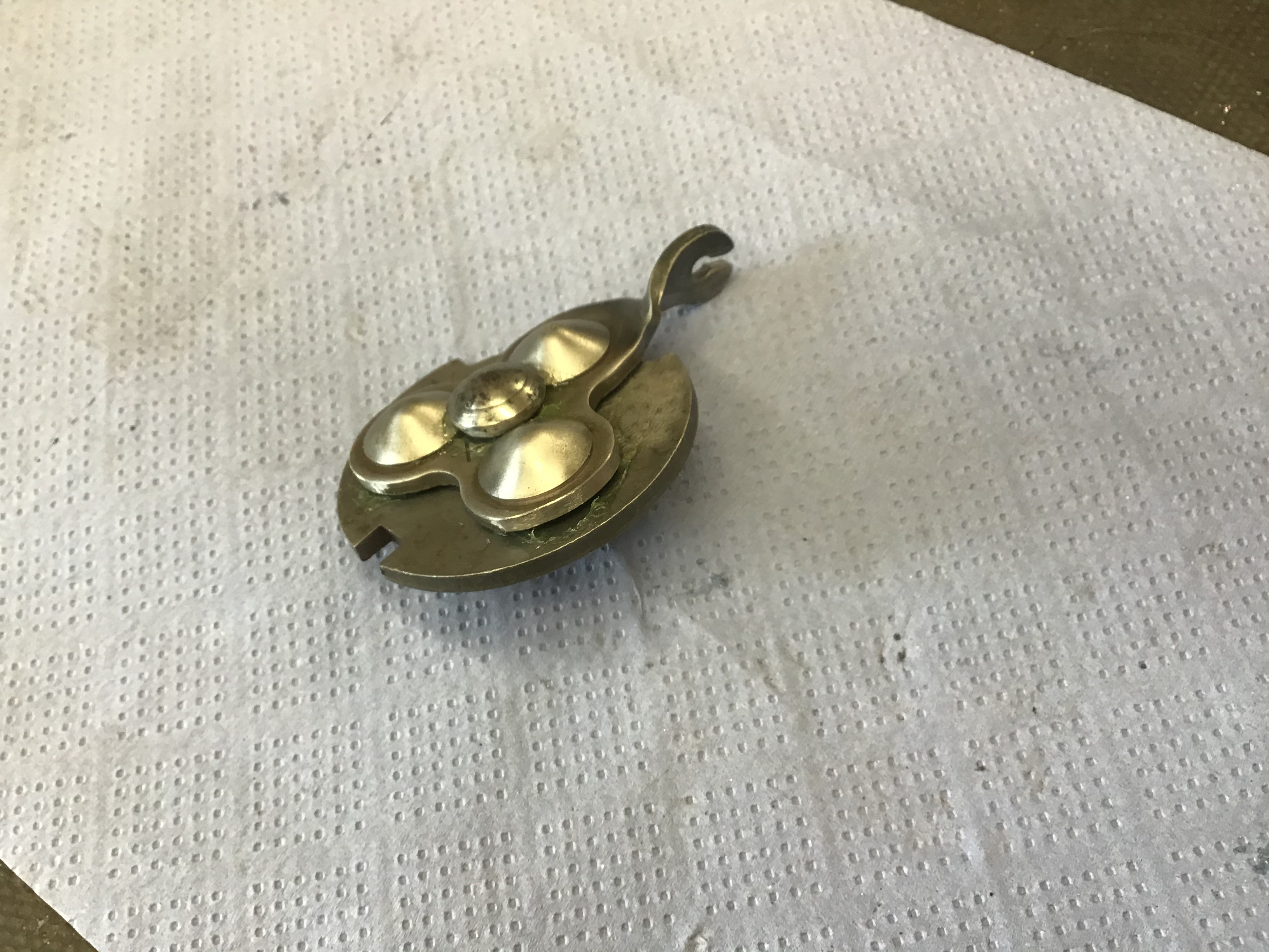

Just checked this - it’s the centre portion in the actuator, plate rotates around this pin & held in by a spring & split pin.
Pushrod side

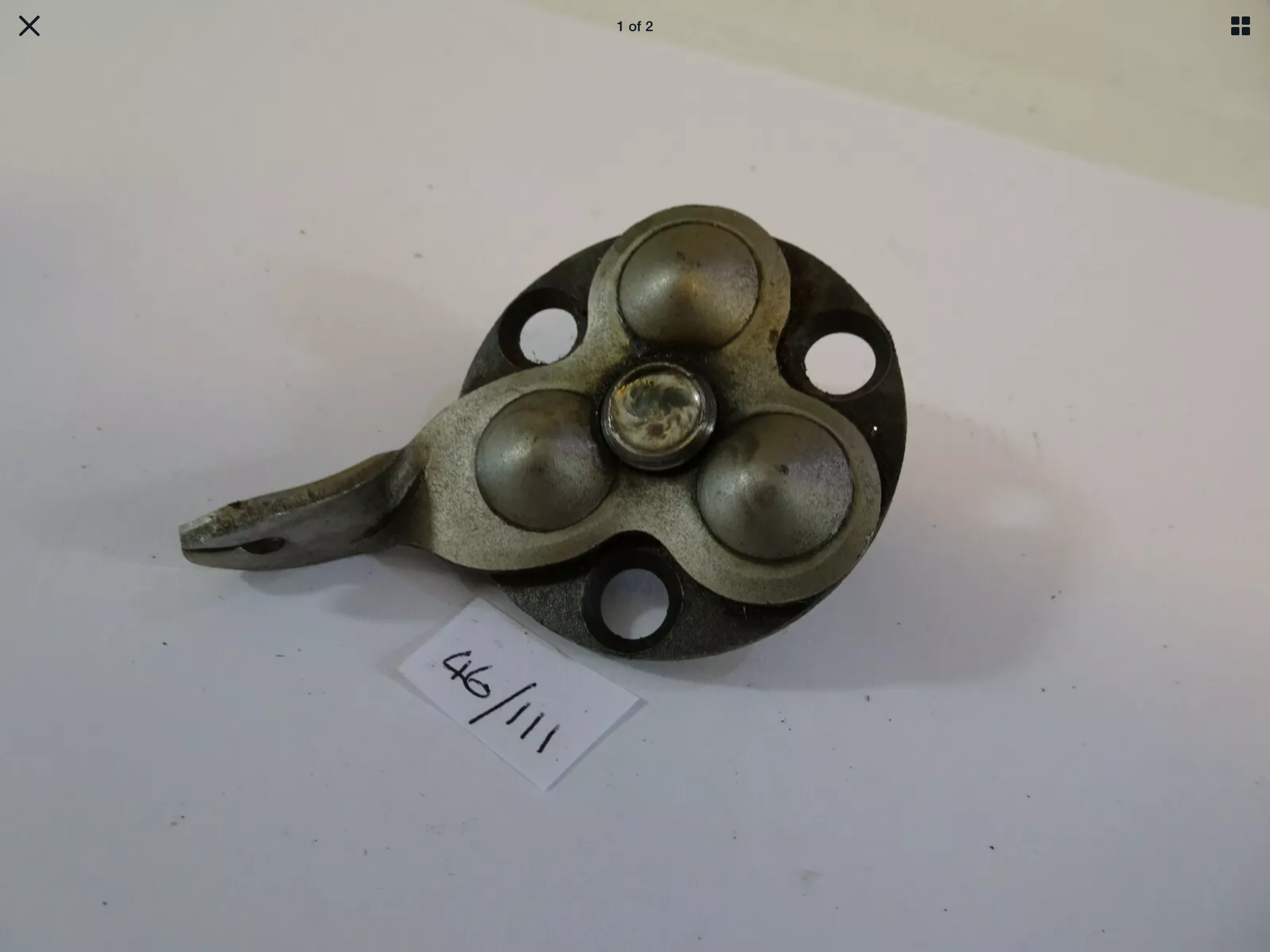

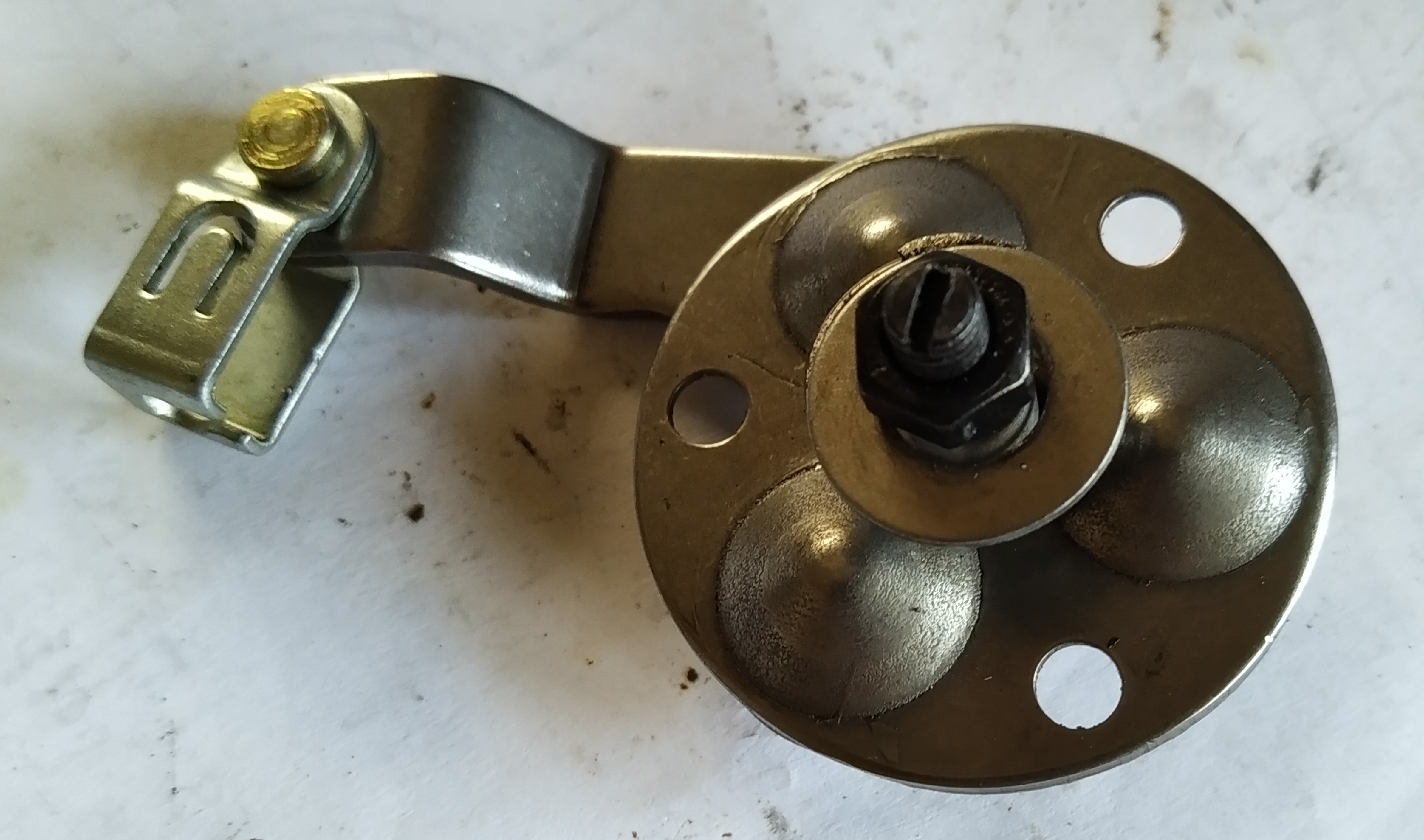

ActuatorGood luck with that - not sure how you’ll manage with the inner casting as they’re different early to late gearbox.  Mine was completely missing when I rebuilt the Jubilee and couldn’t get a complete assy or the “moving” part from anywhere.  I tried the Triumph actuator (photo, with holes in backplate) but found it the wrong size - even “marrying” up the moving part to the Jubilee backplate didn’t line up as the “ball” indents (photo for comparison) are spaced slightly differently!  eventually traced parts in the Jampot Club (Matchless/AJS) shop and got the correct(ish) AMC parts!
Triumph Actuator

It will need some work to fit but I think it doable.
I'll use the one in the attached photo, somewhat modified.  I will use the cable attachment, much better than just a nipple.  I might even re-route the cable, I think the cable could be shortened by a third.
