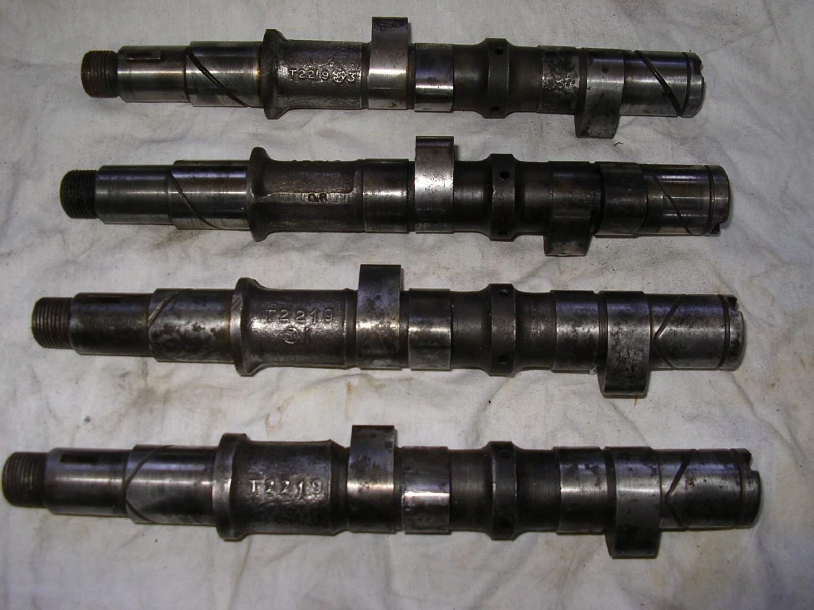

Will a T2418 fit a 1955 88 or is it for the early model 7 thanks in advance
The norton camshaft for sale on eBay that is labelled as T2418 probably has T2219 under all of the rubbish covering it. It also has Q.R. stamped on the side making it a late 1950s camshaft. 1958 onwards up to 1962ish.
It will fit and run in any of the Model 7/88/99 engines and do a good job but this ebay  camshaft looks a bit tired with worn lobes and lots of rust. Best left on eBay and another sought.
Variations of Norton Dominator camshafts shown in attachment. Best to avoid T2219 @ 1. This is the early Model 7 version and offers no performance in a Model 88 or 99.

I have 2 camshaft the one fitted to my engine and another both probably need work, I saw the dirty camshaft at the cheap price that may be better than my two. I don’t want to buy new because I like to make old thing work again. So thinking best of 3. Plus ask the eBay guy who said if it’s rubbish bin it and promises to refund me. I just was not sure of the weird number.
