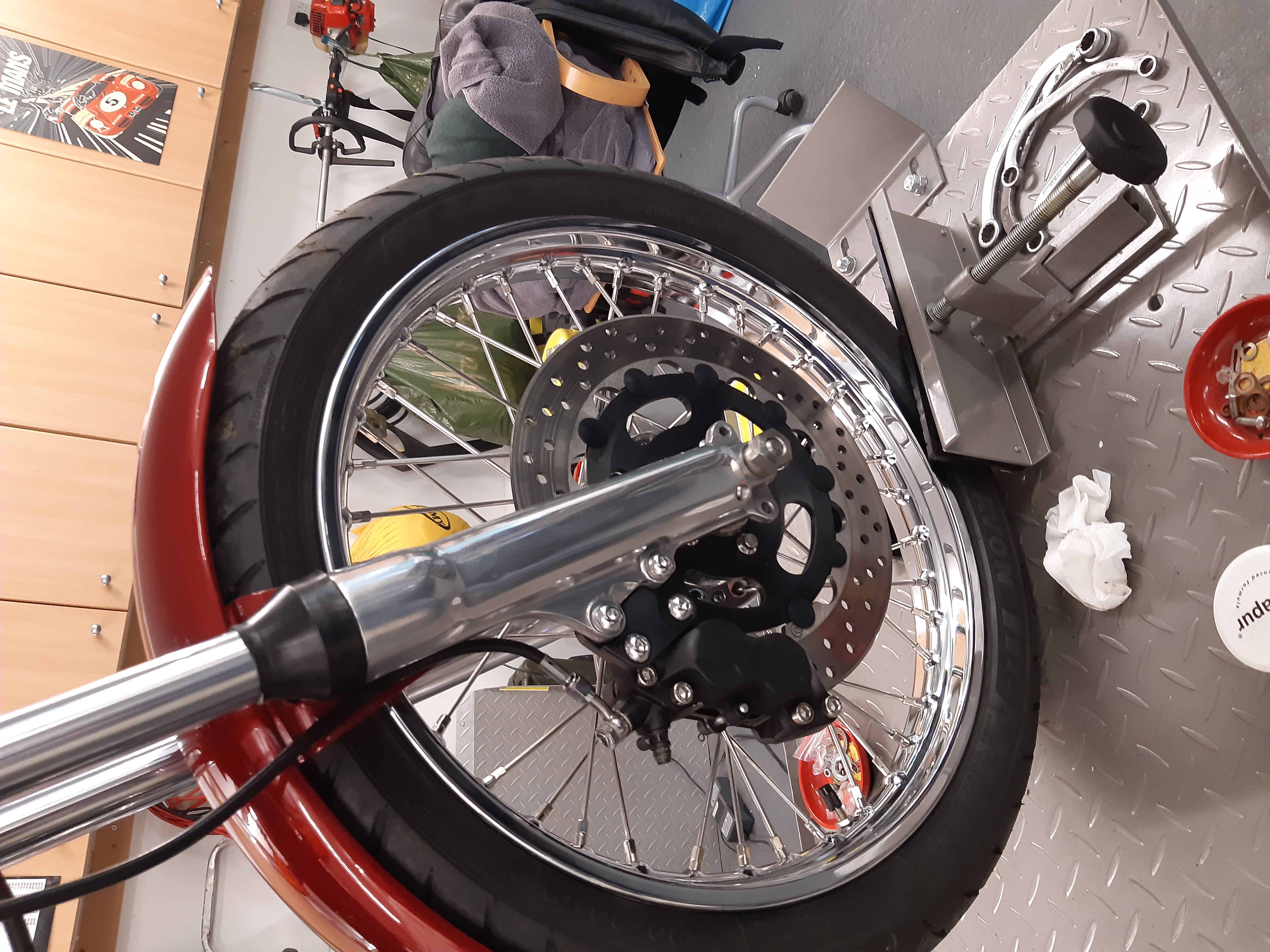

I used the CnW
Picture tells the story.
CNW
this kit is known to be vg quality and works very well, from much feedback. It is not original, but that is not important to me, and function over style is the way to go for brakes, I say. Holland Norton Works should be able to supply more locally than Colorado. Otherwise, I would go for a ready made 13mm cylinder, not a conversion.

My Commando has a floating disc and four piston caliper from a BMW paired with the original 5/8" master cylinder.

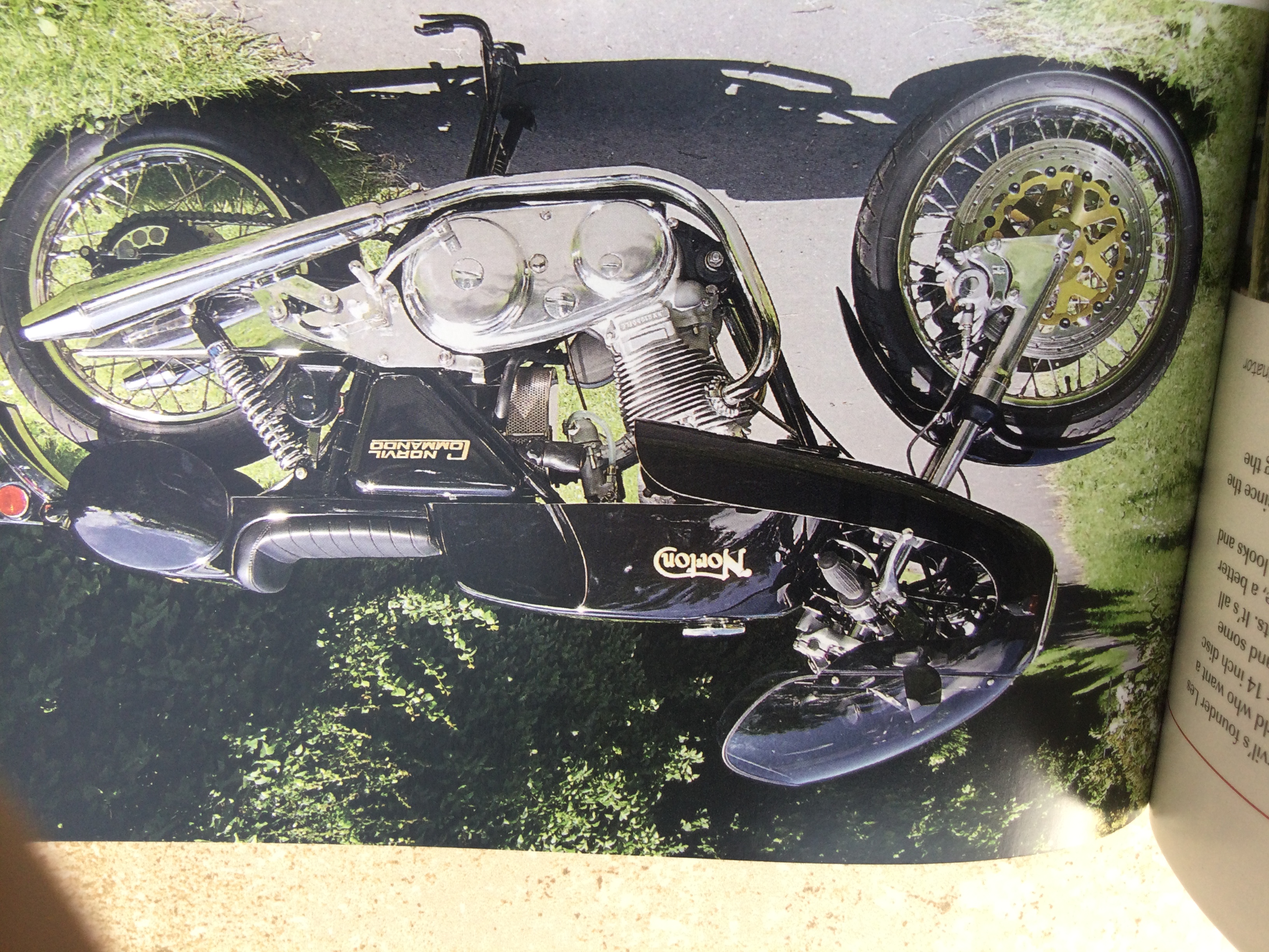

Maybe this is the best....
Just browsing over a coffee and thought this must be the answer to Robins question...
brakes
that previous double disc photo: I have that set up on a Commando, with the original master cylinder, which works well due to extra caliper correcting the hydraulic mismatch ( as tested on Norwegian fjord descents!). However, it is still not as good as a modern twin disc . It also very pricey ( from Norvil as only supplier)
Double disc setups..
...just look "better" to my eyes, not that I speak with much experience of disc brakes on bikes.
From a purely mechanical POV, having 2 discs surely provide an equal force to both legs? Wouldn't a single disc provide some sort of vertical torque force, even if us mere mortals are not capable of discerning this- and wasnt there similar logic in Norton swapping the single disc from one leg to t'other on Commandos?
Asking for a friend...
