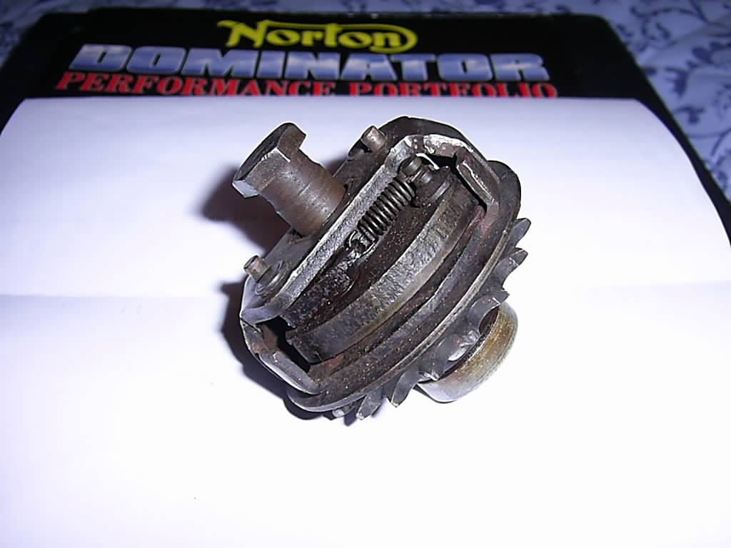

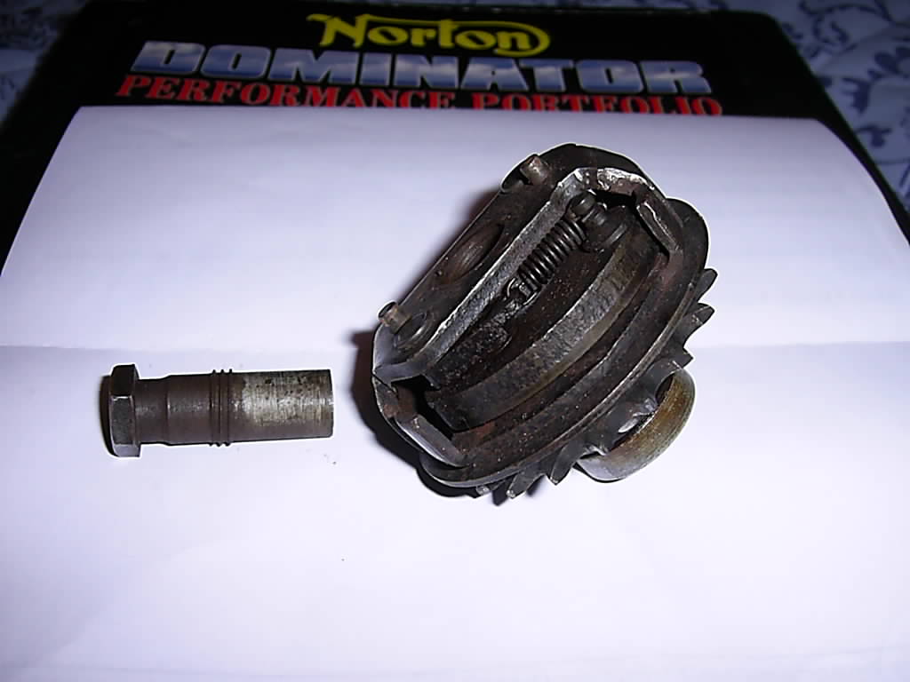

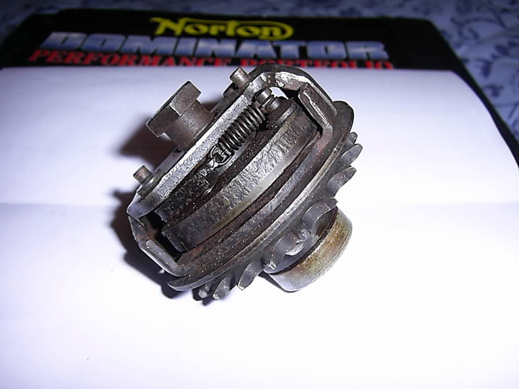

With the Auto advance removed from the Mag. shaft how do I remove the retaining bolt from the auto unit, Thanks in advance for any replies. Campbell
See photos for extraction sequence. The bolt should self-extract if pulled up as far as possible and then turned clockwise. Some very gentle taps against a socket on the shaft end might be needed to help push the bolt along enough for the thread to engage.
