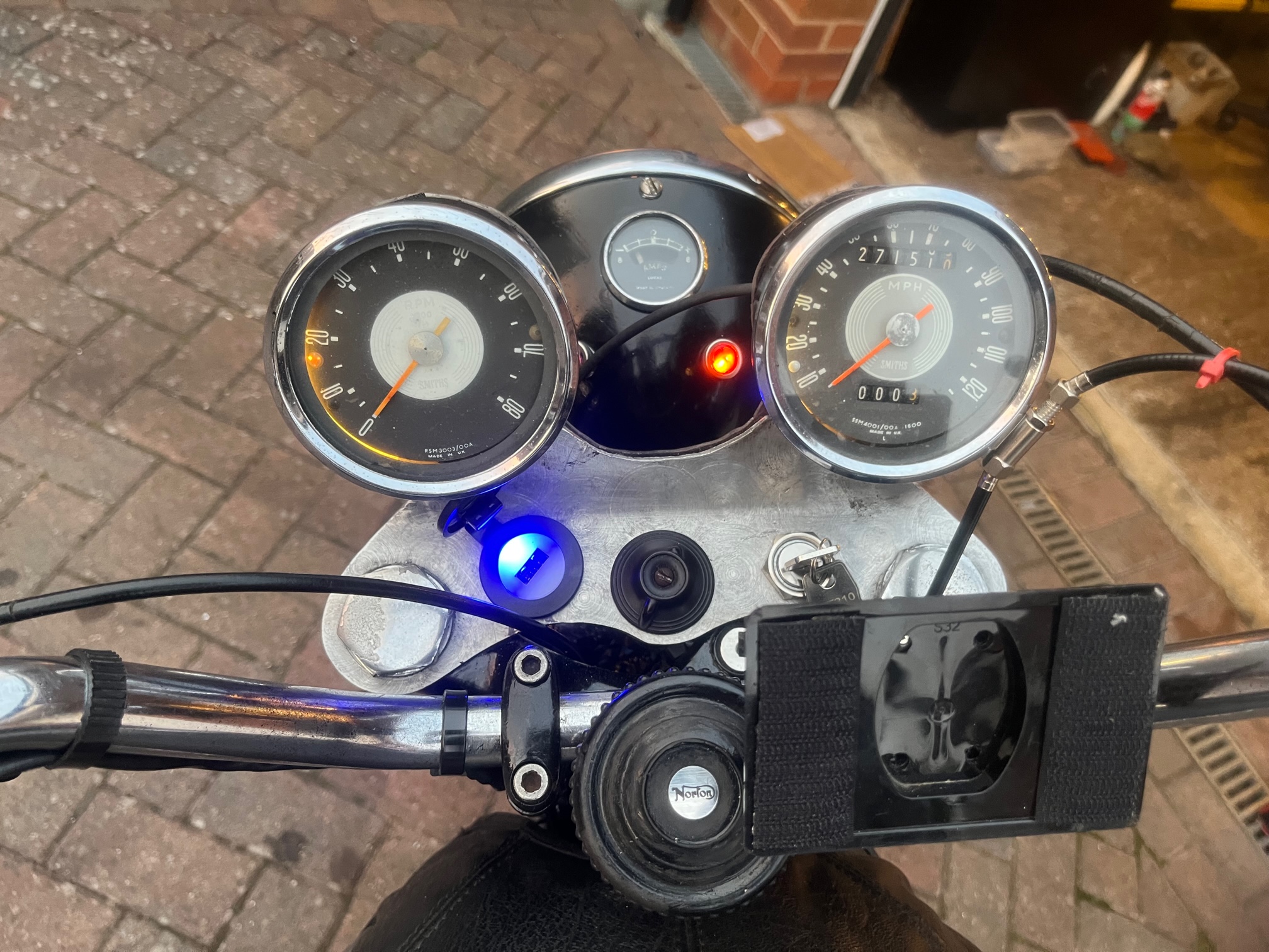

I spoke to Phil Woods who put me right on the problems I was having with the speedo on my bike even with a new cable and gearbox installed. It turned out that the cable fitment at the top was incorrect. The inner cable wasn't going in far enough. Tapping the outer part down a bit sorted it out. Now the speedo works and there's no flicker at all. It's very stable and I'd say fairly accurate.
Nice one Phil!
