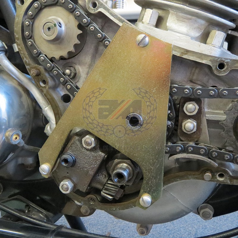

A slave cover can assist getting your cam and mag chain tensions correct. It essentially holds the intermediate sorocket shaft in exactly the right place so that when you have set the chain tensions with the cover off, they will be correct with the cover on.
In the past people have made these by cutting the 'ears' ( the parts that cover the cam and mag sprockets, chain tensioners etc) off another timing cover. Perhaps not so good an idea nowadays.
There is a tool available from Andover Norton that does this - see tool 06.7325.
Knowing your import charge/timing issues, you could get one made by a competent engineering shop local to you. 'All' they have to do is mimic the internal shape of the centre part of  the timing cover, keeping a very close tolerance with respect to the dowel holes and the shaft hole.
Hope that this helps you.
Regards, George.
The intermediate gear spindle is easily pulled out of position by the cam chain which is loaded by the valve springs when a valve is open  , making it almost impossible to adjust either chain accurately . Some spindles get loose when the cam sprocket nut is undone/done up without the use of something to restrain the spindle.Most of us "old hands" have a cutaway cover.
The slave cover is only for the twins. The studs on the singles have a bit of play in their holes to adjust the chain. Check it in several places in case of eccentric sprockets.

I have a set of Magneto Atlas cases, and the studs vary, one stud is waisted to the thread minor diameter for the width of the magneto flange to allow enough adjustment to get the chain tight. Its the same fitting as for a later Lucas distributor.
