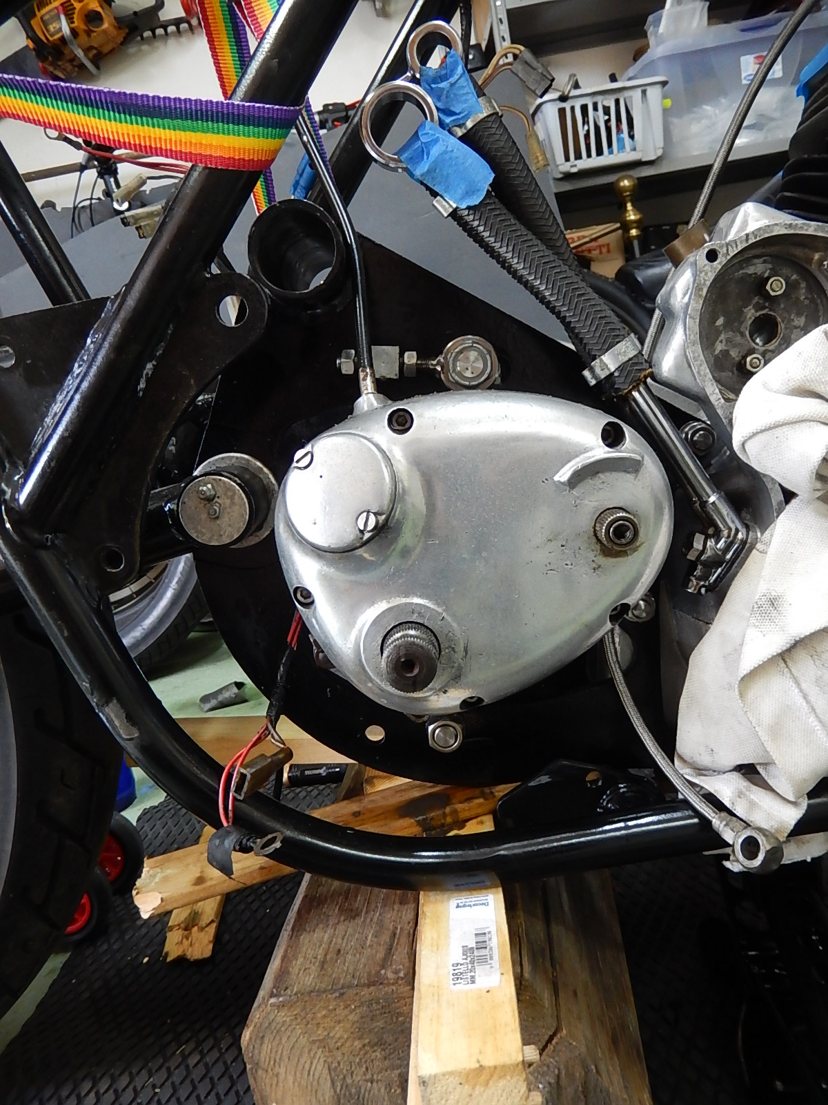

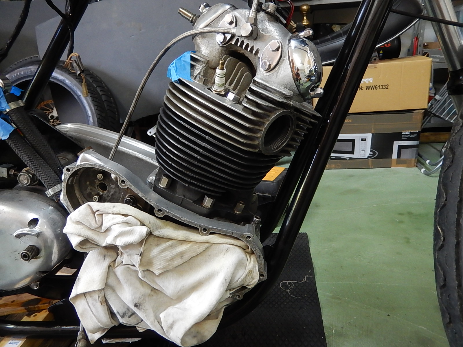

71 Fastback rear isolastic
Is it possible to fit a rear vernier isolastic without removing the engine?
Yes, may need some changes for a 71 as this is for a MK3 but I suspect you will be fitting verniers type anyway.
https://www.accessnorton.com/NortonCommando/isolastics-mkiii-vernier-servicing.840/#post-6048
