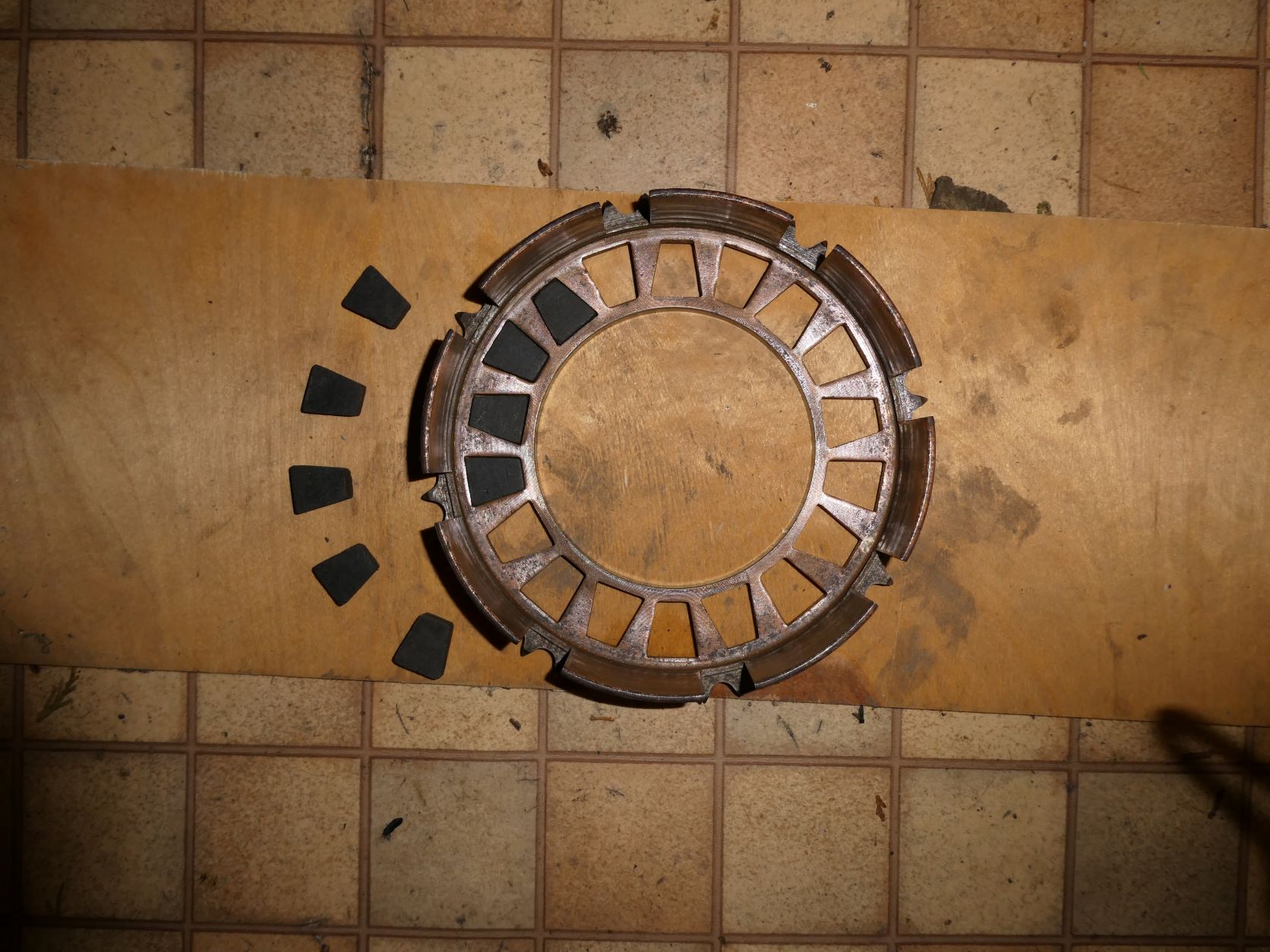

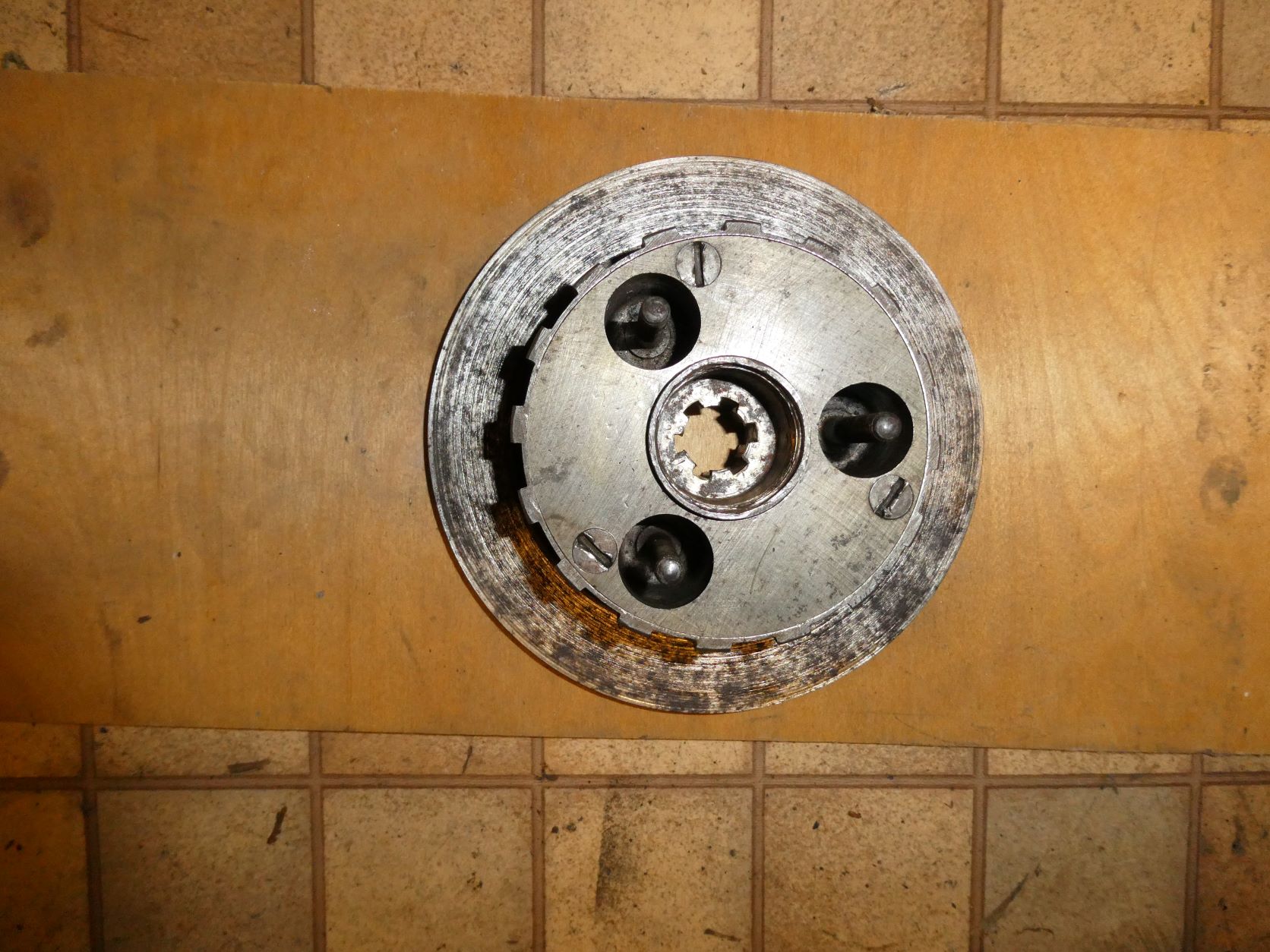

I am refitting the clutch on my '63 650 SS and am a little confused as to what type of clutch centre and chainwheel I have. The Haynes manual shows a clutch centre with bonded friction pads on the backplate and a chainwheel with a solid backplate. My centre backplate is solid with no friction material and the chainwheel has a perforated backplate into which loose friction pads are inserted (pics attached). The Andover Norton and Norvil websites show a solid chainwheel with friction material on the clutch centre backplate. RGM show both a solid chainwheel and one with a continuous friction pad together with a plain clutch centre. They say these latter two parts are for early 3 spring clutches which I presume is what I have. No one appears to show a chainwheel with perforations and loose inserts like mine. My clutch was on the bike when I bought it in the early 1970s, but I don't know if it might have been modified before that. It worked perfectly well until I stopped using the bike in the 1980s. However, it would be helpful to know what setup I have if I need to replace any b its during assembly. Has anyone come across a chainwheel like mine before?
It's the early clutch. Used…

i have on 650 ss late tipe of clutch there are two variants of springs and my clutch have more plates than earlier clutch
I believe the correct clutch…
I believe the correct clutch had a thinner pressure plate and more plates to handle the power of the 650.. If the clutch is handling the power then I would not worry.

It's the early clutch. Used from 1932 until the AMC box appeared. The later clutch has the friction and plain plates the other way round. Probably cheaper to machine the basket after the redesign. No disadvantage in use (unless someone knows differently?).
