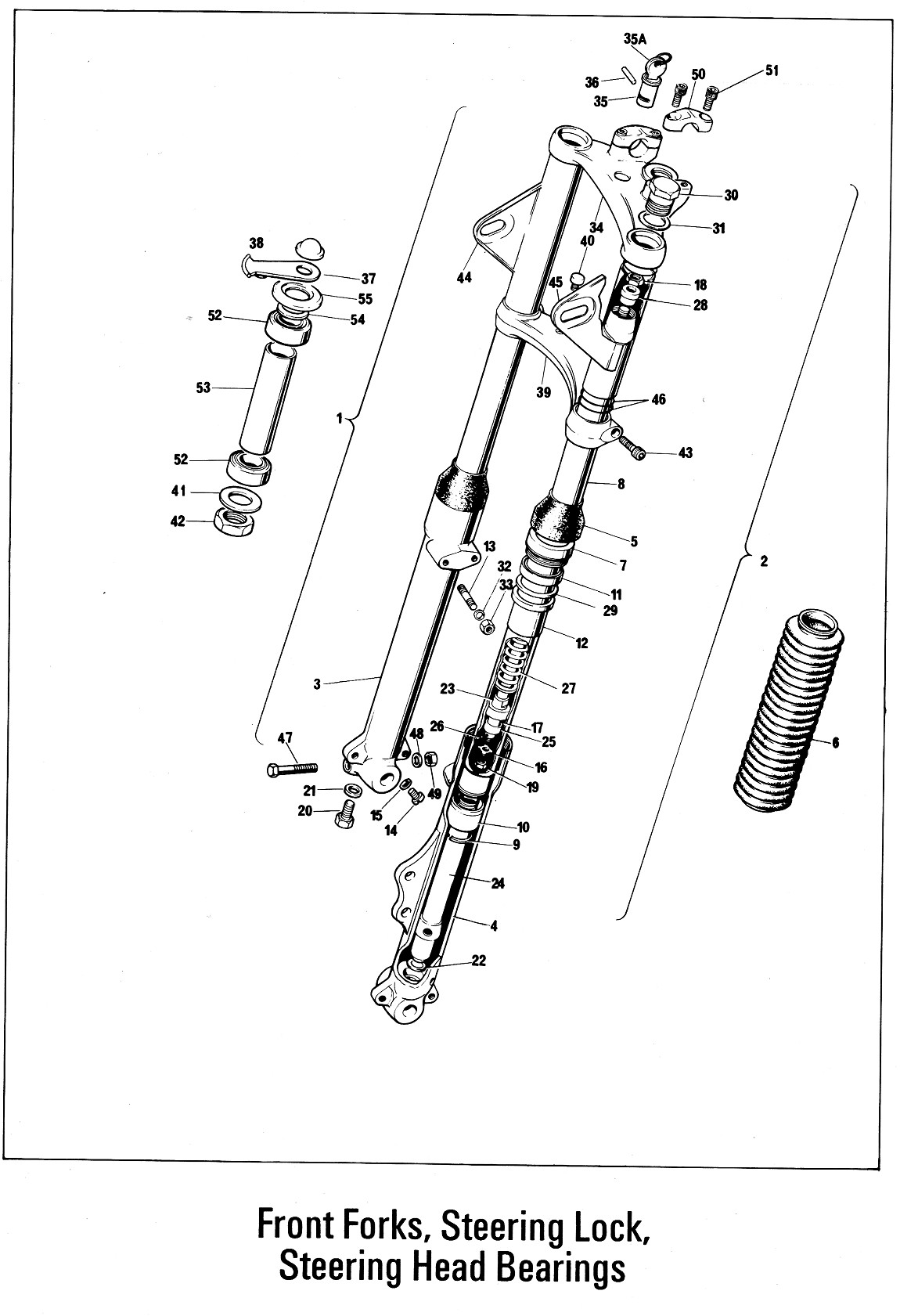

Can someone please tell me how the steering lock is supposed to be held into the top yoke?  Is there a circlip or is it supposed to be a combination of friction fit and gravity?

Interestingly the AN parts catalogue doesn't show such a roll pin.

On my 74 Mk2 850, there is no roll pin, or hole to put one. Lock is retained in the top yoke by friction/gravity. (And a little bit of glue at the moment.)

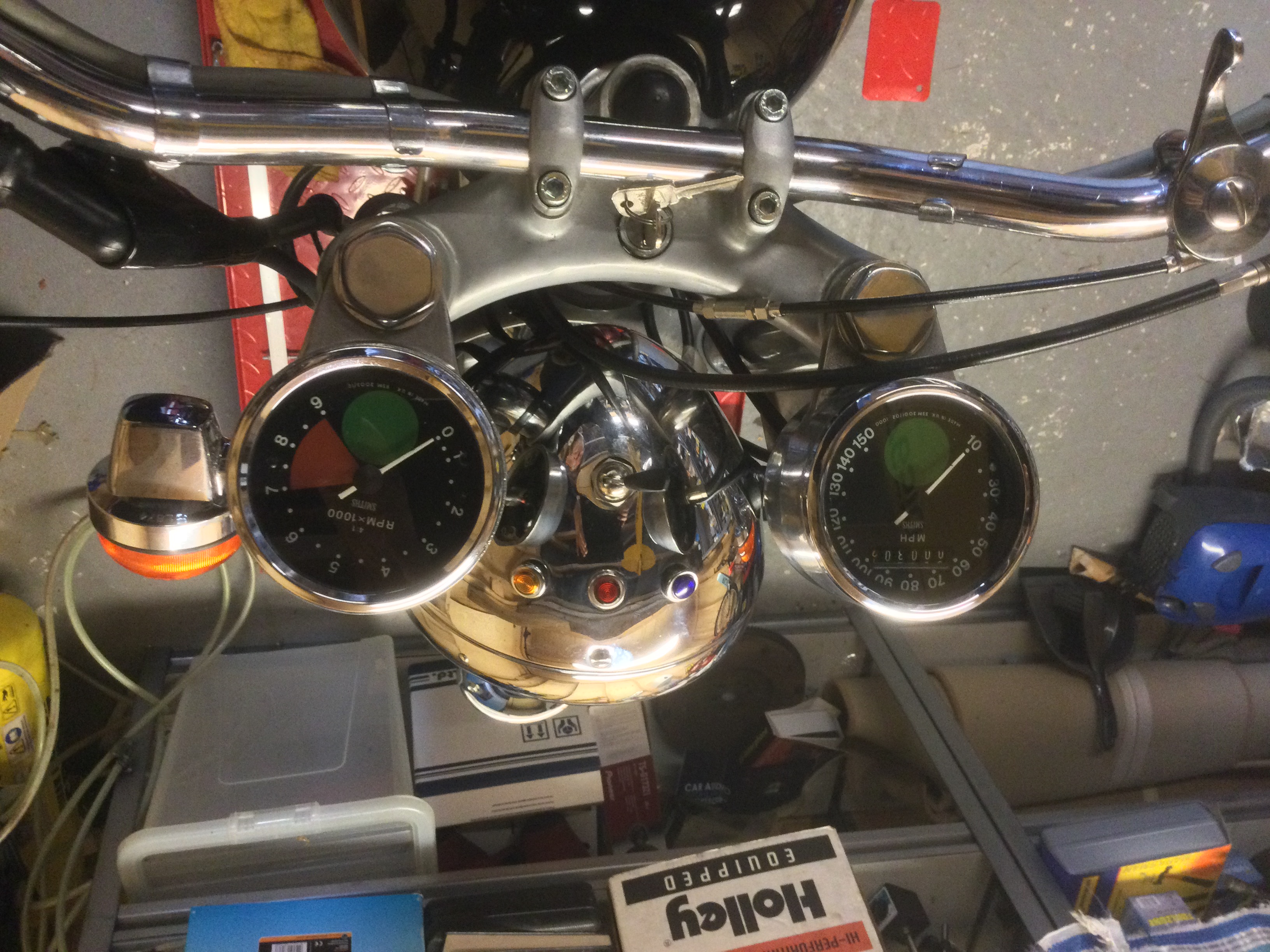

I just pulled the steering locks from both my 72 Roadster and my 74 Interstate (mk2a) - neither yoke (nor lock) is drilled to accept a roll pin........should they be??
Roll pin only fitted on 850 mk3.
I didn't like the stumpy little roll pin used for the Mk3; awkward to fit and crude. I had to remove a keyless old lock by drifting it out, thereby shearing the roll pn. I tapped the roll pin hole with an M3.5 thread and fitted an Allen grub screw with thread locker.  The grub screw works perfectly, so if there is any concern about retaining locks on earlier models, perhaps drilling a hole in the yoke and fitting one would be a solution?
