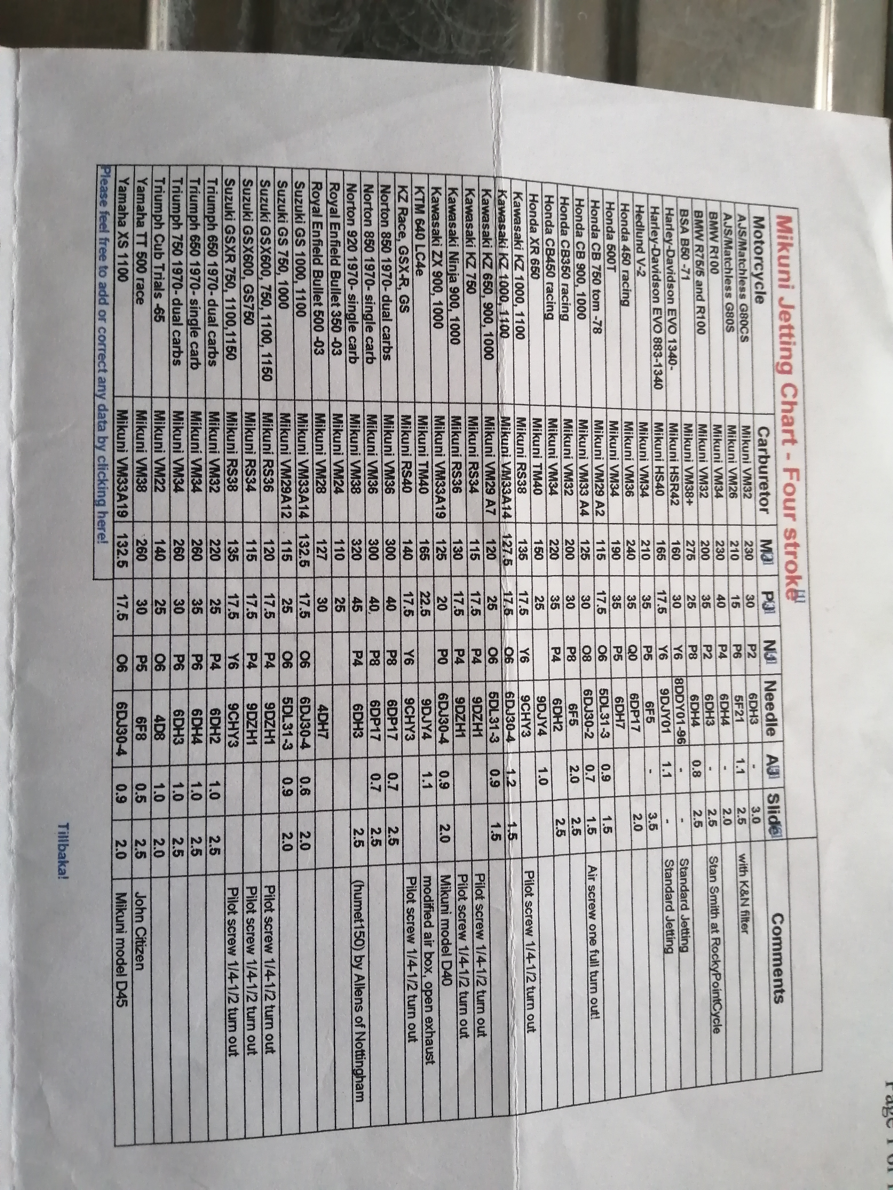

My kit came from allen performance
Heres a useful guide hopefully
Steve
