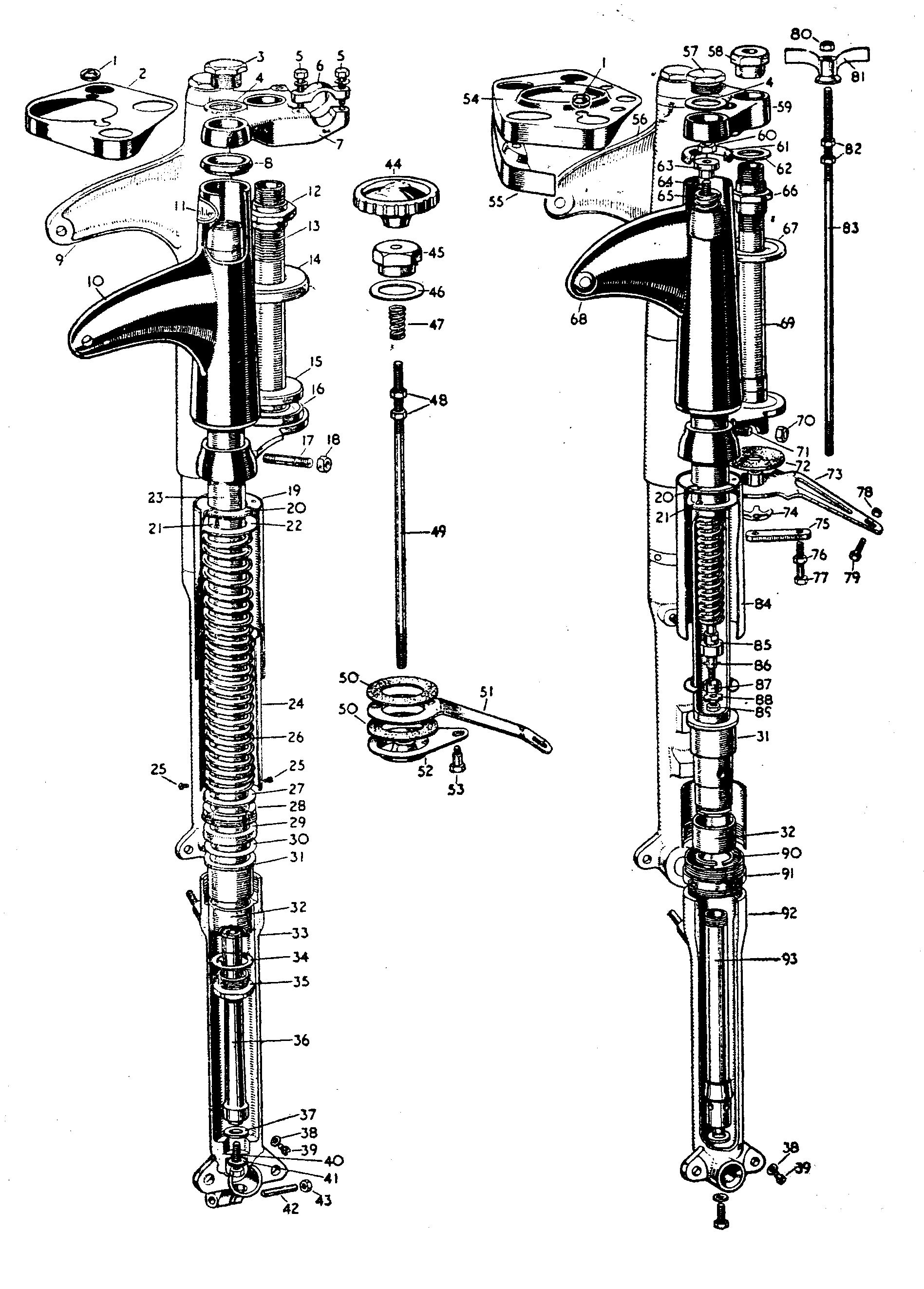

Roadholder forks - Which are the best internal or external springs for my 1956 Norton Dominator?
Internal springs suffer from condensation, the rust gets into the oil to create grinding paste, hence if possible go external or change the fork oil frequently.

I would have thought a '56 bike would have external springs. If it does have external and you wanted to use internal you would also have to buy all the damper parts as they are different. There is nothing fundamentally wrong with either. If your internal springs are rusting there is a problem, they don't rust habitually.

They were not designed to be air tight, as an example the stanchion does not finish at the top of the taper in the top yoke, this is to ensure a properly torqued top nut applies all of the force to the taper but it leaves a gap. That leaves two routes for air, down through the taper and up past the top fork nut. Ask Velocette how well their dowty air forks went in service, they lasted 6 years in production before they gave up and reverted to normal sprung forks. As for my forks I have the added issue of the clock holders being held onto the bike using the fork top nuts, adding another joint for leaks. I am sure you can get them air tight with additional O rings and as you have done with an alloy instead of steel top nut washer and careful assembly, but they are still forks not designed to be air tight, unlike modern forks with no taper and an integrated O ring in the top nut which when fully seated leaves no gap, double lipped fork seals, fork seal protectors and bottom bolts with copper washers that do retain air (but I replace this with a dowty washer).
