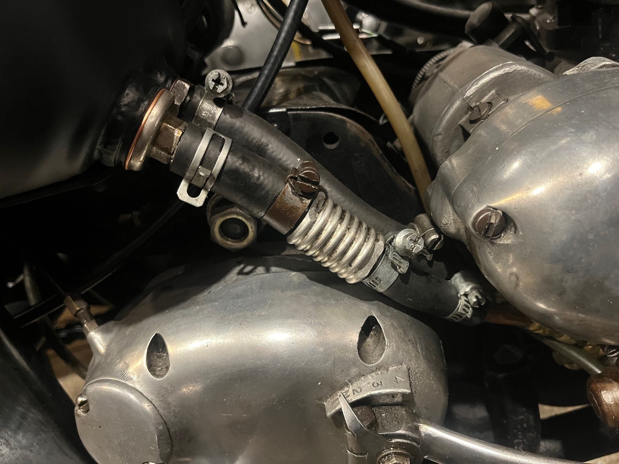

I have an anti wet sump valve courtesy of RGM on my Atlas.
I've just emptied the oil tank and sump in lieu of an oil change and realised the pump will be dry unless I prime it before starting the engine. Obviously, with the valve in place no oil will gravitate down into the pump when I fill the tank up. I suppose I'll have to remove the valve again and pour engine oil into the oil union pipe, or is there another way?

TBH, I'm probably overthinking this. I'll just remove the RGM valve, prime the oil union feed pipe and quit waffling.
It is important...
... to ensure that the pipe feeding the pump is full of oil and has no bubbles otherwise the pump can cavitate. Velocette singles, which have a valve as standard, stress this in their maintenance manuals. So priming as you suggest is a good idea.

Problem solved! I filled up…
Problem solved!
I filled up with oil and she started first kick! A bit easier too this time cos I've replaced the old kickstart lever that had dodgy splines with a brand spanking new one. Within a few seconds of the engine running oil was coursing up through the transparent tappet feed line and then spurting back into the oil tank. New crush washers on the tank spigots too. No leaks. Luvly!
I think my initial fears about the oil pump being worn were unfounded. There's a good strong flow of return oil coming back into the tank even when the engine is ticking over.
