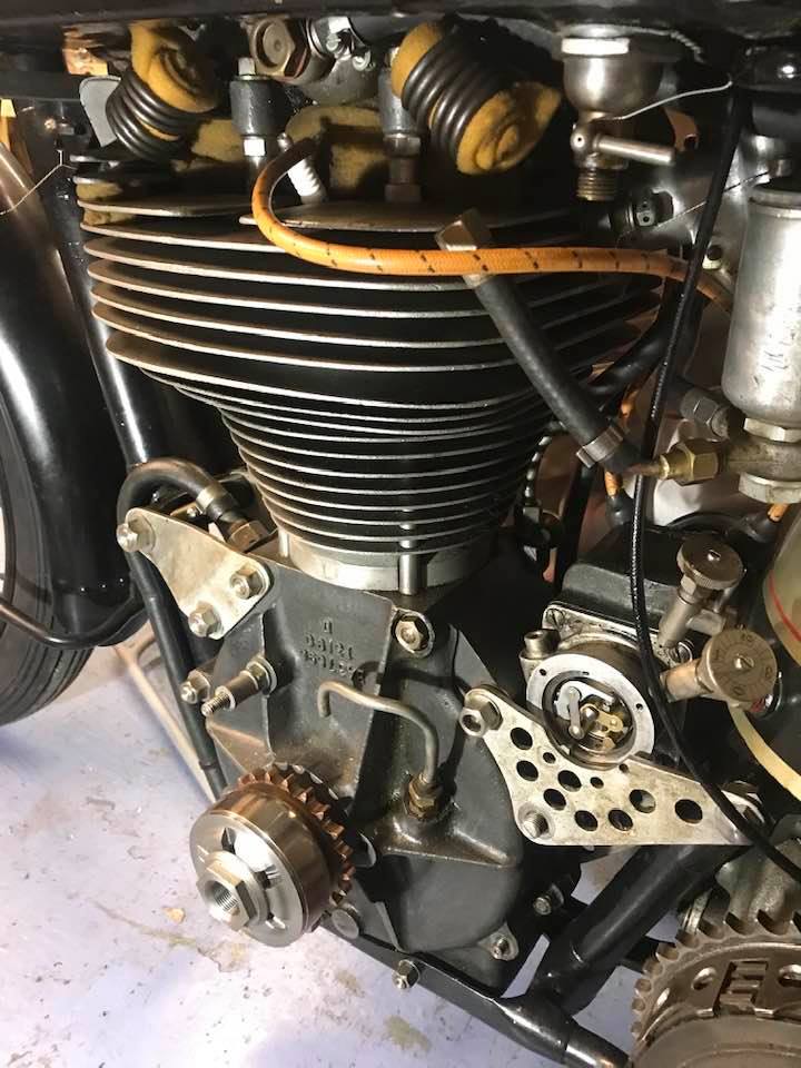

years ago back in the 1980s I remember looking at Inters and manx nortons at brands hatch and a lot of them had some type of foam inserted through the hairspring valves.
Was this an attempt to mop up oil leaks ?
If so can anyone suggest if this is a reasonable remedy (although not pleasing on the eye).
I'd also be interested to know on how much foam to use, and where to secure it to the springs and give it a go on my inter.

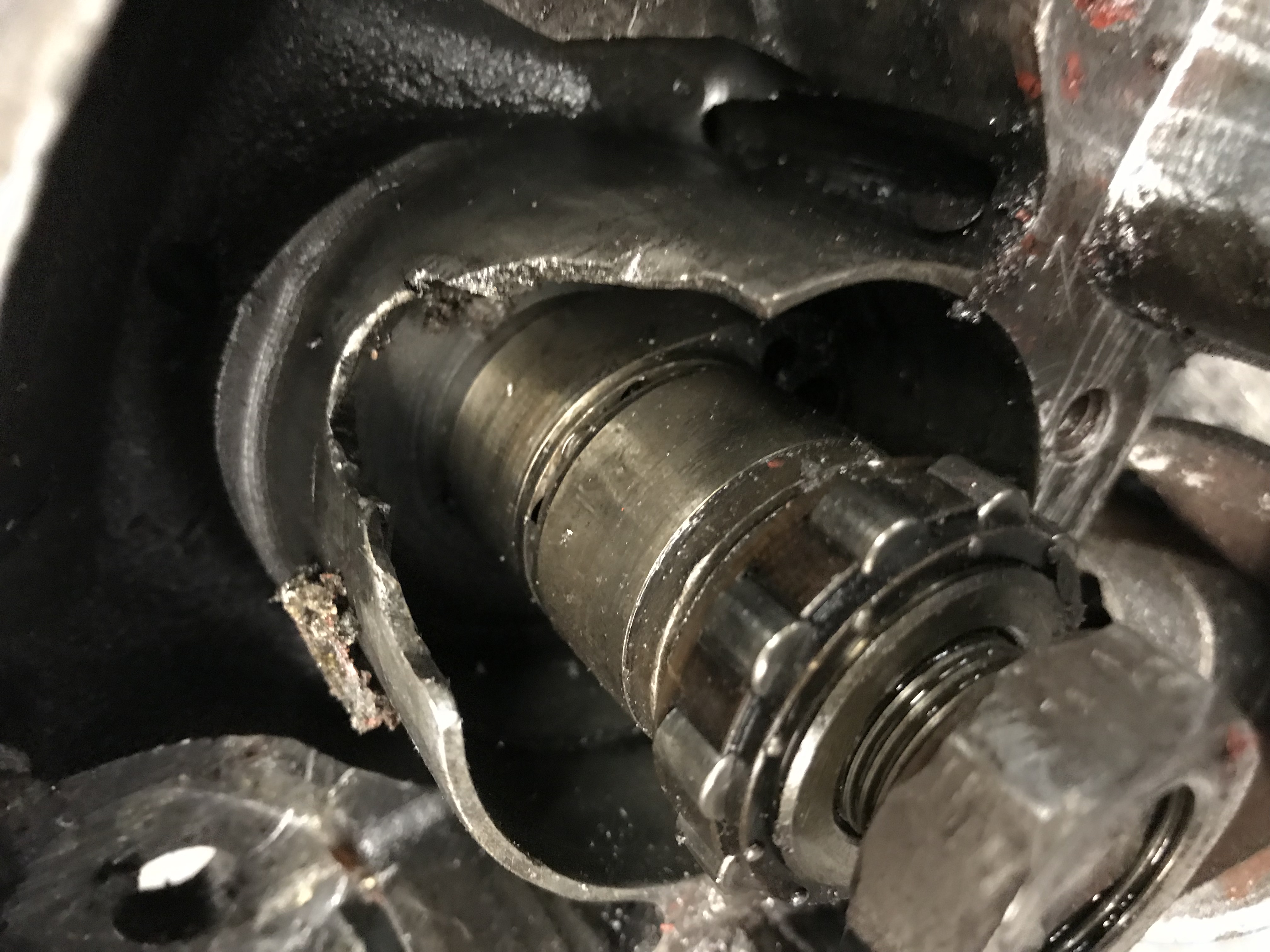

Mark, Check your cambox…
Mark,
Check your cambox tunnel is not broken, common problem on these OHC engines (bad maintenance and worn rocker pads cause the rockers to hit the camshaft tunnel and break it off.
Picture of one my engines with foam fitted and a camber with cracked tunnel.

Ouch! Dan - that looks…
Ouch!
Dan - that looks frightening as well as expensive. I must admit I have never checked mine but would have though additional noises would be prominent if it had broken/collapsed.
In fairness, its leakage in use, weeping down the fins but castrol R is a bugger to clean off the engine, - impossible when it gets on the exhaust .
Ill try the foam. and work a way of positioning it where it looks like its doing something productive.

As far as I can work out,…
As far as I can work out, the tunnel is more important if the oil feed is not pumped into the end of the shaft. With the race bike feed is the oil bath it provides really needed? It's all very well talking about damage being a maintenance issue, but how many owners strip the cam box just for fun? Is this damage less likely with the racing type end feed, I wonder? (Ps this is Speculation...)
Still used on race bikes with hairpin springs. Presume they get sponges from the kitchen, without wife knowing. I think you make a hole for the valve stem and cut a slit and then push it in place. Never thought much about it, as mine last ran with hairpin springs in -61. Don't think it's a total remedy, but it makes the bike less prone to oiling the rear tyre. Anyhow, cheap and easy to try.
