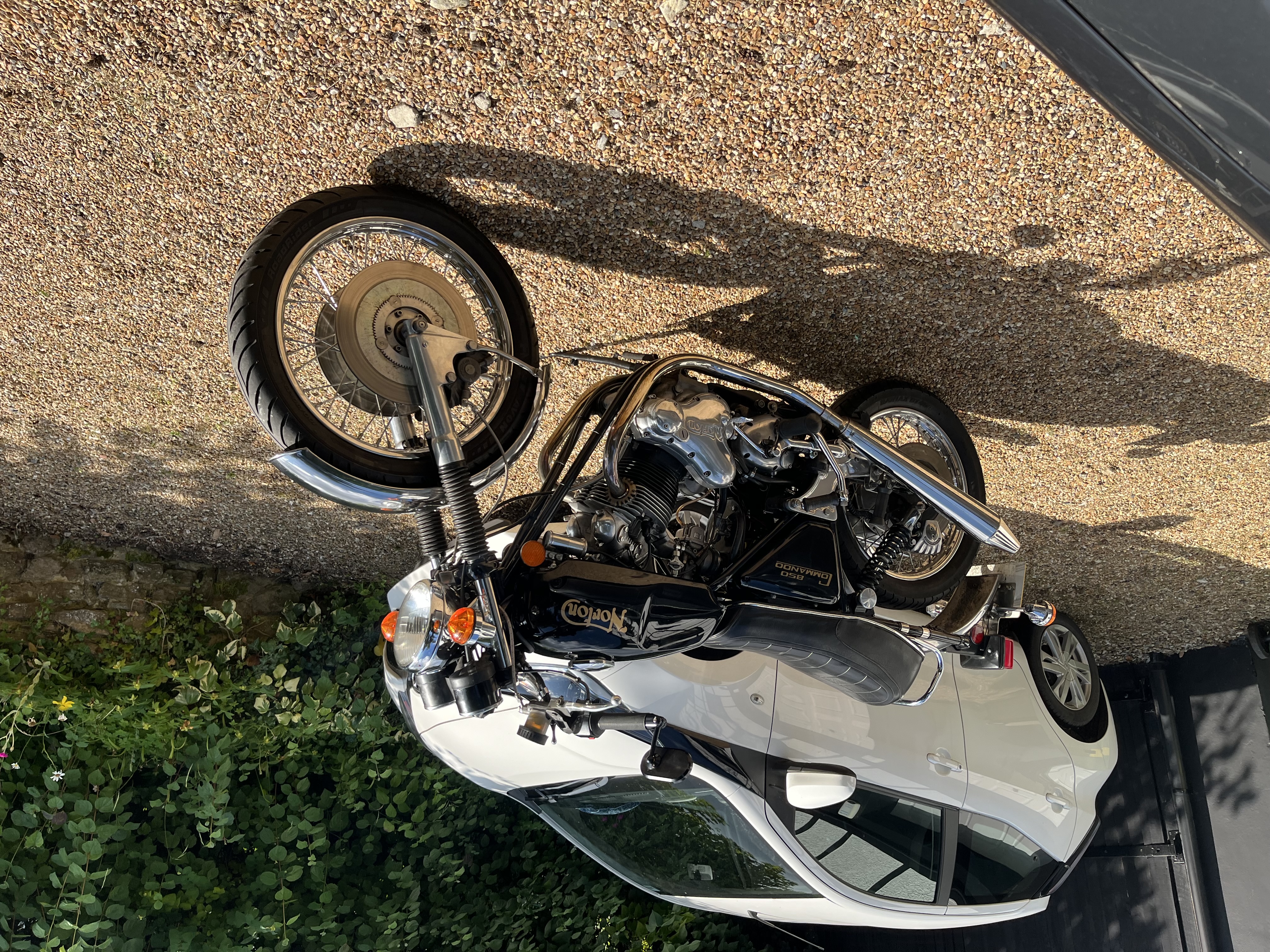

Peter, I'd love to hear how you got on, and a photo or two of the completed project?
I understood that one of the problems faced with fitting a 12" floating disc was that the disc runs very close to the slider?
Hi James
No. In the end, I sold that bike (for all sorts of other reasons) and bought a Mk3 that already had twin discs. These disc carriers also run very close to the slider (approx 5 thou) - but all seems OK and the brake works very well.
Thanks for the response Peter - looking good!  Looks a mighty set-up, and wont have been cheap.  A photo' is always a bonus.
