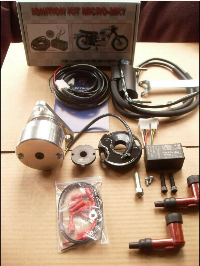

Has anyone fitted one of these kits. A mate called Brian is removing his magneto (with some difficulty - that bottom mounting bolt!!) and wants to replace it with this kit.
He would like to hear from you with any hints, tips or tricks you learned - and especially if you are in the W Yorks area. If you write to me at lighttwins@nortonownersclub.org - I will pass on your details/info - or drop me a note on FB Messenger

The electronics portion of the kit is made by Vape and they have a good reputation, don't know about the rest of the kit ie the Magneto mount as not used them. Connectors are naff too.

As John says the electrical components in the kit are from Vape (Czech Republic).
Power Dynamo use Vape components, so this may be one of their kits, if so I can vouch for the quality as I have two bikes fitted with Power Dynamo/Vape kits.
As Al mentions ratchet crimp pliers are the only way to go with the connectors supplied in the kit.
Good luck

I recently fitted a similar kit to a customer's Tri****. The only difference was that it was the kit with a dummy 'magneto' housing. It's simple enough to fit, the biggest difficulty was deciding where and how to fit the coil and 'black box'. His bike had manual adv/ret so the cable was retained just for looks, but, as others have said, you'll have to find a way of locking the adv/ret unit or find a suitable plain mag sprocket - (Dunstall used to do them so they're out there somewhere) - not sure if one from a single would do, can't remember how many teeth! As Alan Osbourne says, ditch the crappy connectors, I used Jap style 3mm bullet connectors and a proper crimp tool. So far, the customer is very happy with the result - I guess only time will tell how reliable it'll be.

Me? 20+ years ago when I got my 650 mongrel, it had a mag that didn't spark. I didn't have any hesitation in removing it and selling it on and replacing it with a 'mushroom'. I have no regrets, although like other posters I fitted proper wiring connectors, not the hideous red/yellow/blue "crimp" connectors that came with it.

I am from Czech republic where Vape is produced and i can sai that is better made than Boyer i have Vape on my Jawa bikes many years and it works perfect. i have boyer on my commando it works but mashine procesing is better on Vape. I thing that vape have some details make precision than boyer.

Observations-Despite being 'in the business' I have not seen this kit before, but two things if it is a Wassell sold product there will not be any technical back up. The connectors are the nasty red things that look nasty, often fitted with a 50P crimper-the result being 50P! IF you crimp these with a proper ratchet crimper they might be ok (but still look crap).
You can buy a 'Mushroom' housing and fit Boyer or Pazon. Or even search out the Lucas RITA magneto replacement kit. I have spares for every part, but not the housing.
