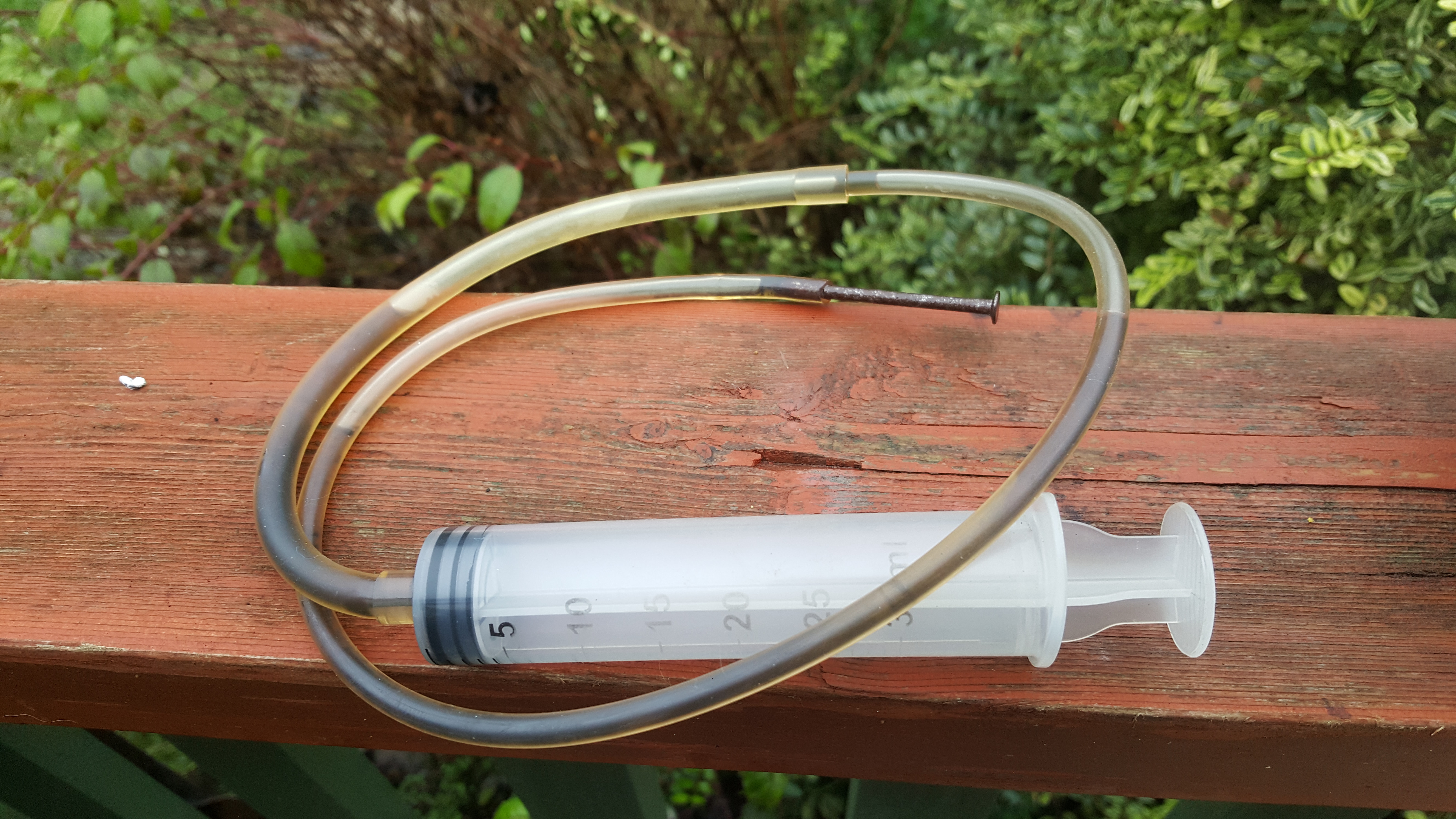

I have attached a photo of the syringe and tube I use. If the oil is warm I reckon I get over 80% of the oil out. Leave it a few days and the rest of the oil has probably dripped out. If you know somebody dealing with medical stuff you'll be able to get hold of the bits.
       Jon.
Also used the same syringes - perfect for fork oil levels too.
If you do use them, make sure you leave them apart and cleaned of oil. Else the rubber part will swell up and jam in the body.
If you do this, then you will get many uses from one of them.
