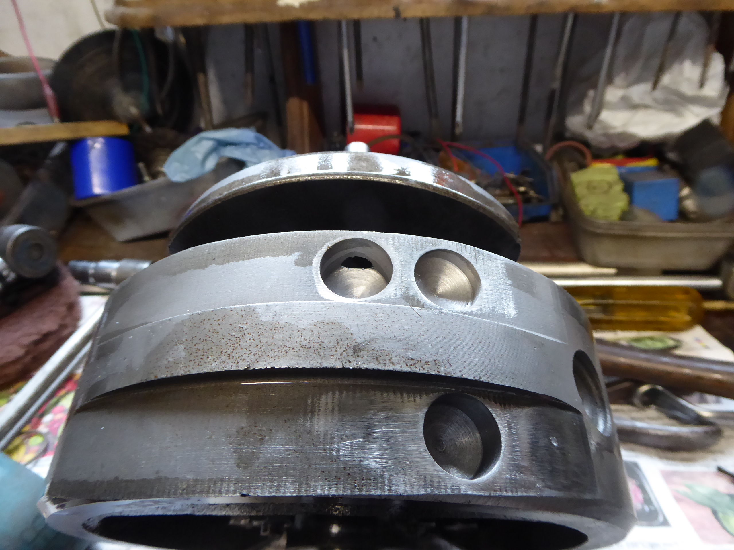

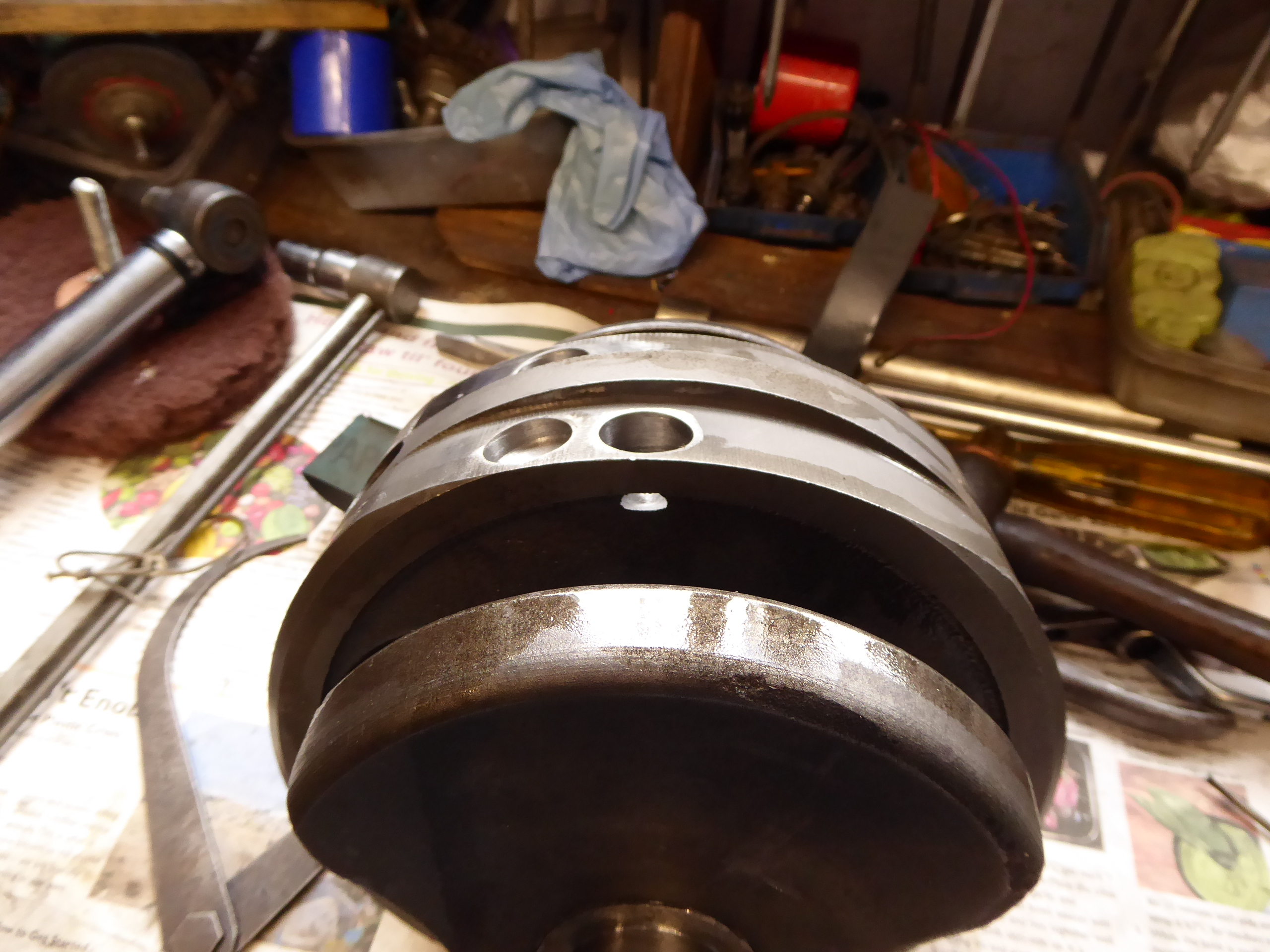

I have just had my 650 rebored for a pair of new +40" Gandini Pistons which were miles heavier than the original +20" Hepolites (Heplexes).
While the engine was apart I took out the crankshaft and had it rebalanced to match the new pistons. Checkout the photos to see what I consider some very shoddy engineering. When I complained I was informed that this often happened with Norton flywheels.
RE crankshaft rebalance
Looking at the photos, am i correct in saying that the weight has been removed from opposite the crank pins? Using heavier pistons surely the weight should have been taken from around the crank pins/area. That is if you wanted the same balance factor as standard. What balance factor did you want the crank to be balanced to?

That was my first thought. So I asked about the balance factor used and was quoted 68%. I was expecting the answer to be 72%.
It also struck me that rather than drilling holes everywhere the engineer could have just ground the centre rib off similar to a 750 crankshaft.
Anyway......the motor is all back together and definitely runs a lot smoother. Now it is just a question of a putting up with a 1000 miles of running-in.
