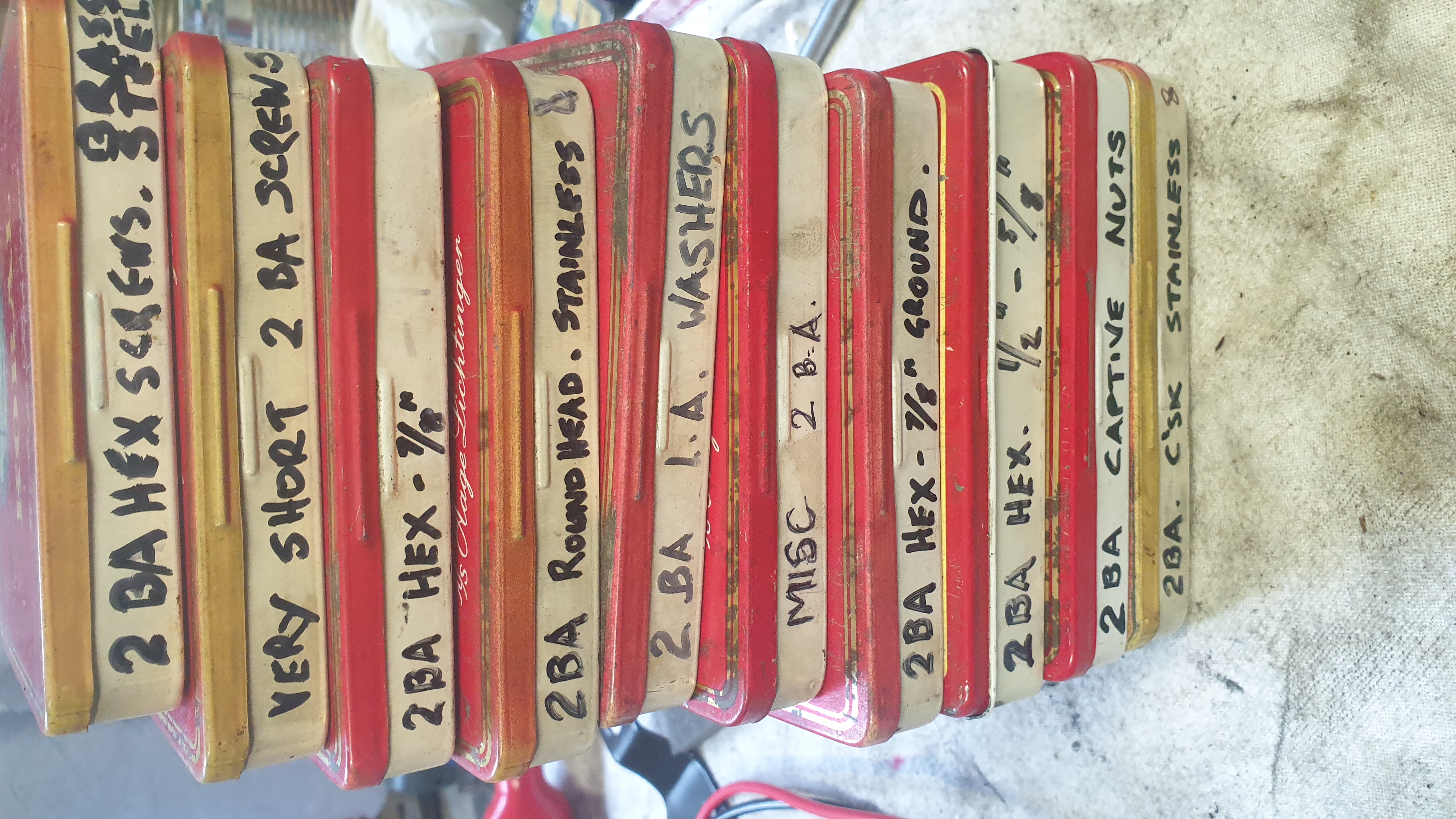

I am the proud owner of…
I am the proud owner of possibly the world's largest amateur collection of 2BA nuts, bolts and washers. Not one has a cross head of either pattern. I must now search for even more...
I seem to remember using blutak last time I fitted the shrouds, and although I cannot now remember I do believe they were cross headed. I also know that at least one has a thin shim washer between the top plate of the shroud and the fork. Otherwise that one does not sit square enough to avoid dragging its lower edge on the forks. Perhaps due to a knock...perhaps out of square when made.
