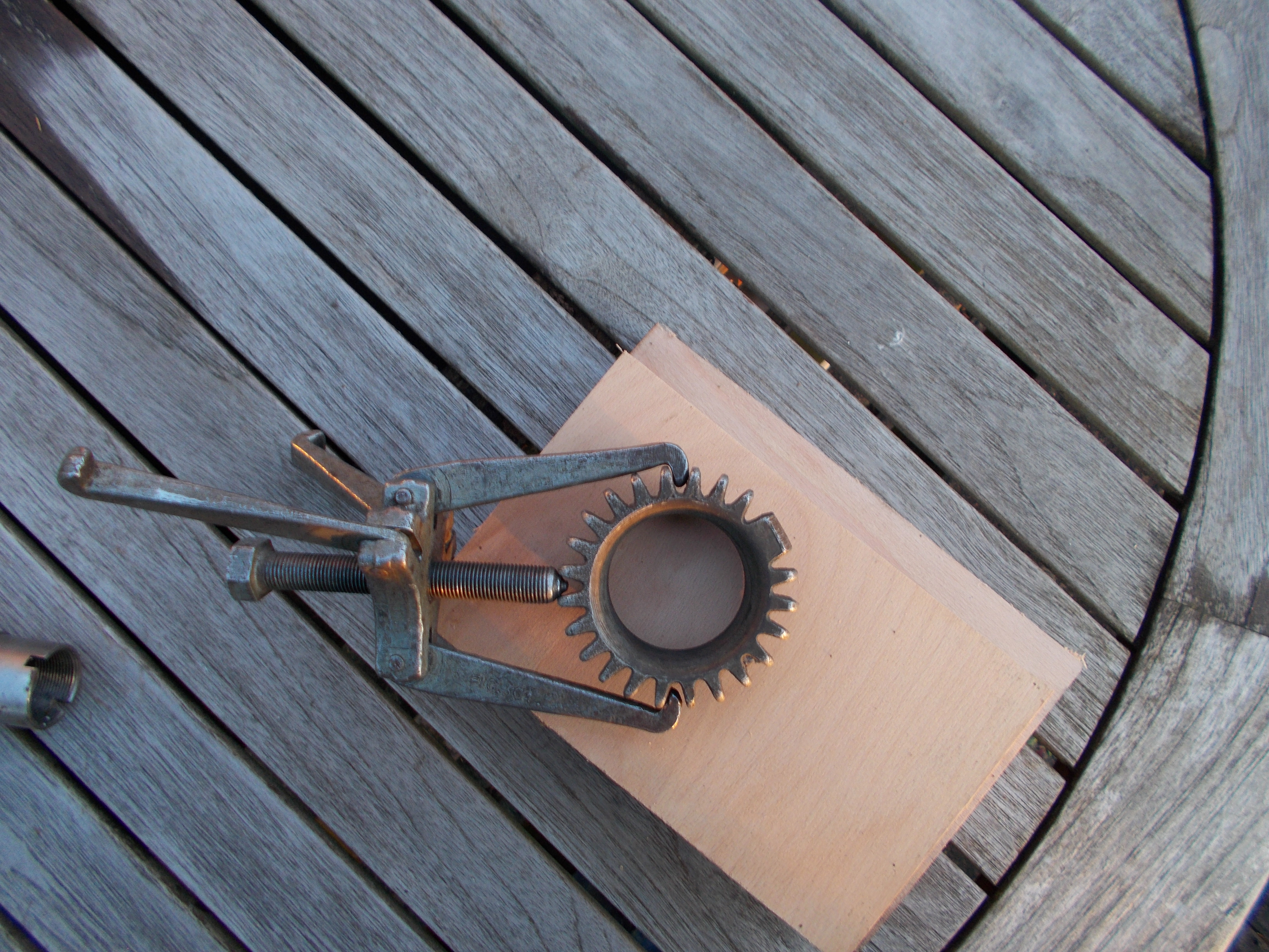

Hi Doug,
All good advice above, but what I have found to be a good tool to undo the exhaust ring is a 2 leg sprocket extractor. The type you need is with the long legs held by pins in the fixed section with the usual centre bolt. This needs to be a suitable size to fit the hook ends in the gaps between the fin gaps around the outside. You might need to file the hooks to be a good fit. Set them at 180 degrees to each other and tighten the centre bolt as much as possible with-out doing any damage. Get a suitable steel tube to go over the hexagon centre bolt, the tube can a couple of feet long, but you will need to protect the threads on the centre bolt and it could bend the bolt slightly. Run the engine or use a heat gun on the head and then give the tube a quick shove to crack the corrosion. The advantage of this is that the ring is gripped at 3 points and you have the leverage.
Exhaust ring removal.
Hi Ian/Doug,
Sorry, I didn't explain that very well. I should have just said that I use the sprocket puller like you would a "C" spanner. This has a better contact and more even force on the fins to spread the pressure. I have attached a couple of photos, the puller in these is a combination 2 or 3 leg type, so ignore the 2 legs not in use. A long tube can be used on the centre bolt for leverage, but you need 2 half round aluminium sleeves (not shown) to protect the centre bolt threads.
