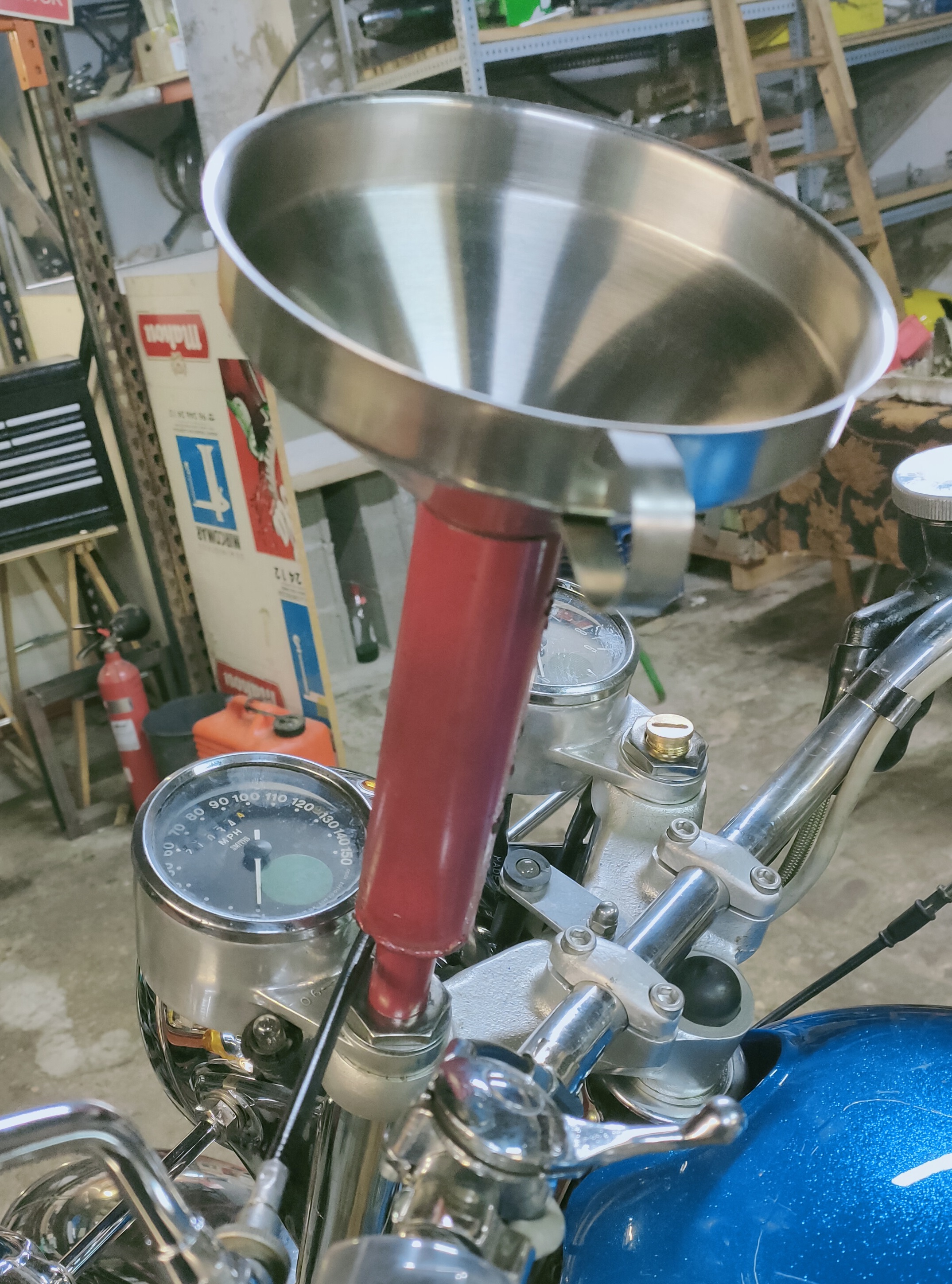

If you have the facilities (or can cadge...) a couple of old fork nuts bored through and with a length of tube welded on top make the job much easier...It doesn't make the job any faster but it does mean that the correct amount can be poured into each leg and then left to get on with it.

Yes Richard's way of doing it is very suitable. I used it for time. But got tired even of that and bought some top nuts  with integrated part you only have to open to fill in without need of taking off the clocks etc.
It was offered time ago in Roadholder, but I will need to search in my invoices for supplier.
