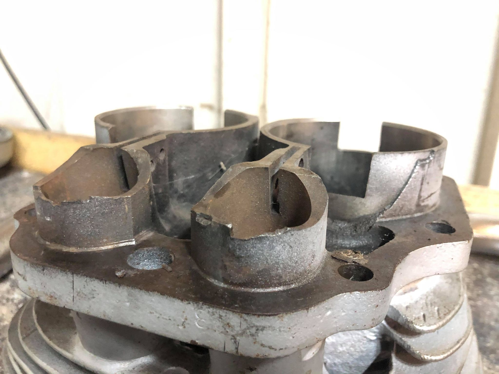

Hi everyone, I am new to the norton commando world and I’m currently piecing together an engine
I have a couple of questions:
Firstly, the cam followers have their own cyinder/port in which they fit, however this area looks to me to have some damage around the edges - am i correct and does this make the cylinders scrap? see attatched photo.

The damage to the cam follower tunnels is probably only superficial and would respond to being dressed back to a smooth non-stressed edge.
I'd be more worried though about the damage to the extremely thin remaining spigot where the 750 bores have been sleeved. You can see where a large part of the radius has broken away.
If it was me, I'd fit new through-bolted (850 style) barrels from Andover Norton.
