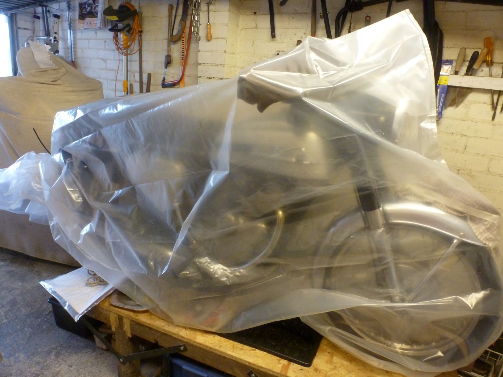

Yesterday I put my Electra into a regular sized motorcycle VAC-BAG. My first time of using one of these.
As the bike was on a raised table there was no chance of wheeling it into the bag. So I had to do it the difficult way threading it under front wheel and stand. No punctures.
Found it very hard to gather all the bag at the rear for the tie wrap provided.
Done.
Anyone else used one? And after about 24 hours the humidity indicator is as shown. Is this normal? Or will it get drier?

As John said, drying the desiccant in an oven before use is important, it it will already be partially saturated. Anyone who has worked with aero-engines or modules will be familiar with packing them in moisture and vapour proof bags - much heavier construction than a vacuum bag, with a moisture proof zip (that can be a pain to close). Normally, multiple bandoliers of dried desiccant bags are draped over the engine. The air does not get removed, so the desiccant has to deal with all the moisture in the air and engine. A paper humidity indicator placed in a window in the bag lets you know whether the desiccant has dried the air sufficiently, or the bag is properly sealed - blue safe and pink unsafe. You could easily stick one of these indicator sheets in the vacuum bag and it would let you know if the protection is working.

Hi John and Andrew,
Thank you for responding. As I tied the rear of the bag with the tie wrap I thought a sphincter large enough to pass a motorcycle was unlikely to end up airtight.
I followed the instruction and removed the dessicant bag from its heavy poly heat-sealed envelope and just shoved it under the bike within the VAC-BAG. Perhaps I should have put dessicant in an oven at 100 C for a while. Any hotter and the fabric wrap will probably melt away.
Good ideas and thank you. I will take dessicant out, dry in oven, and reseal for best result.

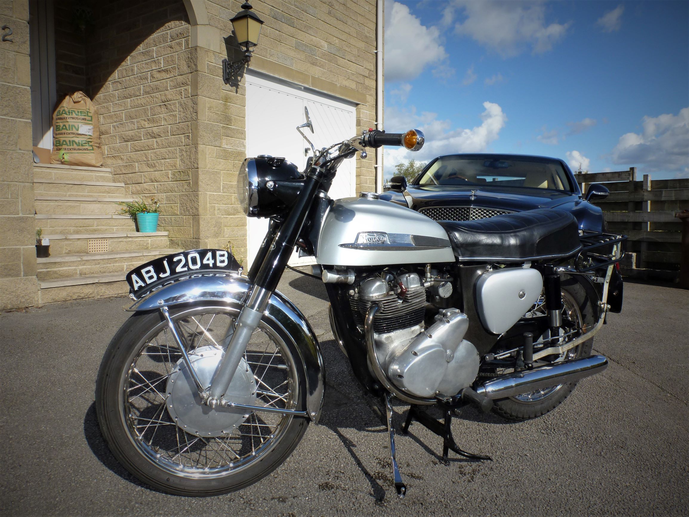

Like Colin above I have been pleased at the state of the bike after it's self isolation all winter in a VAC-BAG. My first try out and thanks for all your comments. I took the batteries out before sealing the bag.
I opened the bag end January and stuck my nose inside. Overwhelming petrol smell so for goodness sake never think of putting anything inside like a battery charger or a de-humidifier.
I put a fresh dessicant bag in too, but only because it seemed a sensible thing to do and I had one. Took the Norton out of the bag in April.
She looks great today don't you think?
