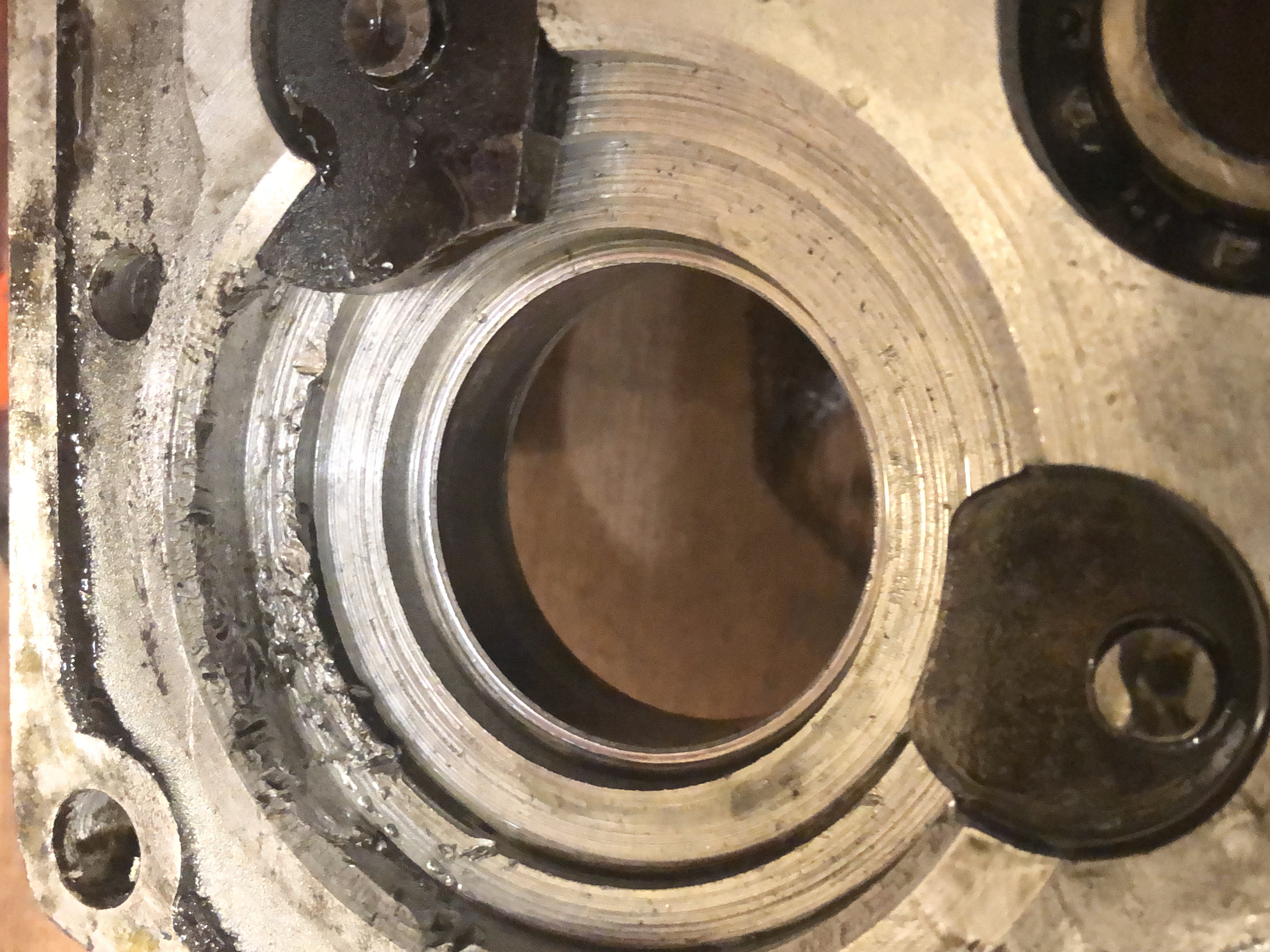

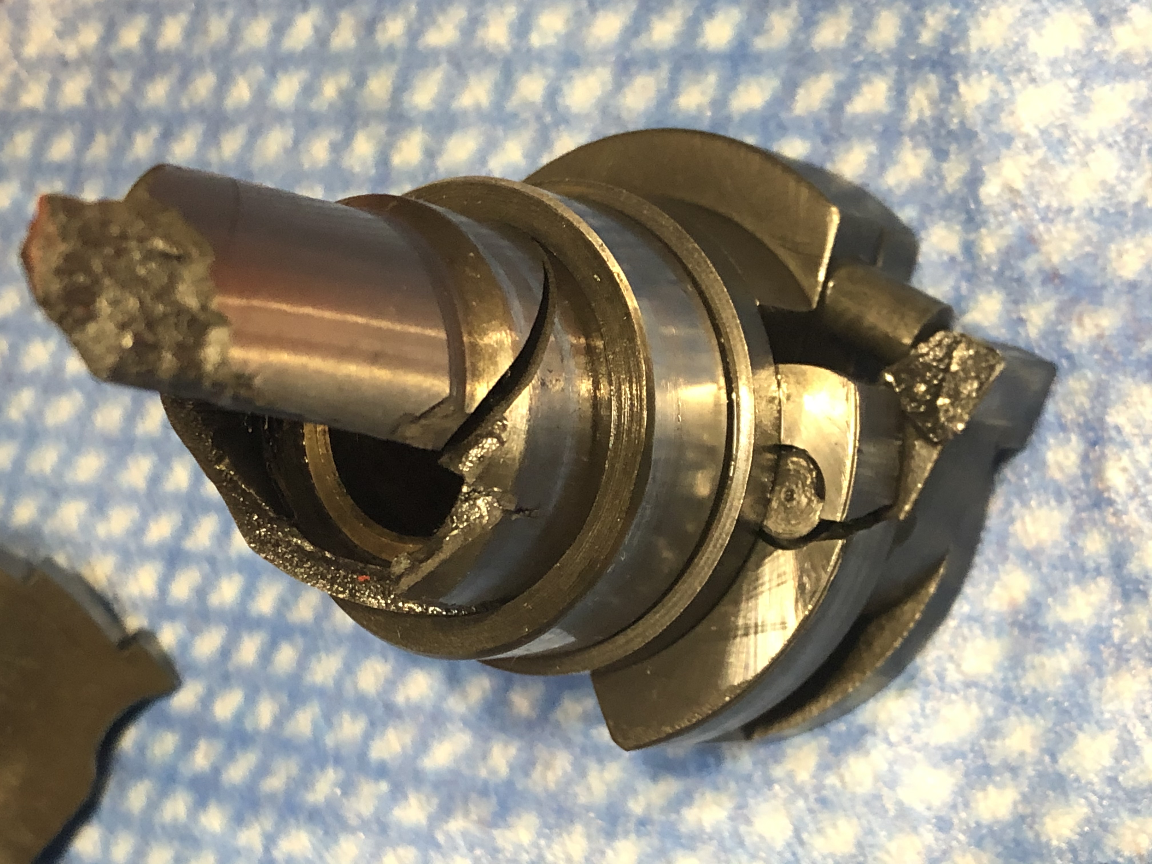

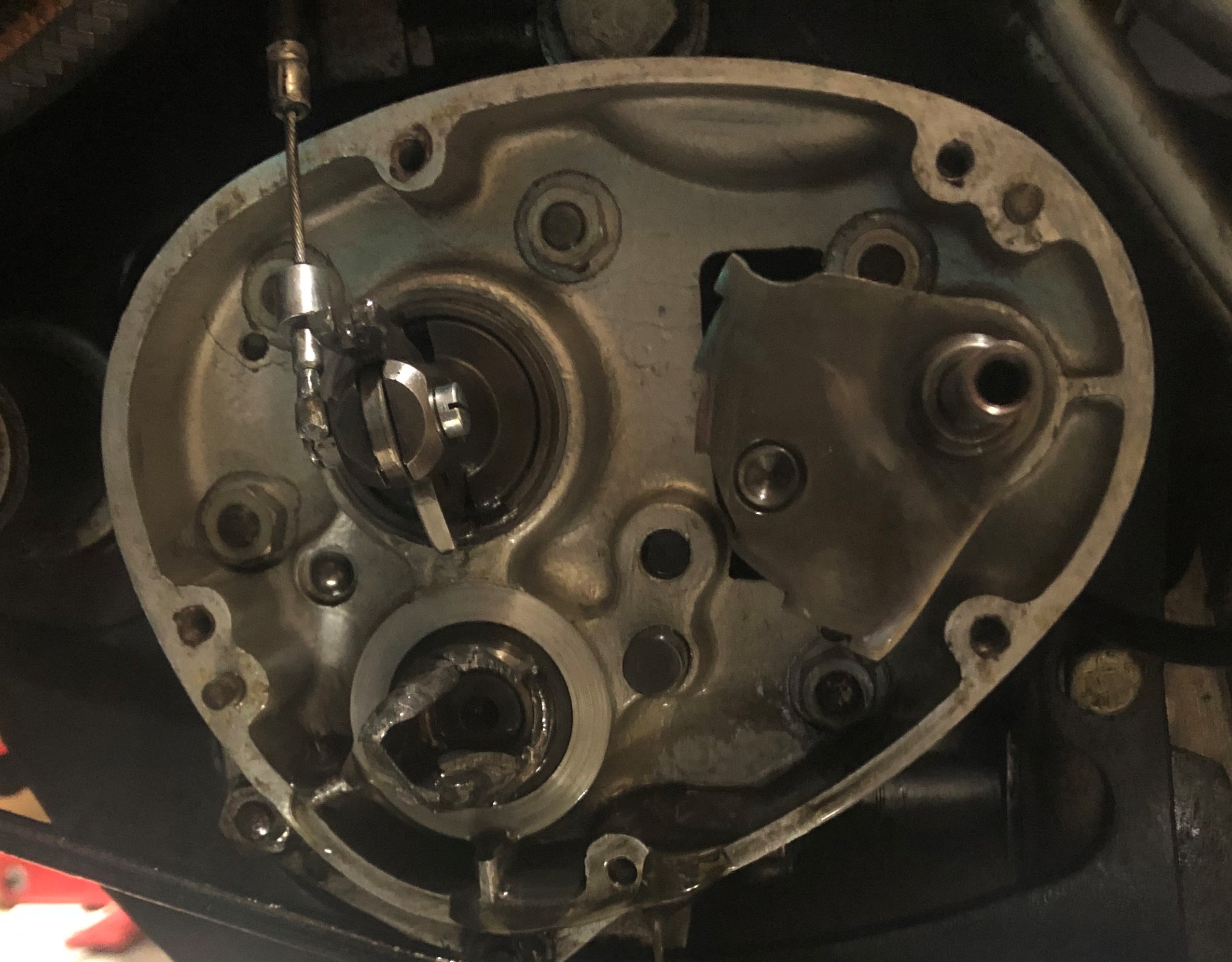

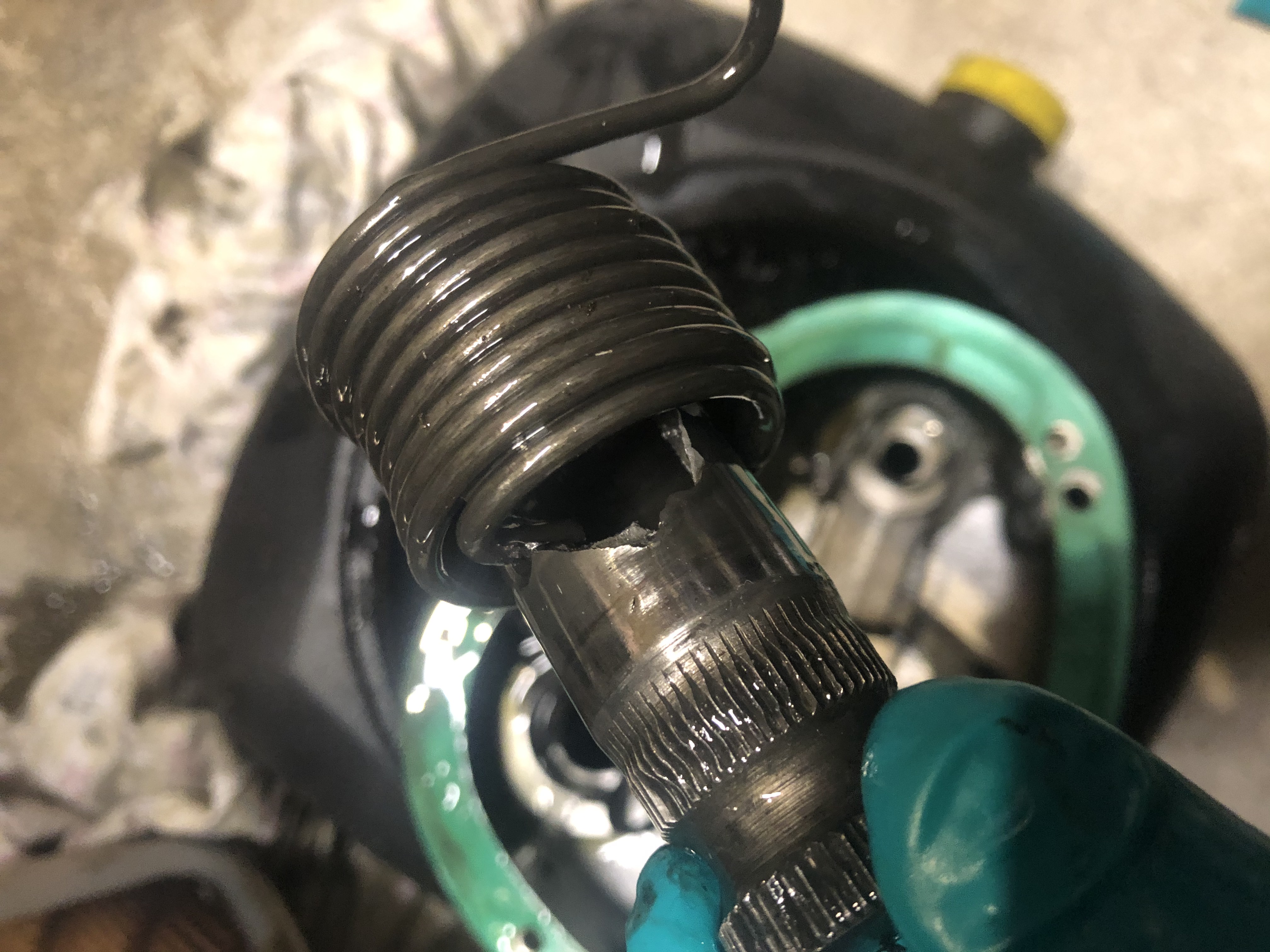

Just installed my shiny new exhuast system on my Roadster.  Thought I'd give her a kick and listen to the tone.  On the second kick I heard a crunching sound, definitely metal to metal.  This is what I found.  Looks like the kick starter shaft failed at the spring hole and caused a collapse which also wrecked the outer cover bearing and boss.
Is this something that happens?  What else should I consider when I am repairing this mess?

I've never seen that with an OE shaft and the distortion to the splines is suspicious too. The only common fault I think is a crack from the stress raiser on the internal quadrant to the drilling for the pawl pivot pin but I've never known it to be fatal.
Do you know who the supplier was ?

TBH I have limited history of the bike. It is Jan ‘72 but has a combat engine with 14k miles and was originally exported to the USA with the fibreglass tank etc. Last year it was brought home as a none runner, according to plates last registered in ‘79 for road use. Apart from louder exhaust she was standard. So assuming  she is standard. Oh and the kickstarter pedal was a dog to get off, maybe didn’t help.
Looks like its been made from steel coloured cheese.
Buying bikes as non runners is fraught with problems like this. It really is the luck of the draw. Unknown service history... For peace of mind, I would be tempted to do a full engine and gearbox strip to check that there isn't anything else waiting to let go. You really don't want a seizure, gearbox lockup etc when travelling at speed.

Not the first I have seen them fail like this. Another batch of these was seen earlier this year, it seems they run in a 3 year cycle, I get the odd one sent to me. Not sure where they are coming from, but have many deficiencies which easily gives them away. Just from looking at the photo I can see it is fake, not even a good copy. Most crack in the pawl area.
there is a lot of history about sub-standard parts on here and accessnorton. Usually, it comes down to buying from very few reputable sources, and even then , there are personal preferences over particular items.
   In general, it seems there are more badly made/specced items around on  other websites, which are cheaper to buy initially.......
Despite knowing the faults, we no longer highlight them as this effectively gives away how to make them. Not one company in the world lets their competitors know how to make items correctly, not even if they are deadly, as one NOC owner found out a couple of years ago.
I even watched the trail of them being made after our stock was slated for not being correct. It was not even a challenging item to manufacture, had they also tested a part from any of the leading global suppliers of these parts that are used on other motorcycles they would have spotted the error they could have avoided.

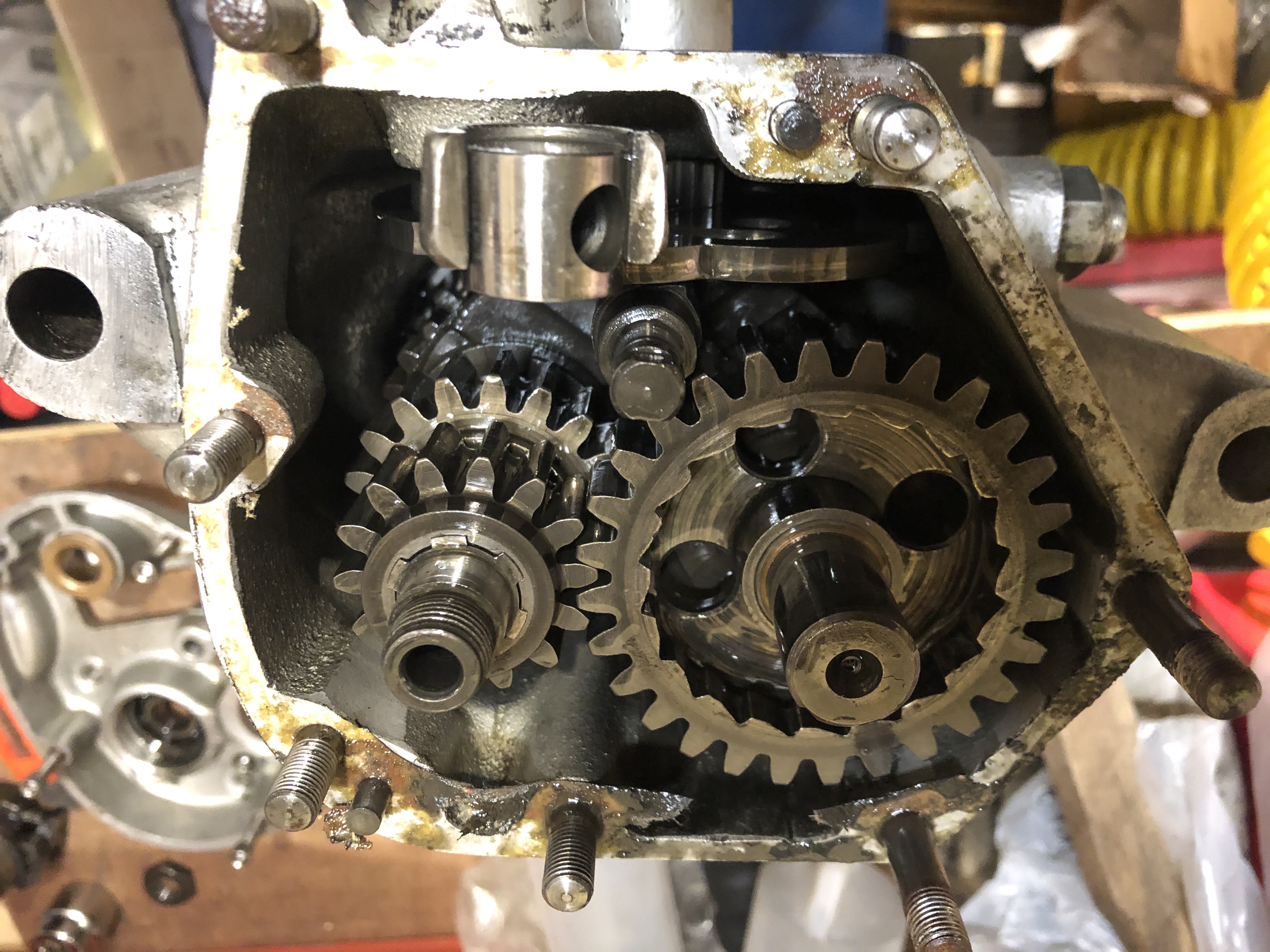

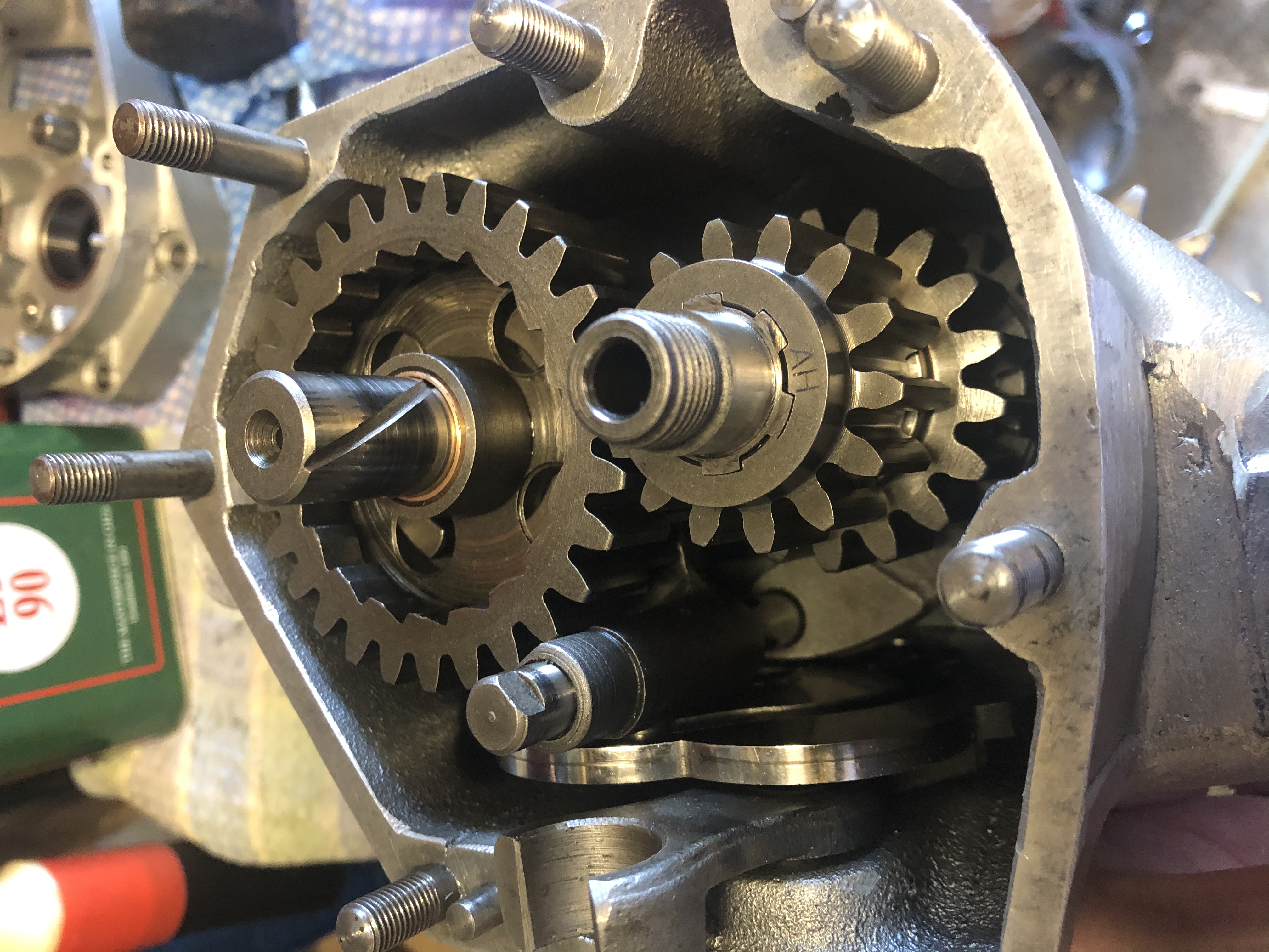

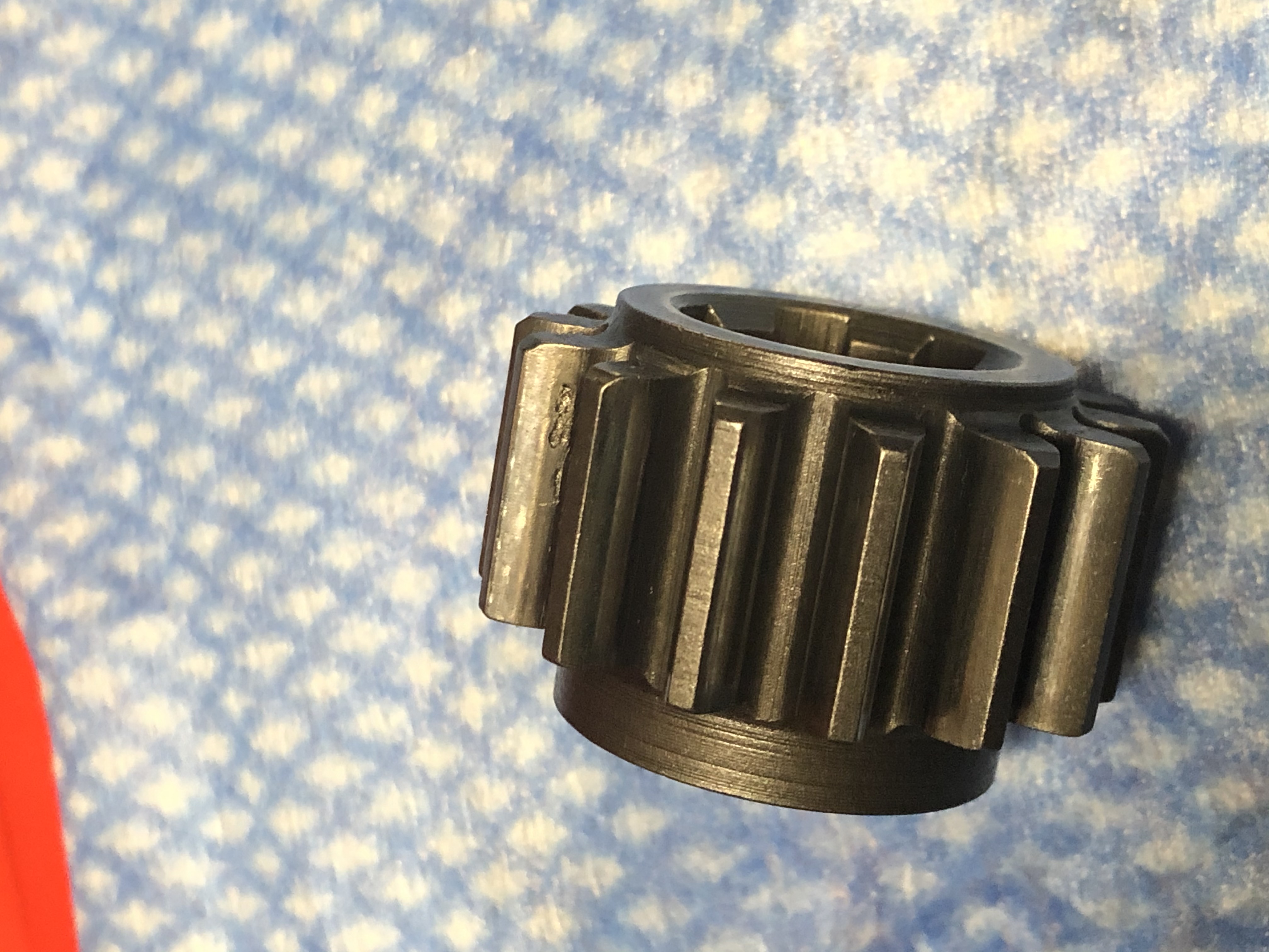

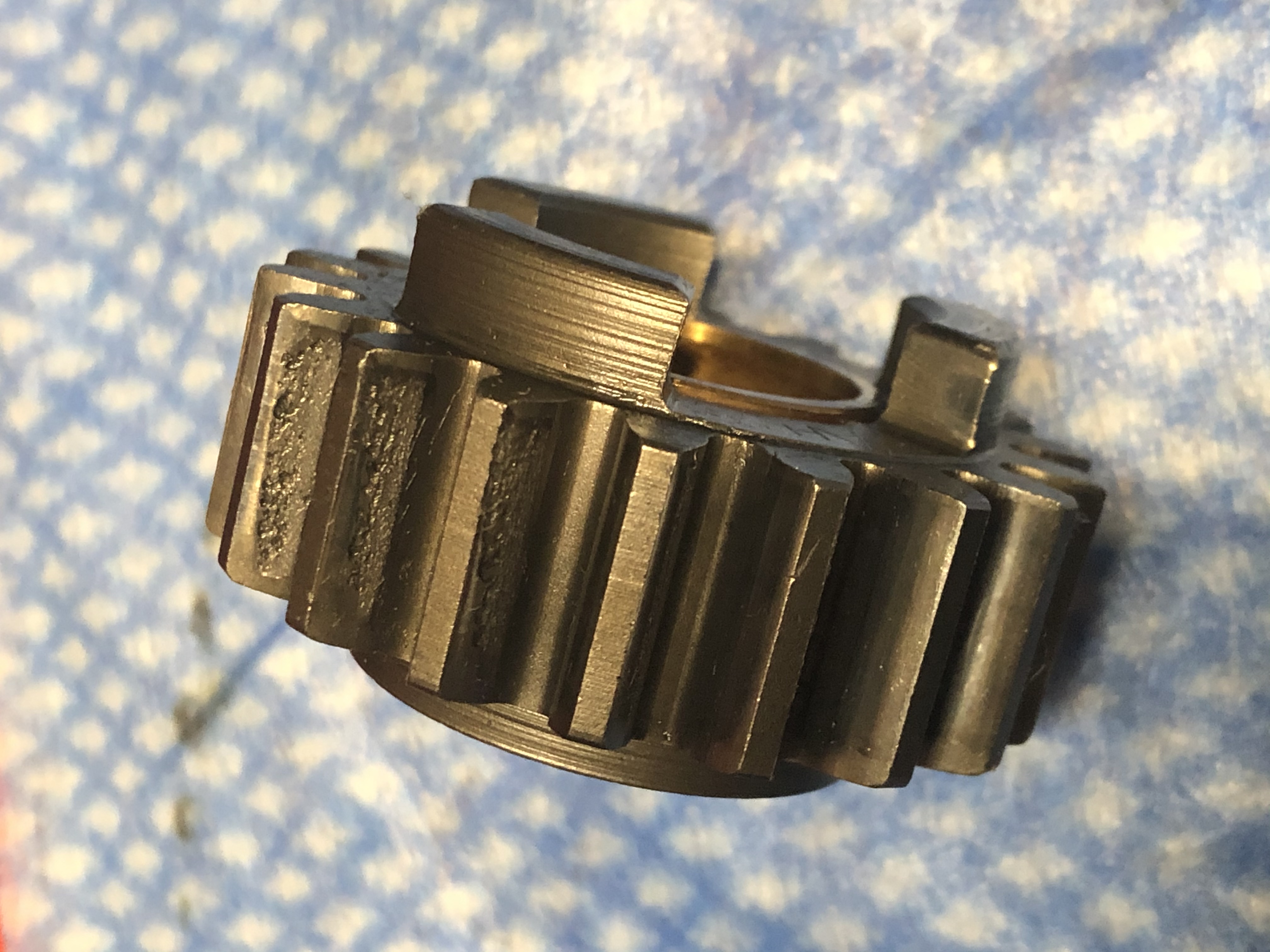

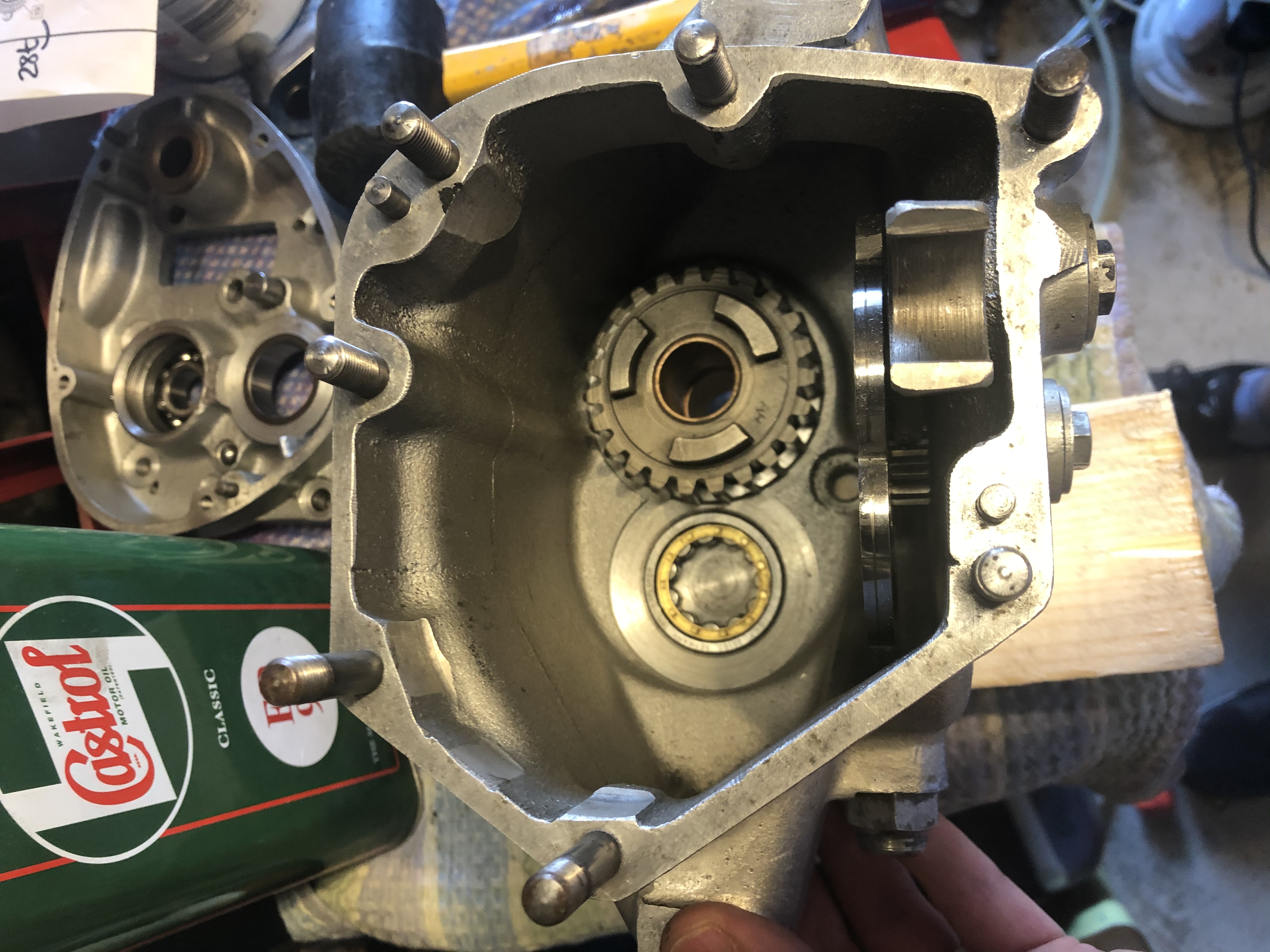

I managed to split the gearbox further, looking at the state on the gaskets and what it took to break the seal I reckon everything was still OE. Generally speaking the internals are in good shape apart from 1st and 2nd gear where there is some pitting where the teeth mesh, I will replace these.  The inner cover is also damaged from the kick start shaft failure, I am reluctant to replace circa £160+VAT just wondering if anyone has had such weld repaired and remachined/pressed insert, and if this is economically viable?
Gearbox open
Problem item
Problem item...notice that the came with it.
1st gear2nd gear
Inside inner gearbox cover
Opinions on repairability?

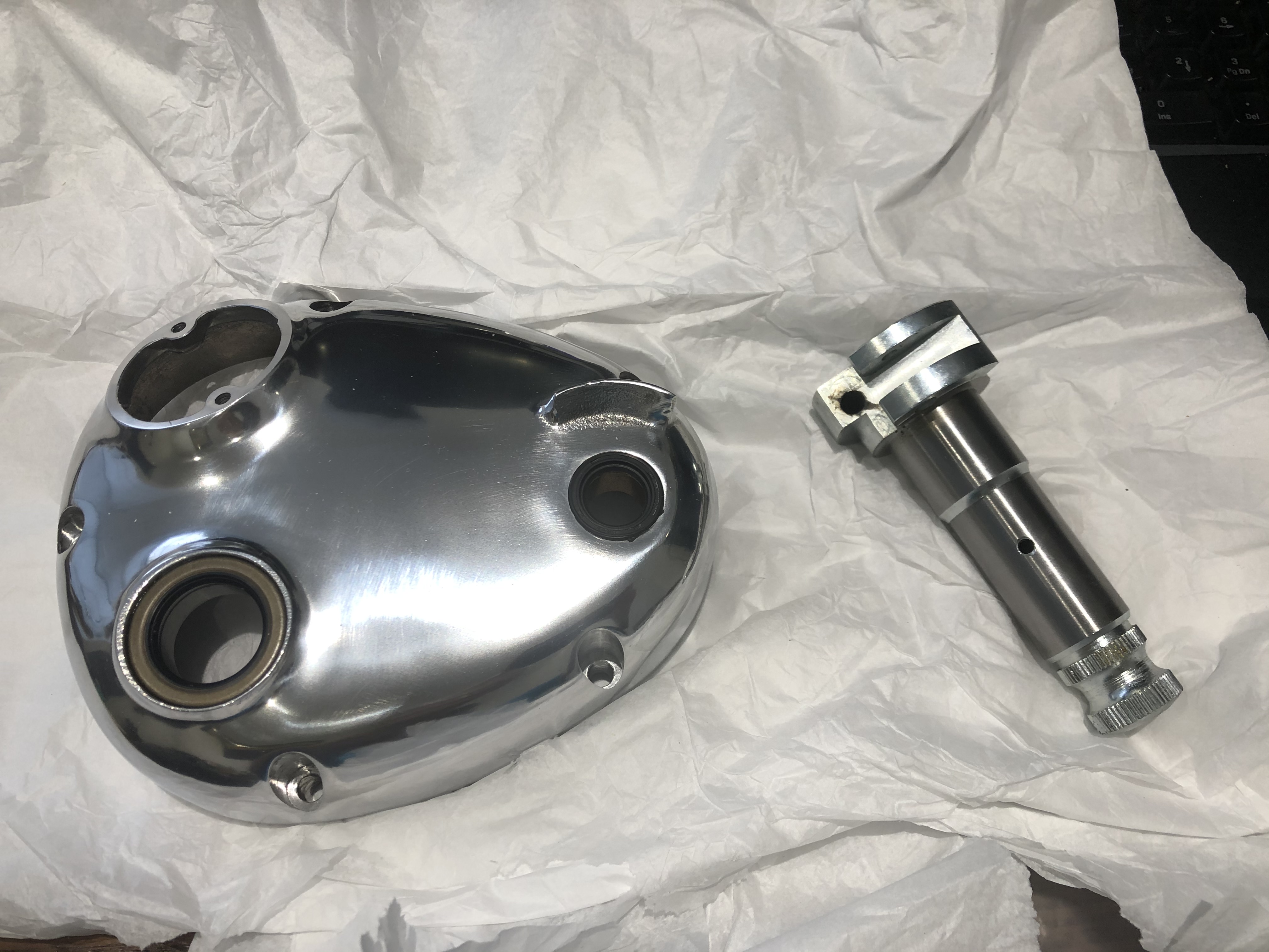

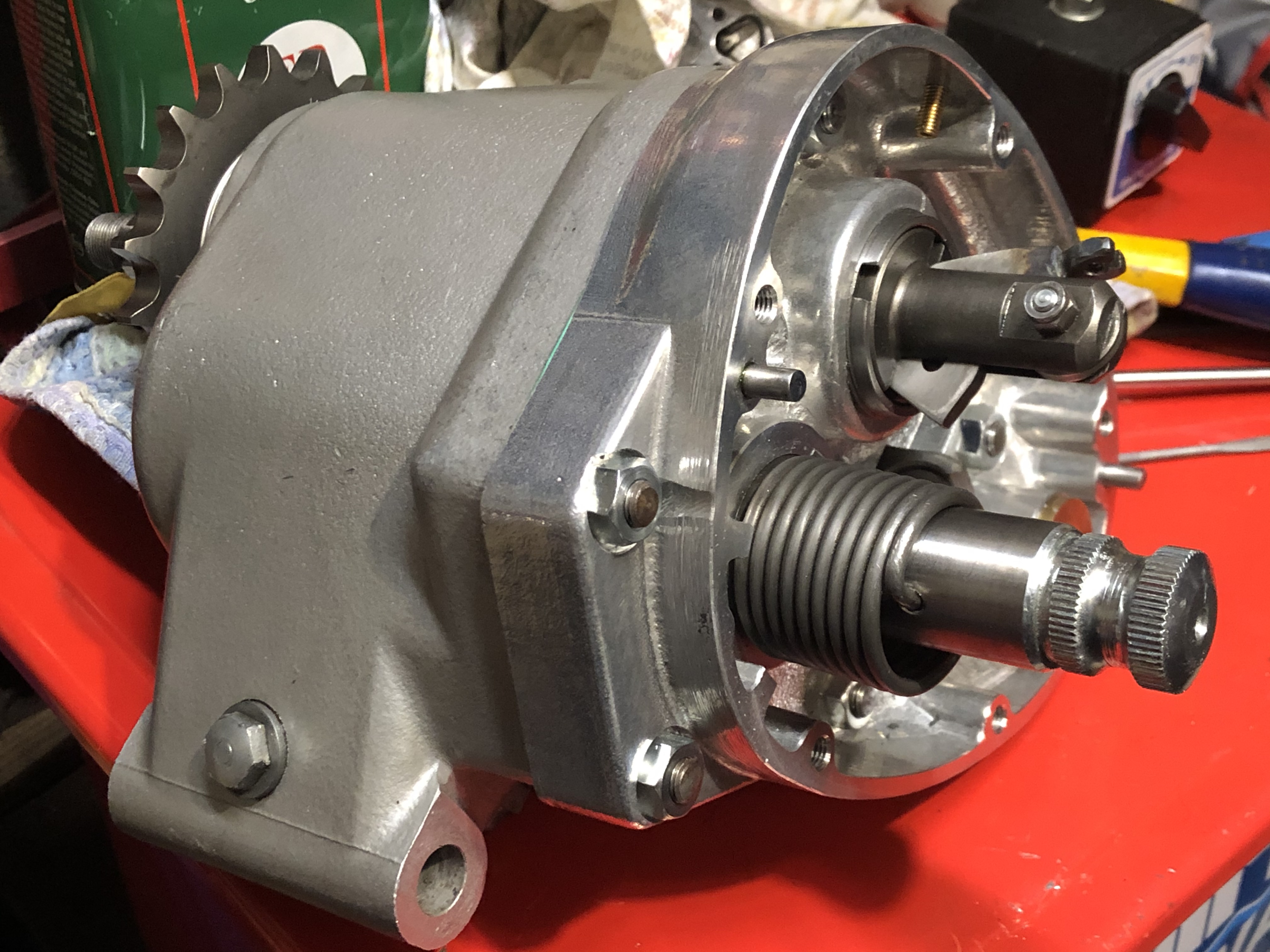

New roller bearing19t gearFinally rebuilt the gearbox. We are really fortunate that there’s so much information available to do this kind of work correctly.
All sorted
Inner box
