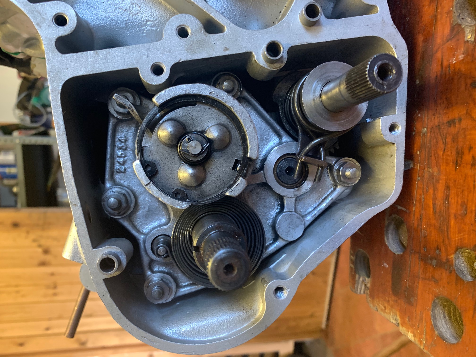

Hi all,
Well it has taken 10 months and the very kind advice, wisdom and help of Peter Holland to solve my new layshaft bush binding problem. All that was required was a cleverly designed but very simple reamer kept in line through the kickstart bush in the outer gearbox cover. 5 minutes of careful, light reaming had the layshaft running smoothly in the new layshaft bush. Half an hour later I had the gearbox back together, running smoothly and selecting all four gears - Huzzzzah!!!! A photo is attached.
A huge, huge thank you to Peter who gives so generously of his time, experience and expertise to fellow Leightweight owners. He personifies everything the Norton Owners club and particularly the Leightwight owners community is all about. If anyone has this layshaft bush problem in the future feel free to contact me and I will provide a more detailed explanation of how to solve it.
Off to the garage to crack on with the Navigator rebuild - fingers crossed I can find the time between work to get it back on the road by Easter!
Nick
