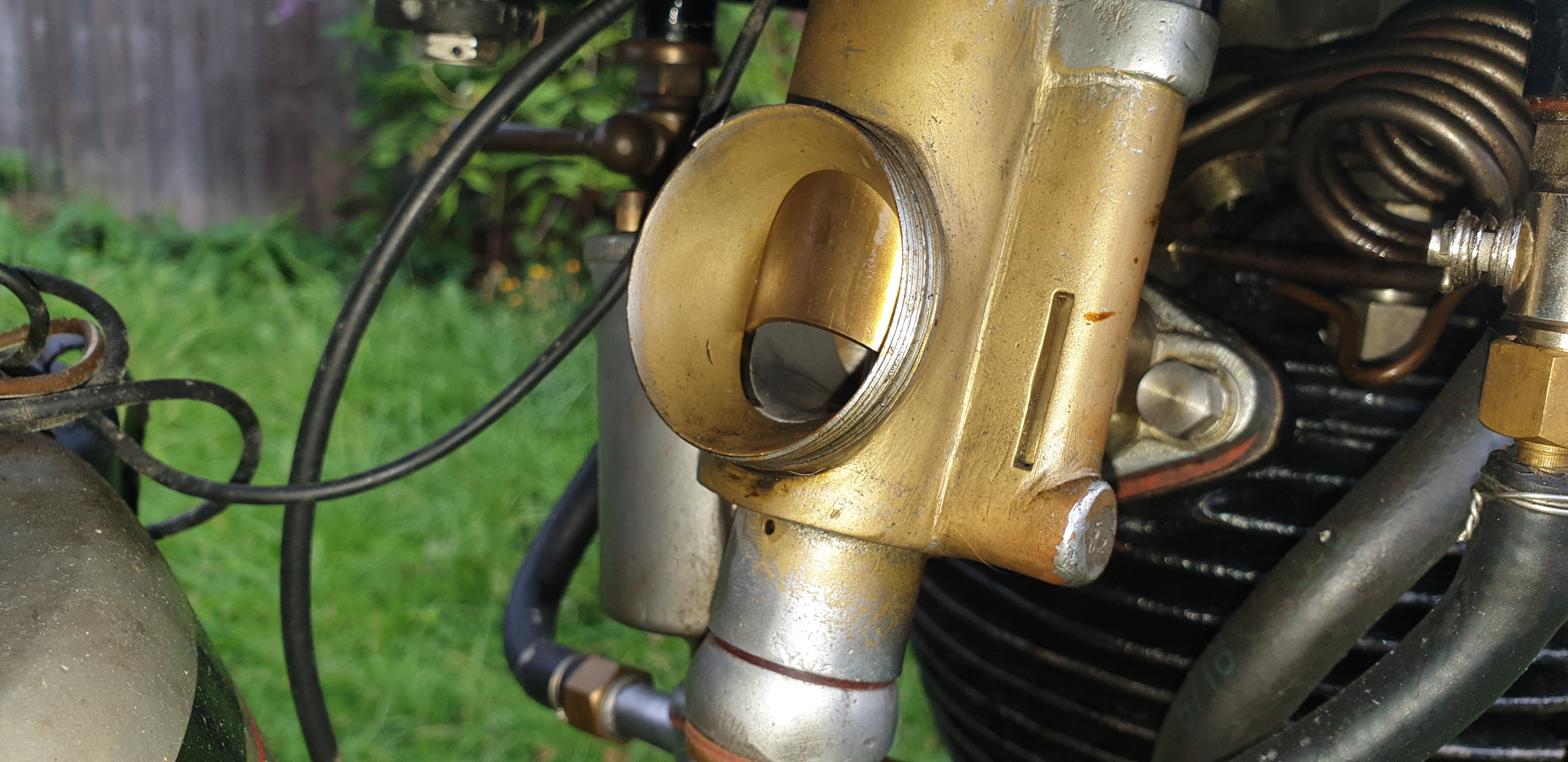

The picture shows the inlet. It has an outside thread, unlike the later ones. This is marked with 1932 date. I don't know if data are published somewhere but I think they changed in 33 or 34 at the latest.
Looks like you have no air lever (or rather  mixture  enrichment  device) . And the air slot blanked off?. Normally  a usefull device on a TT carb ,not a choke , Perhaps this loss of air is compensating for the extra air these old carbs usually get  and contributing to your unusualy good tickover !!. My SSI has the cable hole plugged and the slide removed but the air slot open. I did try blocking the slot but it ran badly.
No...the air slide is there on the right. I close it to start and open it on the road.  If closed it runs very rich.  Incidentally I thought the Dellorto carb (which is near enough a copy of the TT , allegedly) has a tickover adjusted by means of a prong dropping down from the top of the carb and through the slide, and the slide hangs up on it? Or something like that.
