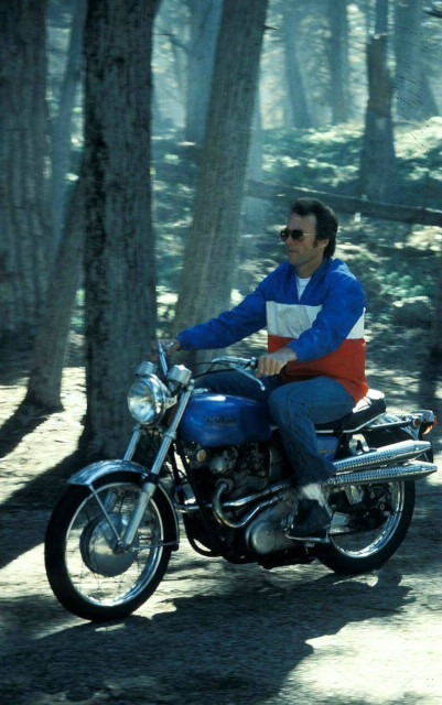

You might find that Interpol spec. works really well for you.
Here's a tall guy on a Roadster (actually S-type):
Thankyou. I'm like a Praying…
Thankyou. I'm like a Praying Mantis on a twig on a Commando with the Roadster set up. My knees feel way too high.
