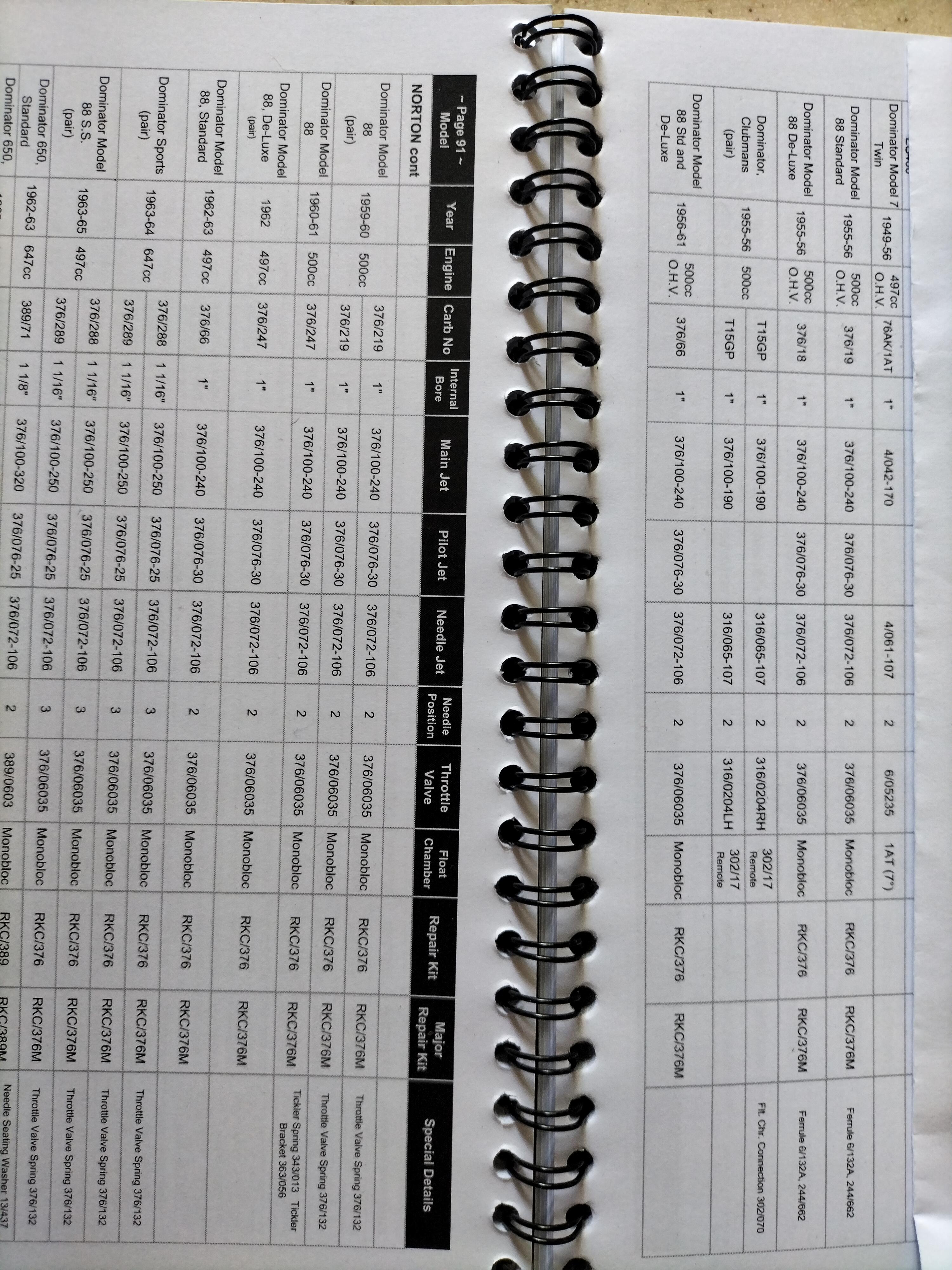

I have a 500 dominator with single carb the one on it is a monobloc 376/18 can anyone tell me if this is correct for this engine please
Online library
Carburettor type
You haven't listed what model and year your machine is.
500 Dominators used several types of carburettor over the model life.
Yours is correct if you have a 1955-56 Dominator Deluxe (first of the wideline Featherbed frames)
See attachment from Amal for the full information.
Thank you for that Ian. That…
Thank you for that Ian. That's exactly what I've got. Problem solved.
